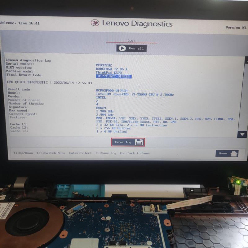

    Hello to all !
    I have in my hands a
    Lenovo Thinkpad E570 ,that turns on ,passes all extended tests (after stress) BUT.
    It hungs up , as soon as i try to install any Windows 10 , install (USB) brand new, different ones, as soon as it loads the (turning cycle) , it crashes and shows.
    ACPI ERROR BIOS
    Tried to reset it , default settings ,tried everything, but everytime shows a different BIOS ERROR.
    So....
    (I have also tried some dumps i found around here on site but to either of those, it doesn't even boot up).
    So ....
    I need a dump for
    E570 REV. 3.0
    I7 7500U + NVIDIA GPU.
    Thanks in advance.

                Really strange behaviour.
                Laptop got stressed again in the extended test, and passed all diagnostics just fine, even 180minutes stress of RAM (Brand new)
                Tried SATA, tried M.2 ,tried New Windows 10 USB stick (which just formated another computer).
                But again the same behaviour occurs.
                Laptop as soon as you try to boot from USB and loads the Windows logo, it freezes and restarts... and then shows ACPI BIOS error.
                What the hell?

                    Because it's really strange in my mind, a stressed tested laptop ,to hang up as soon as you get into the windows 10 , load screen for the format.
                    I even tried an SSD/M.2 with pre-installed windows 10 fresh installed , to boot it from ,just to see if evertyhing will go fine, but again it showed the ACPI BIOS error.
                    Will let you know within the day.
