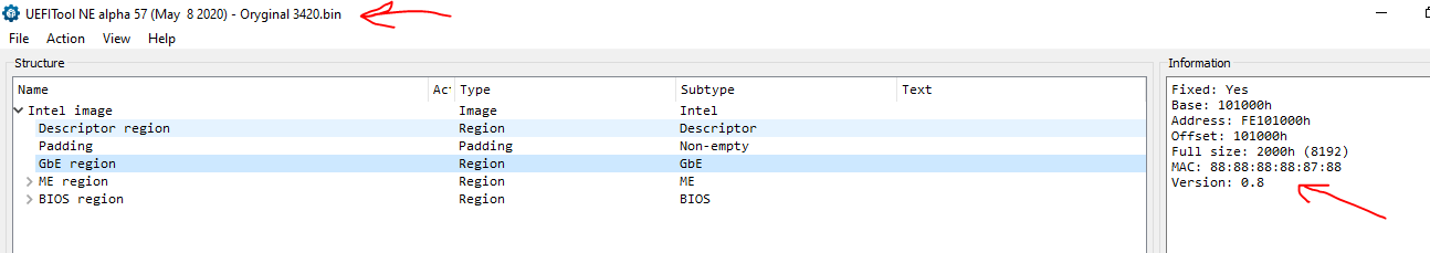

                      I have a problem, my laptop does not turn on and does not display the image in the original bios. I found the bios on this forum. The device is working, but the LAN is not working (code 10) in Windows. Motherboard have i7 CPU. Someone can help me.

                        Re: Latitude 3420 cyborg-l14 mb tgl new lan 213105-1
                        I think the files names are wrong, this "Oryginal 3420" should be the working dump with a LAN Problem, and this "dell 213105-1++" is your Original BIOS. Right?
                        Write your Device Service Tag, in order to create a New BIOS for you.
                          "Oryginal 3420" this is the oryginal Dump, my service Tag 4W6LJG3
                            Here's your New BIOS, try it and give me results.
                            I'm not sure if it will help you with the LAN Problem, because the MAC Address is Wrong. Maybe the LAN wasn't working before.
                              The laptop turns on but still has a code 10 on the LAN card. I think someone previously wanted to repair this laptop and flash the BIOS by flashing the wrong BIOS.
                                I found solution , network card was broken, repleced that and LAN work
