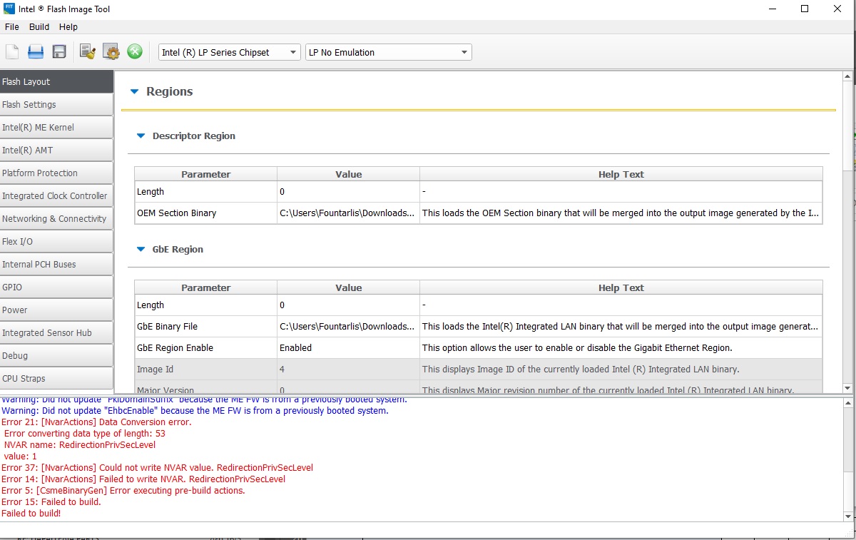

    i have an intel me problem on a 5480 bios.
    I followed the instructions one by one by SMDflea on his post about fixing intel me but i am getting this error (see picture).
    I am uploading the bios dump if anyone can try to fix but i would love to do it my self if anyone can help with what i did wrong there.
    1)Used Me analyzer v1.96 and find my bios has CSME 11.8.50.3426.
    2)Downloaded from the site SMDflea gave on instructions.
    3)Replaced ME Region with the old one.
    Thanks in advance!

    Re: DELL 5480 Intel me
    What problem exactly? Explain what you're trying to achieve?
    The file you've uploaded - is it your factory dump?
      I am having intel me pop up on boot and tried to clear it but failed as you can see in the foto!
      Yes the bios i have uploaded is the factory one.

        • Christakos19
          • Dec 2021
          • 28
          • Greece
          Did you clean my bios or you posted another one already cleaned?
          I am asking cuz i want to understand what i did wrong so i dont make new posts with intel me and fixing them my self!
          I used Me analyzer v1.96 and find my bios has CSME 11.8.50.3426.
          You posted with v11.8.82.3838 Clean ME.
          Was that the error i had?
            Yes of course, that's why I asked if it's your factory dump
            I don't know what you did wrong and I don't have time to investigate why you have a problems with the Flash Image Tool - I didn't have any.
            You should update your Me analyzer tool, 1.96 is old version.
            Your bios is 1.19.2, and this version uses 11.8.82.3838 of ME, ME version in the dump you've uploaded is indeed 11.8.50.3426, which means that someone somehow made a mistake when the BIOS was been updated to this version, or something else went wrong.
            No.

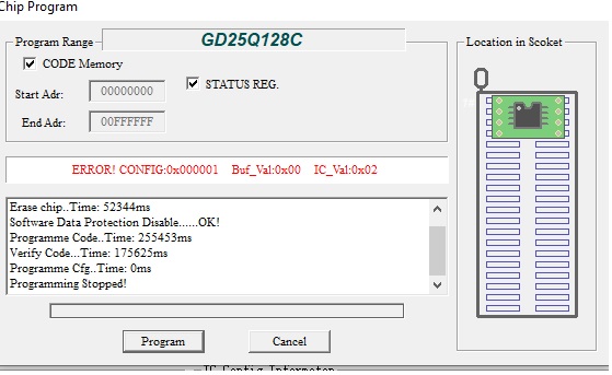

            • Christakos19
              • Dec 2021
              • 28
              • Greece
              For some reason i am getting this error message when trying to program it with both your bios or the original one.....
              I didnt change any config on the MiniPro i am using.
              Used this configuration when read it to uploaded here...!
              Any help?
                Any help?
                Try with new SPI CHIP
                  • 20518
                  Any help?
                  That error is sometimes caused by the chip not lining up properly with the adapter pins.One of the adapters i have for my TL866CS is worn out,it has to be pulled up slightly at both sides with one hand,while reading and writing to the chip.I should buy a new adapter but i`m too cheap
                  • Vesko356
                    VIP Moderator
                    • Aug 2018
                    • 4386
                    • Bulgaria 🇧🇬
                    Select the chip manually according to the markings of the chip.
                    Clean the chip with alcohol to ensure good contact between the programmer and the chip.
                    Before reprogramming, the contents of the chip must be erased.
                    Edit: Before reprogramming, make sure you have saved the (verified) factory dump in a safe location.
                    Take two or even three readings of the chip and compare the content.

                    • Christakos19
                      • Dec 2021
                      • 28
                      • Greece
                      Y did all that and programmed completed.
                      The problem is that i am getting the following error:
                      Error sending end of post message to ME:HECI disabled, procceding with boot!
