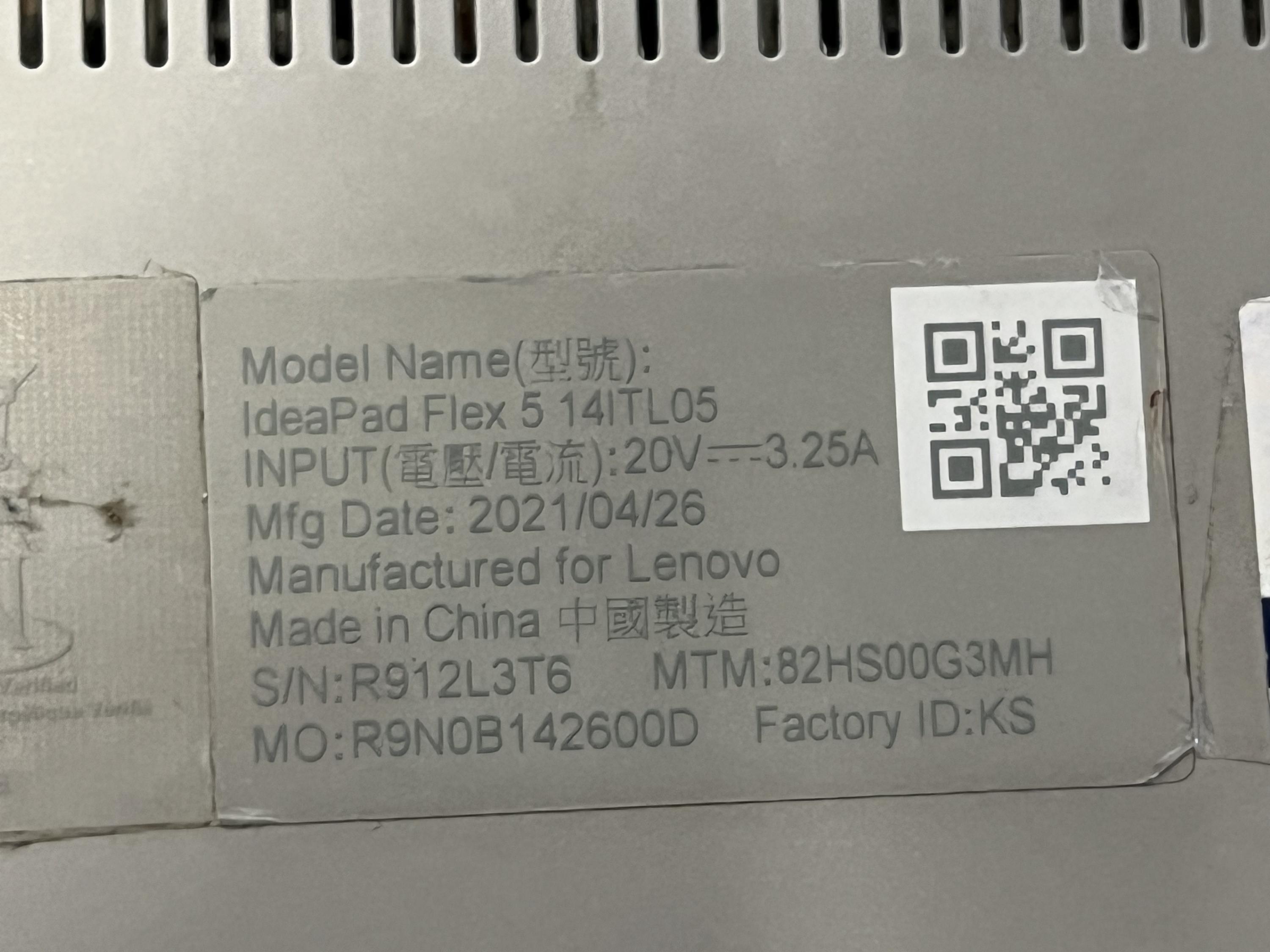

    I'm working on a laptop (i think) with a corrupted bios.
    I installed a new file (from vinafix) with the programmer, but now i can't set the SN and the MTM.
    Before i installed the new bios file, the laptop didn't power on at all. Now it power on, but doesn't recognize the ssd nvme. And i can't start XClarity Provisioning Manager to edit the SN and MTM (model).
    Anyone know if a can do it with an Hex editor?

    Re: Lenovo IdeaPad Flex 5 14ITL05 didn't turn on / need help to setup SN and MTM
    Post original corrupt bios
      Already solved.
      Thank's for your reply.
        could you post working bios here ?
          Here you have it.
            Originally posted by GfilipeZ
            Here you have it.
            Thank you, i already merge corrupted bios & build from lenovo update
            Here's working bios, tested by me
