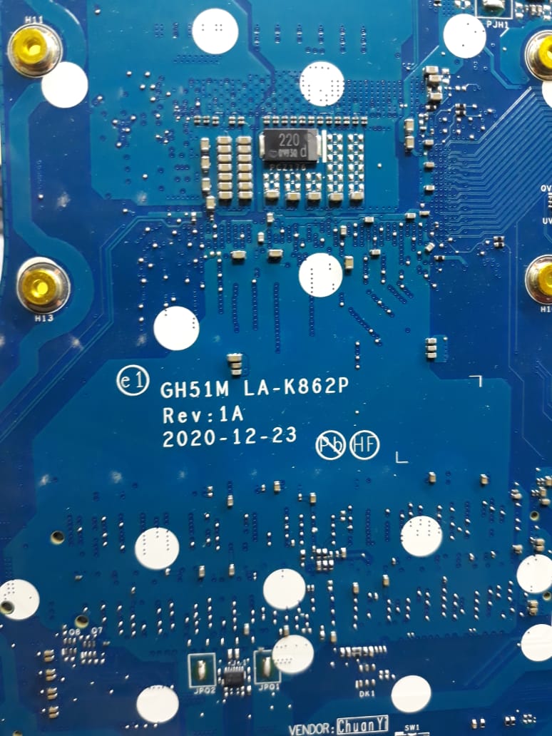

Predator Helios 300 LA-K862P bios need
  • douha
    • Sep 2014
    • 44
    • maroc
    Predator Helios 300
    PH315_53_75ET
    Mainboard GH51m la-k862
    Please help to find bios for this predator
    https://www.badcaps.net/forum/attach...1&d=1649971908

    Re: Predator Helios 300 bios need
    Upload your original bios
      The broken bios
        Originally posted by douha
        The broken bios
        New bios

            Re: Predator Helios 300 LA-K862P bios need
            Hello freind this dump not work if somone have a rested dump pleas help
            • hoaca388
              Badcaps
              • Jan 2022
              • 11640
              Here is a clean file from Acer homepage, I just added some DMI info, I think you have another problem with your mainboard.

                            Hello everyone.
                            I had to replace the PCH on this computer because it had an internal short circuit.
                            Can someone clear the PCH BIOS for me?
                            ACER PREDATOR HELIOS 300
                            GH51M LA-K862P Rev: 1A
                            PH315-53-72T7
                            S/N NHQAUEB0011080A4793400
                            Thank you very much.

                              Originally posted by PhonesLab
                              Hello everyone.
                              PH315-53-72T7
                              I was able to copy the EC/KBC. I'm attaching it in case it needs cleaning/modifying. It's KB909022Q.
                              Currently, the device charges the battery, but when it's turned on, the blue LED flashes, activating the 3V3ALWS, 1V8, and 1V05 sources (in addition to the 5V and 3VLP sources already on S5). However, after 8 seconds, it shuts off and remains on S5 again.
                              The EC sends the BTN_ON signal to the PCH, but I don't see the PCH outputting the S4 and S3 signals.
                              Thanks for everything.
                                Hello everyone.
                                PH315-53-72T7
                                you bios with clear ME 14.0.37.1165
