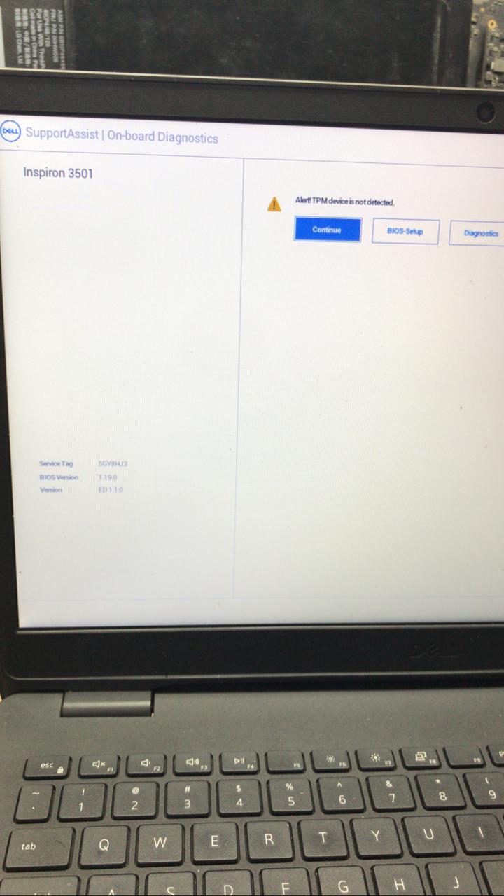

need help dell Inspiron 3501 gen 11 LA-K034P

    SOLUATION for tpm nodected?
    Inspiron 3501
    Service Tag: 5GY8HJ3

        Re: need help dell 3501 gen 11 LA-K034P
        TPM is dead
          Originally posted by hoaca388
          TPM is dead
          try downgrading to a much older bios version
            Solution worth trying.
            Dell Inspiron 3501 oldest version.
                          Has anyone solved the TPM dell 3501 gen 11 error yet?
                              could you help me it has a tpm error and it has no audio
                                  Downgrade the bios to an older version
                                    I already did it and it didn't work, still without audio and with the tpm error
