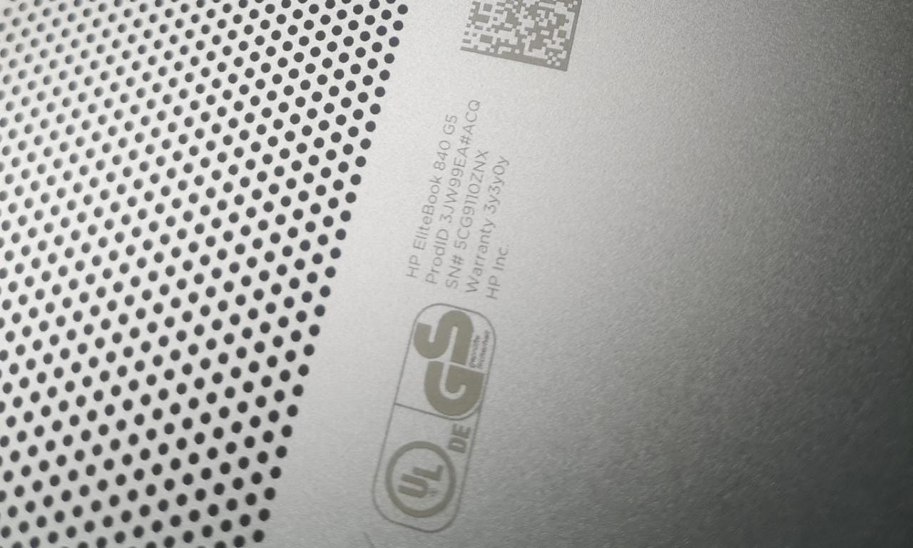

            Re: HP 840 G5 Elitebook NO DISPLAY
            Originally posted by D'Bryte
            There you go...
            I've re-program the bins now is just blinking Orange.
            With the Original bins it blinks White for a few seconds then stops and show steady orange charging light, then after it will allow you to switch it ON but with no display.
            Boardnumber COMPUTRO-6050A2945601-MB-A01(A1)
            Laptop Details: Check the attachment

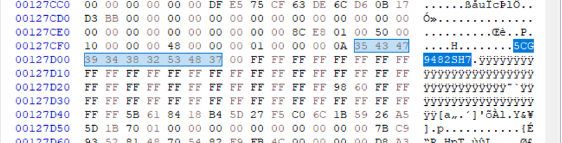

            • hoaca388
              Badcaps
              • Jan 2022
              • 12268
              @Justice 171 : Is that your original bios? I found a serial number, it shows that this is a G6 series bios.
                When I get the machine I just removed the IC's and read them the BINS, according to the client they said they SOUND WAS NOT WORKING SO THEY UPDATED THE BIOS and the machine was Bricked.
                So no solutions? is it good as DEAD??
                • hoaca388
                  Badcaps
                  • Jan 2022
                  • 12268
                  Find other bios on forums.
