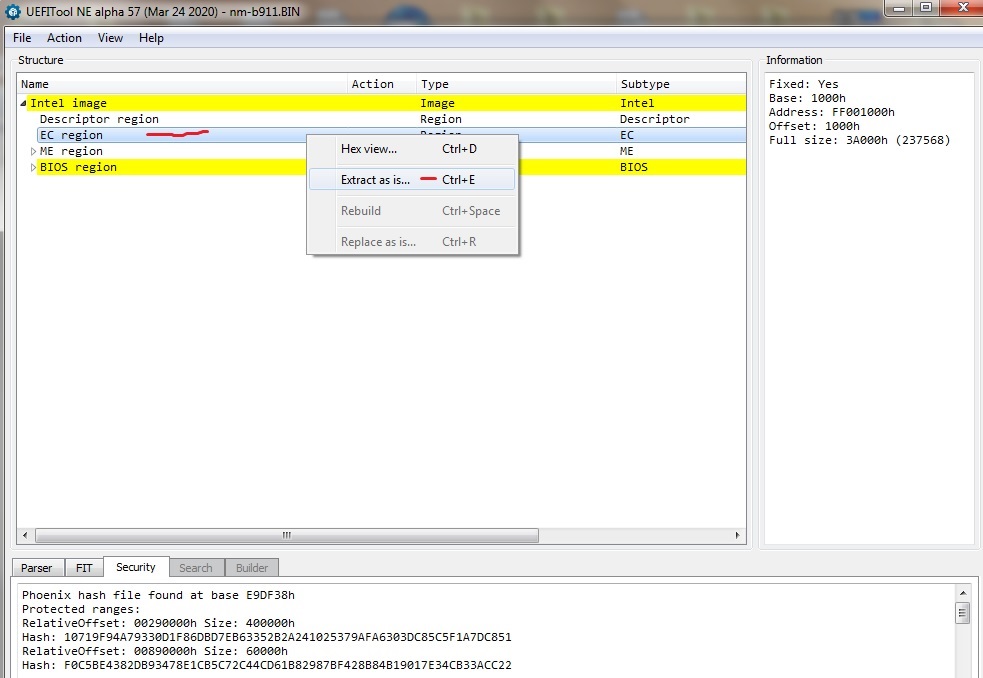

        • 21013
        Re: Need NM-B911 Lenovo e490 kbc dump
        Originally posted by bilen
        thank you
        @bilen ,you can extract the EC from your bios backup using UEFITool ,right click on EC Region and select Extract as-is
          Originally posted by peste
          try this .. make a copy of the EC bios if you can extract it ..
          not working...
