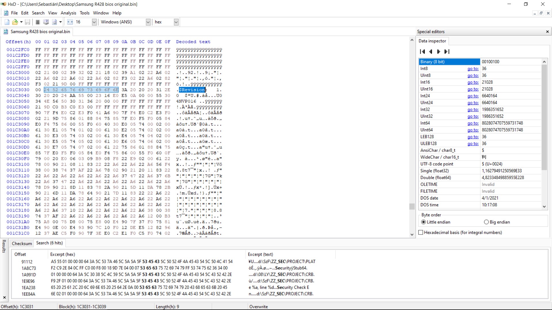

      Thank you, I did find a $revision entry in the old bios, but I can´t seem to discern what is the platform ID, is the last 2 or 3 numbers?
      See attached image and here is the number after $revision:
      U04NVP016
      Thanks again for any help. Cheers.

        post your backup

            bios version 08NV .NV is the platform ID

              Perfect! Thank you very much. I did try NVP, I was sooooo close...
