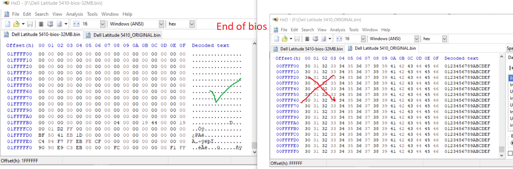

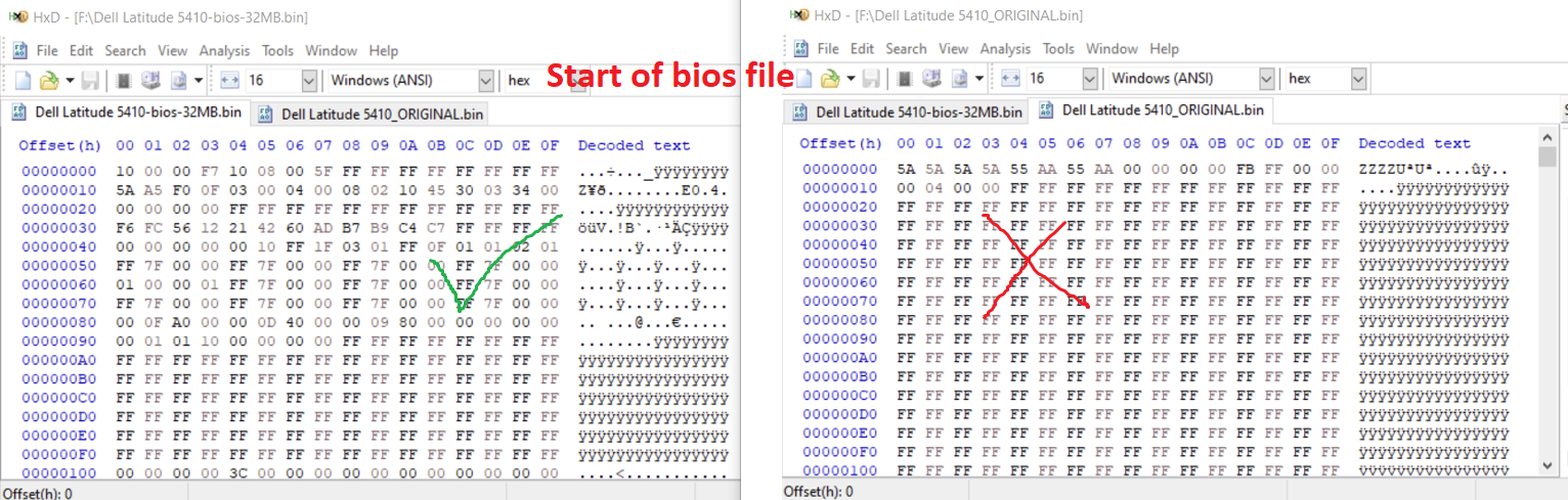

                Re: Dell Latitude 5400 Bios password
                Need clean dump for latitude 5410 or somebody help me unlock ,
                Attached original Dump
                • hoaca388
                  • Jan 2022
                  • 11140
                  • Viet Nam
                  Originally posted by huss584
                  Need clean dump for latitude 5400 or somebody help me unlock ,
                  Read bios again, file is corrupt.
                  Become a Badcaps supporter
                  Thanks to all supporters.
                  • huss584
                    Hussein
                    • Apr 2020
                    • 225
                    • Palestine

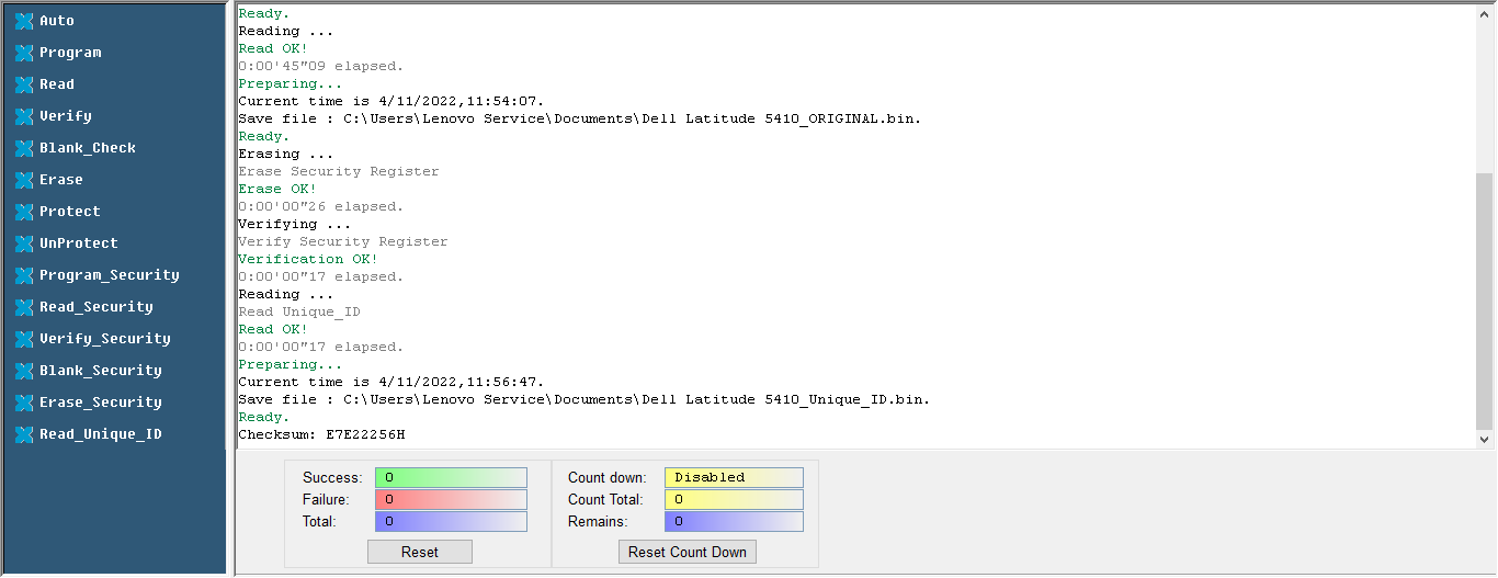

                    • huss584
                      Hussein
                      • Apr 2020
                      • 225
                      • Palestine
                      i read BIOS from another Programmer
                      can i use Erase security button
                      • hoaca388
                        • Jan 2022
                        • 11140
                        • Viet Nam
                        Still not good

                        • huss584
                          Hussein
                          • Apr 2020
                          • 225
                          • Palestine
                          Still not good
                          The BIOS Chip 25Q128xxx , not 25Q256xxx
                          • hoaca388
                            • Jan 2022
                            • 11140
                            • Viet Nam
                            I think the problem is the programmer, whether it is 32MB or 16MB bios chip, the structure is similar. Your file can't even open it with the uefi tool so it's definitely a problem.
