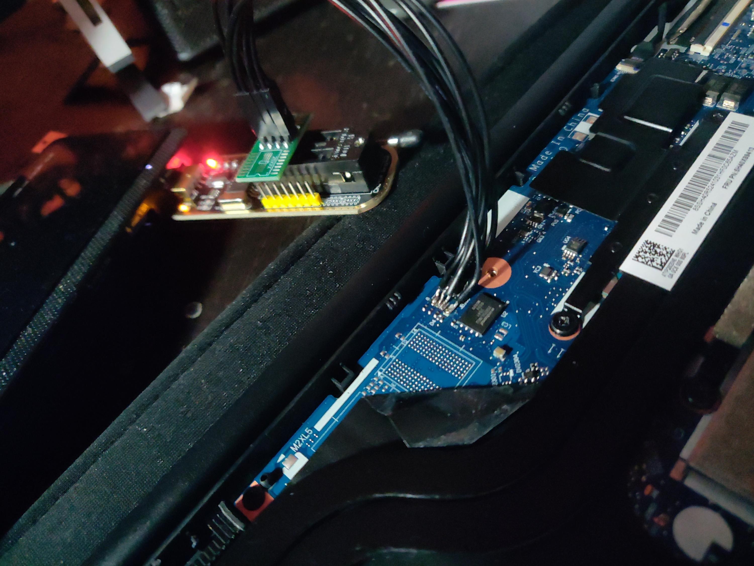

    Trying to remove the admin password on this Lenovo E14 Gen2.
    Flash chip: Winbond 25Q256JVEQ - extracted with a CH341A reader/writer. Detected memory type: 4019 (33554432 bytes)
    I do wonder if anyone can give some pointer. What is the method one go about to patch a typical locked bios file? Where to start?
    So far I haven't found much information on these laptops. I suspect they're quite fresh on the market. At least the Gen2. (Gen1 has a different motherboard and a slightly different flash chip)
    The lenovo_autopatcher did not work.
    Gave: "dump.bin is corrupted or does not contain a valid dump." after the second stage. [2/2] ...

    Need a dump of Lenovo Thinkpad E14 Gen2 firmware.
    Any owners of Lenovo Thinkpad E14 Gen2 machines out there with settings at factory default and unlocked:
    I want to request two dumps from your machine if you're capable of dumping the firmware from the Winbond 25R256JVEQ flash chip near the screen hinge side.
    One dump with all factory settings.
    Another dump with an administrator password set.
    (Just the first one with factory settings will do nicely too if you don't want to risk it any further. But both will help immensely.)

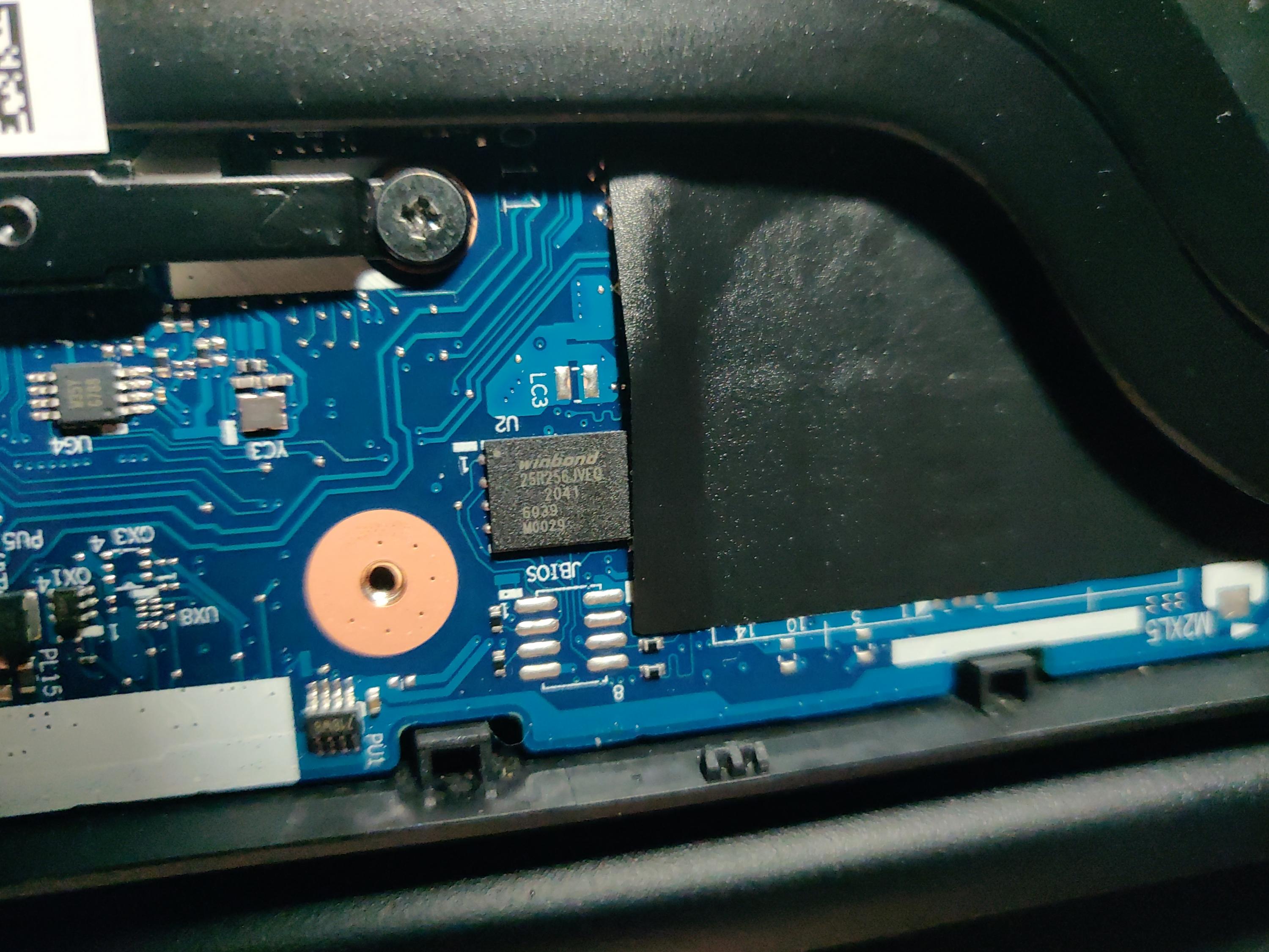

    The neat thing about it is that one doesn't need to desolder the chip to dump it.
    One can simply solder a few wires to the 8 solder pads for a SOC8 that's unpopulated just adjacent. (It's a pin to pin exact match footprint so Lenovo can use either the SOC8, or the WSON8 package)
    It works the other way around too if the SOC 8 footprint is populated instead. The pads are directly 1 to 1 electrically connected. pin 1 to pin 1, pin 2 to pin 2 and so on. One can probably 3D-print a jig for it to touch wires onto the pads too in order to avoid soldering, if one so desire.
    I'll attach pictures to show you how it can be done. It is how I dumped a locked firmware. I used a CH341A flash reader/writer for this. Works like a treat.

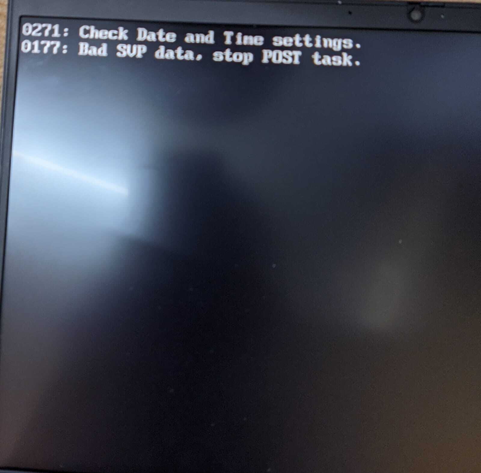

                      help me please, Bad SVP Data, Stop Post Task
