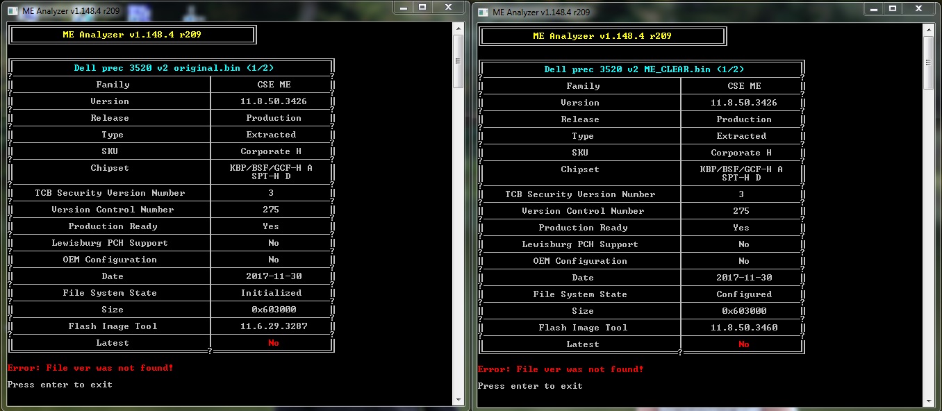

    Hi all!
    I would like to request a working bios dump.
    Service Tag: 2xcg4m2
    I can also upload the original dump.
    I did the ME regio cleaning, but it does not turn on the laptop. Turn on, then off after 2sec. Not posted, not responding caps lock.
    Thank you!

    This is printscreen, after me cleaning.

      Re: Dell Precision 3520 i5-7440HQ CPU
      post the bios backup, not the bios you cleaned
        This is
        Thank you!
          This is
          Thank you!
          try..
            Originally posted by peste
            try..
            Thank you it's working!
