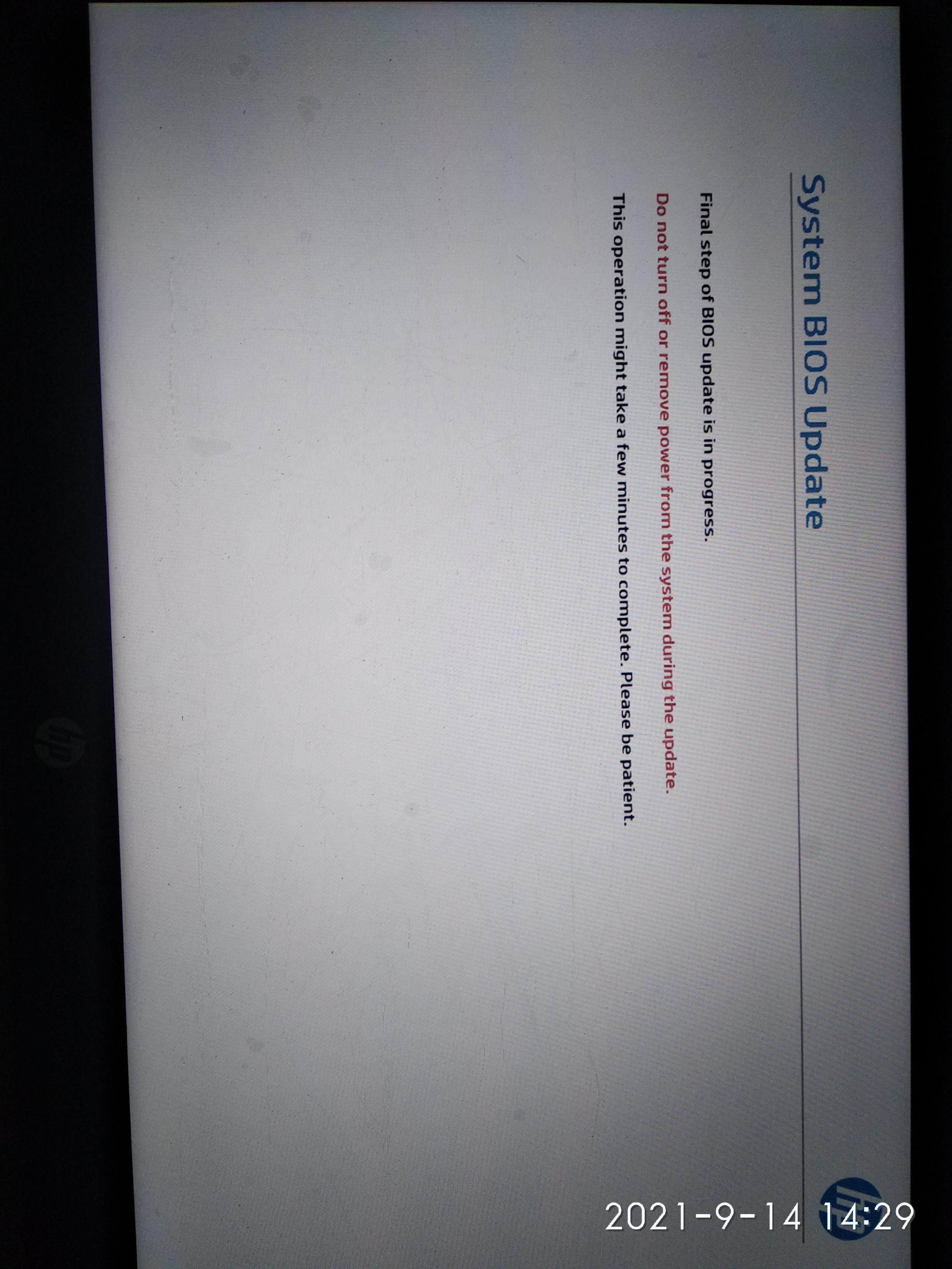

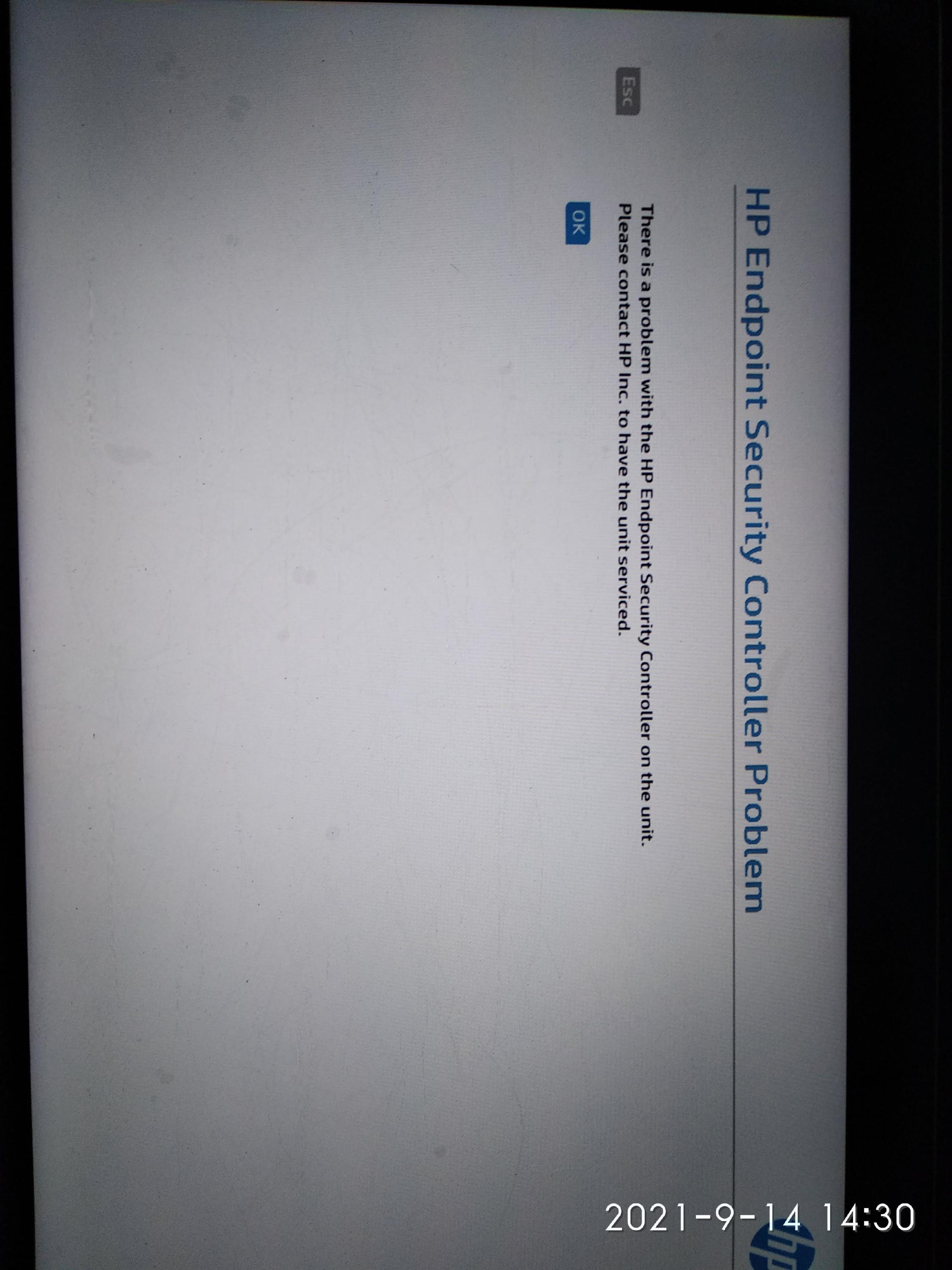

                                        Re: hp 450 g7
                                        Originally posted by Vesko356 View Post
                                        Yes, I "already removed" this from the dump, because it needs to be done if you want the bios password to be cleared, so as I said just write back the edited file to the chip. Or if you know better way to do it, fill free to use it.
                                        Tried with that file ("450-G7-BackupBiosLocked-2021-09-12-03 NEW.zip").
                                        But the following errors showing.
                                          #40
                                          Re: hp 450 g7
                                          Log into bios, and reset security setting to default.
