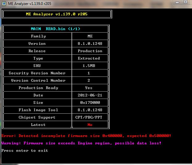

    Does anyone has advanced bios bin for
    qwv1 la-7912p rev : 2.0
    Acer travelmate P253-E
    Notebook automatically restarts after 30min
    On the internet everybody says that CPU incompatible...
    Chipset it's HM77 - CPU i3-3110M
    I see it on compatible list
    https://ark.intel.com/content/www/us...s-chipset.html
    Thanks!

        Did you check PCH sSpec on the PCH itself? Lots of these boards came with HM70 only.
          • 22276
          Re: Acer Travelmate P253-E Advanced BIOS
          The bios has corrupt ME FW .

                    In this case yes.As piernov pointed out though a lot of these boards came with the HM70 chipset.Yours is HM77

                          seems to work with ME CLEAN ... computer doesn't restart after 30min ...
                          this solve the problem?
                          just curious,did you use me_cleaner?
