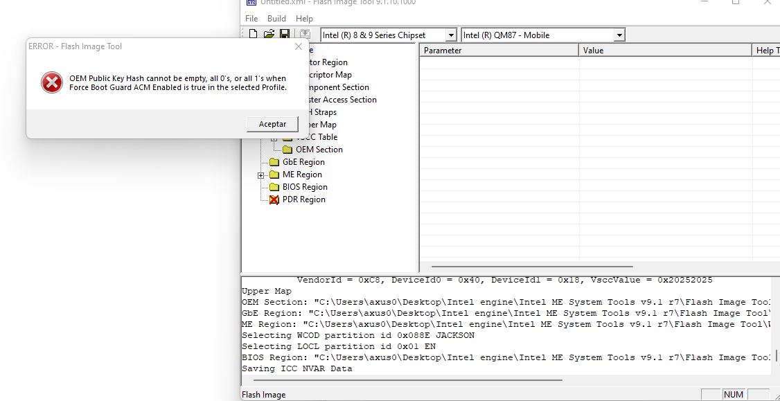

                            #33
                            HP Probook 650 G1 Clean ME Firmware
                            Hello friends, can someone help me clean ME Firmware this bios, thank you very much.
                            Model: HP Probook 650 G1
                            S/N: 5CG551294Z
                            I attach my original bios.

                                  #36
                                  Re: Hp probook 650 g1
                                  S/N: 5CG551294Z
                                  Originally posted by SMDFlea
                                  You MUST:
                                  BIOS guides, methods, resources and tools
                                  https://www.badcaps.net/forum/showthread.php?t=103526
                                  3. Password removal by laptop brand
                                  3.6. HP
                                  I'm trying to clean the bios, but I get this error when creating the image, does anyone know what it is, it's clearly because there are 0's in the boot guard configuration, but does anyone know how to fix it, it's the first clean I'm trying to do , thanks for your help.

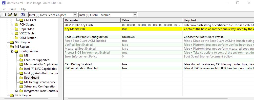

                                    #37
                                    Hello try this file ...
                                    I think the error comes from the wrong FIT version.
                                    You are using 9.1 but it should be 9.0
                                    Good luck ....

                                      #38
                                      Good luck ....
                                      Thanks friend, I just found that the problem was that I was not modifying the "Boot Guard Profile 0 - No_FVME" setting, I already corrected it, I will try to reprogram with my output image and if it doesn't work I will try the one you sent me, I thank you so much.
