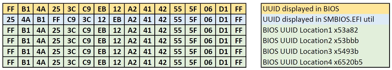

                    • desmobob
                      • Feb 2021
                      • 2
                      Re: HP Elitebook 850 G2 MPM Unlock Help
                      I have a very similar issue after purchasing a new replacement motherboard (along with subsequent EC and Main BIOS chips).
                      I stupidly committed early and now have the "warning machine is not in committed state", along with random extended boot/reboot times, fan speeds and certain sensor reading failures (temp, fan speed etc).
                      I've attempted to modify the "F" x 16 UUID FSMC.bin->SMC.bin by inserting my own UUID in, but obviously the SMC Blob isn't that simple.
                      I've attempted to locate the meaning of the 1 x 5 digits and 4 x 4 digits at the end of the FSMC.bin file, but so far it eludes me. I think it has something to do with the offsets of the Main BIOS location the UUID is stored in.
                      The UUID is stored in four locations within the Main BIOS, however the BIOS System Information screen displays the first half of the 16 character UUID differently than it is stored in the BIOS, or even retrieved when using SMBIOS.EFI.
                      BIOS UUID Location1 x53a82
                      BIOS UUID Location2 x53bbb
                      BIOS UUID Location3 x5493b
                      BIOS UUID Location4 x6520b5
                      I think my only fix is to get the UUID changed to F x 16, then I can reconfigure everything via wndmifit after using the FSMC.bin->SMC.bin route.
                      It would be good if I could find a means to change the BIOS bin without breaking out the CH341A programmer, but it seems the encryption mechanism used prevents building the data section easily.
