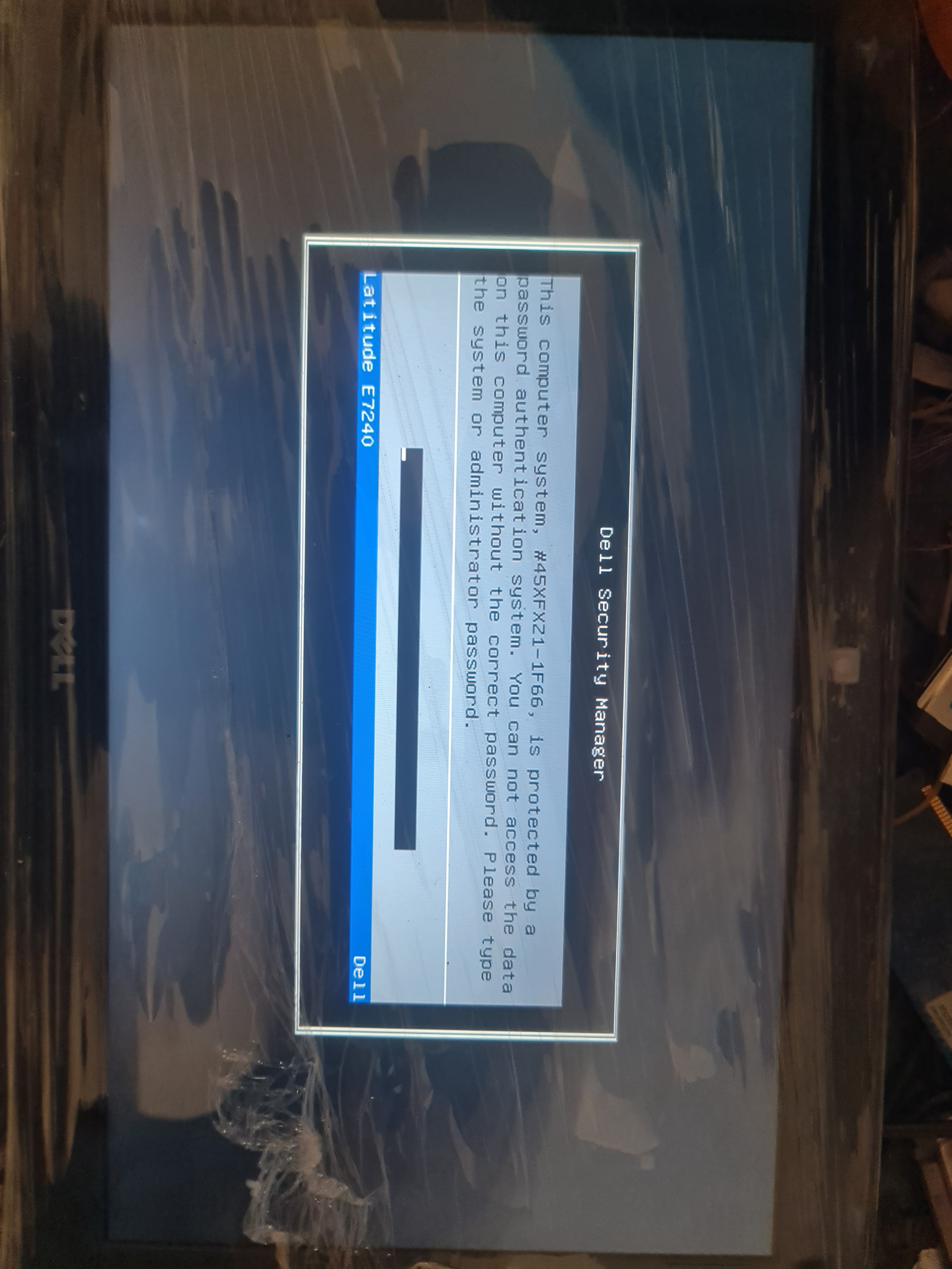

                      i have the same laptop Dell E7240 but it comes with U1 8mb Only can anyone help me with the bios bin that can display?
                      • peste
                        • Dec 2016
                        • 13721
                        • ROMANIA
                        post S/T, full name and model, motherboard model, etc.
                        post the contents of the bios chip even if it is corrupted..
                        • Hayatuddeen
                          • Mar 2024
                          • 11
                          • Nigeria
                          Dell laptop VAZ50 LA-9431P REV 1.0(A00) 2013-09-11
                        • Hayatuddeen
                          • Mar 2024
                          • 11
                          • Nigeria
                          Hello pls can anyone help me with bios bin for the dell latitude the screen shot and bin back-up attached, the issue is the password.
                          • Hayatuddeen
                            • Mar 2024
                            • 11
                            • Nigeria
                            it comes with single bios chip 8MB
                            • hoaca388
                              Badcaps
                              • Jan 2022
                              • 12396
                              Service tag number ? Please , writedown.
                              • Hayatuddeen
                                • Mar 2024
                                • 11
                                • Nigeria
                                45XFX21
                                  • 22084
                                  45XFX21
                                  Read the dell password topic, you can unlock it yourself if you have a US qwerty USB keyboard https://www.badcaps.net/forum/troubl...23#post1622423
                                  • Hayatuddeen
                                    • Mar 2024
                                    • 11
                                    • Nigeria
                                    i try my best but couldn't remove it.
