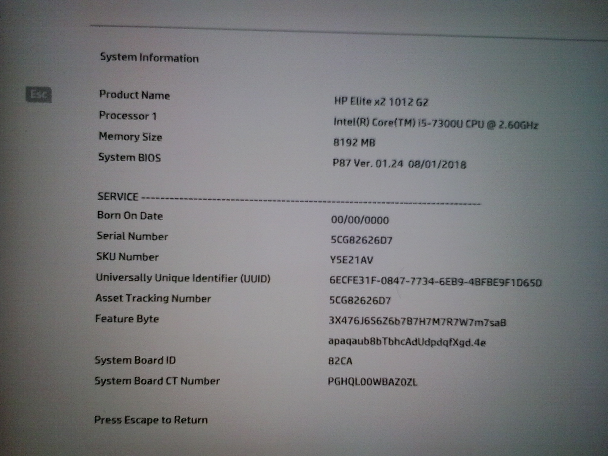

    A friend of mine gave me an HP Elite X2 1012 G2 with locked bios to install operating system, which he bought from an auction.
    Now i have tried many things which includes removing NVME SSD and trying to install windows 10 from another HP Laptop but it failed for no apparent reason,
    Now i have disassembled the tablet and by using CH341A programmer and soldering wires to spi chip, i have extracted bios dump.
    Can any one help me unlock this tablet.
    I have uploaded Bios Dump aswell as Serial No & UUID.

    Re: HP Elite X2 1012 G2 Bios Required
    this
      Thankyou very much for your prompt response, i have tested the bios file, and its working fine, once again thanks.
