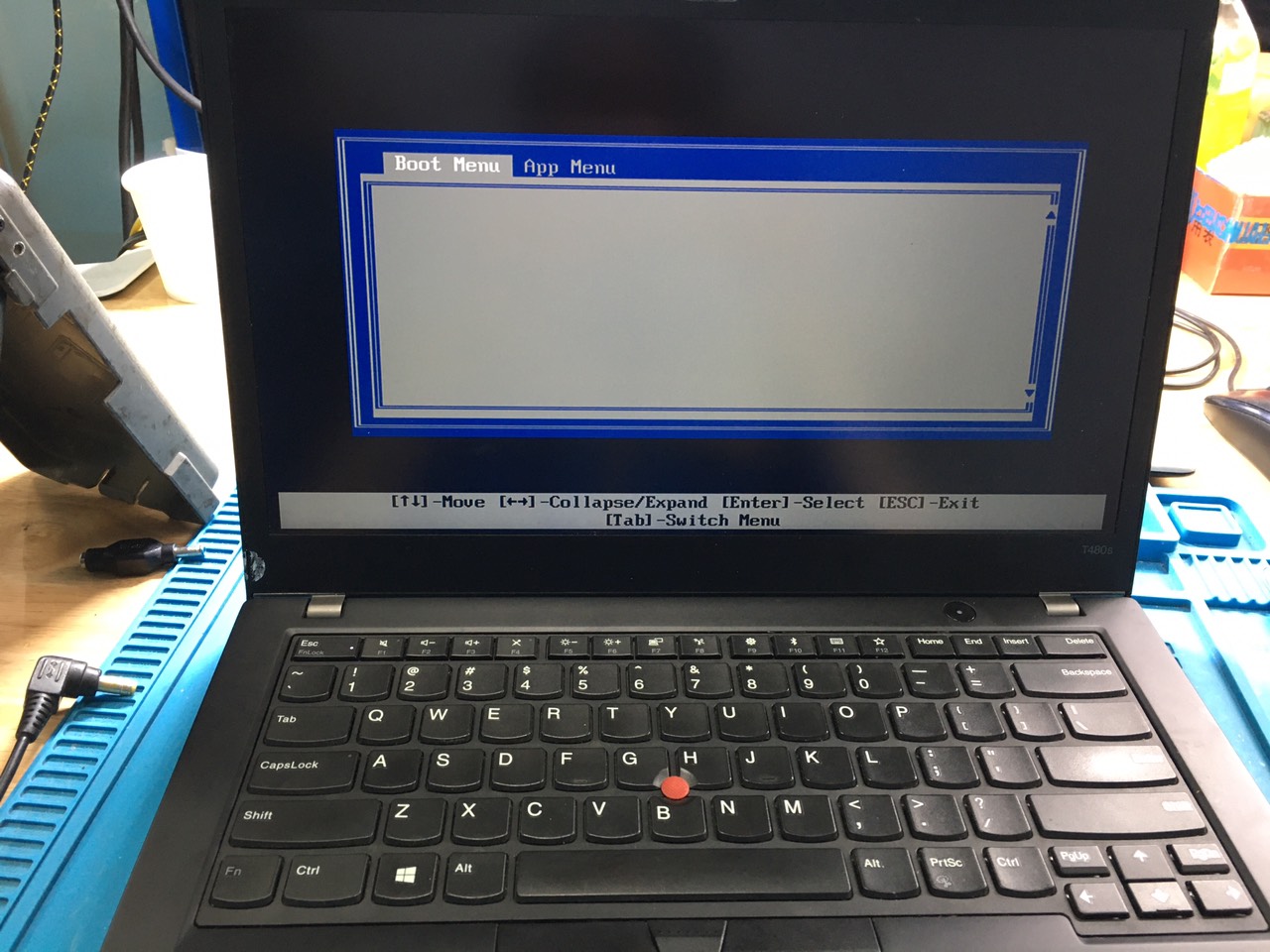

          i loaded the bios which showed lcd but didn't recognize the nvme hard drive. Repaired machine lost original bios.
          i have loaded many bios but not recognized nvme drive. Is the cause due to bios?

            post the full name and model of the laptop, and (type)

              model laptop: t480s . Type:20L8-S0K200

                try this..

                  The machine didn't turn on at first, checked the circuit was broken after reconnecting and loading the bios, Laptopdid not recognize the hard drive.
                  I loaded your bios and still don't recognize the nvme drive. source drive enough 3.3v, i think the ability to cpu error.
                  thank you very much!
