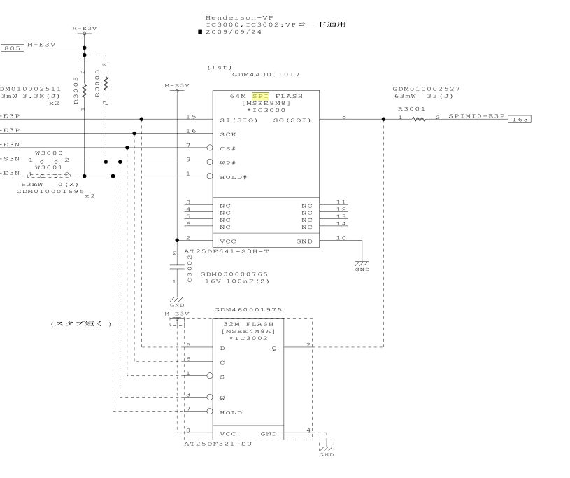

    i need some fotos of toshiba TECRA S11-106
    exactly of bios chip position
    PART NO . PTSE3E-OLKOCMFR
    • 21917
    Re: TECRA S11 fotos
    The bios chip is an Atmel AT25DF641, cFeon EN25Q64 or Winbond W25Q64FV
    Flash chips in VSCC table:
    1F4800 (Atmel AT25DF641)
    1C3017 (EON EN25Q64)
    EF4017 (Winbond W25Q64)
