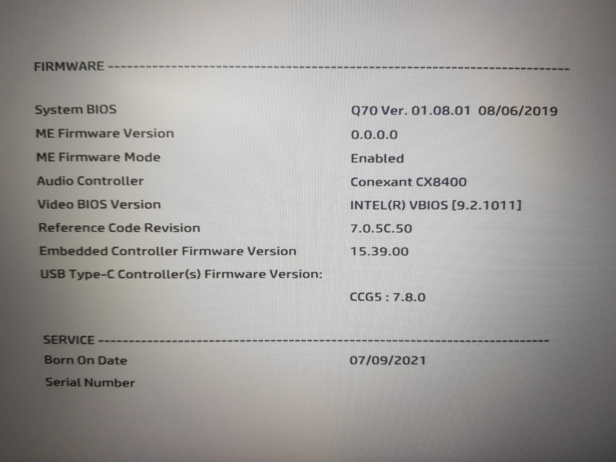

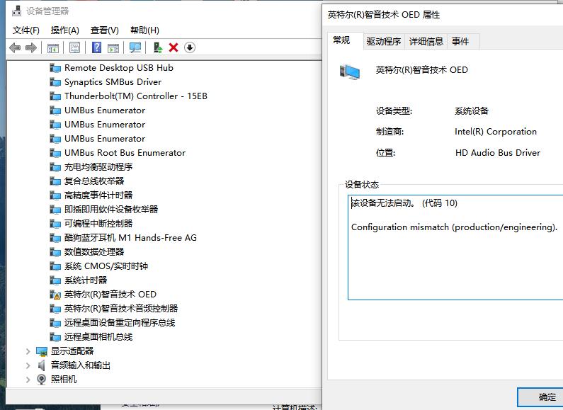

    This is some photos of my computer's failure, I hope to provide you with useful information.
    I hope that my ME firmware can be synchronized to the official website, and I hope that my intel oed works normally, and the sound card sounds normally, thank you very much.

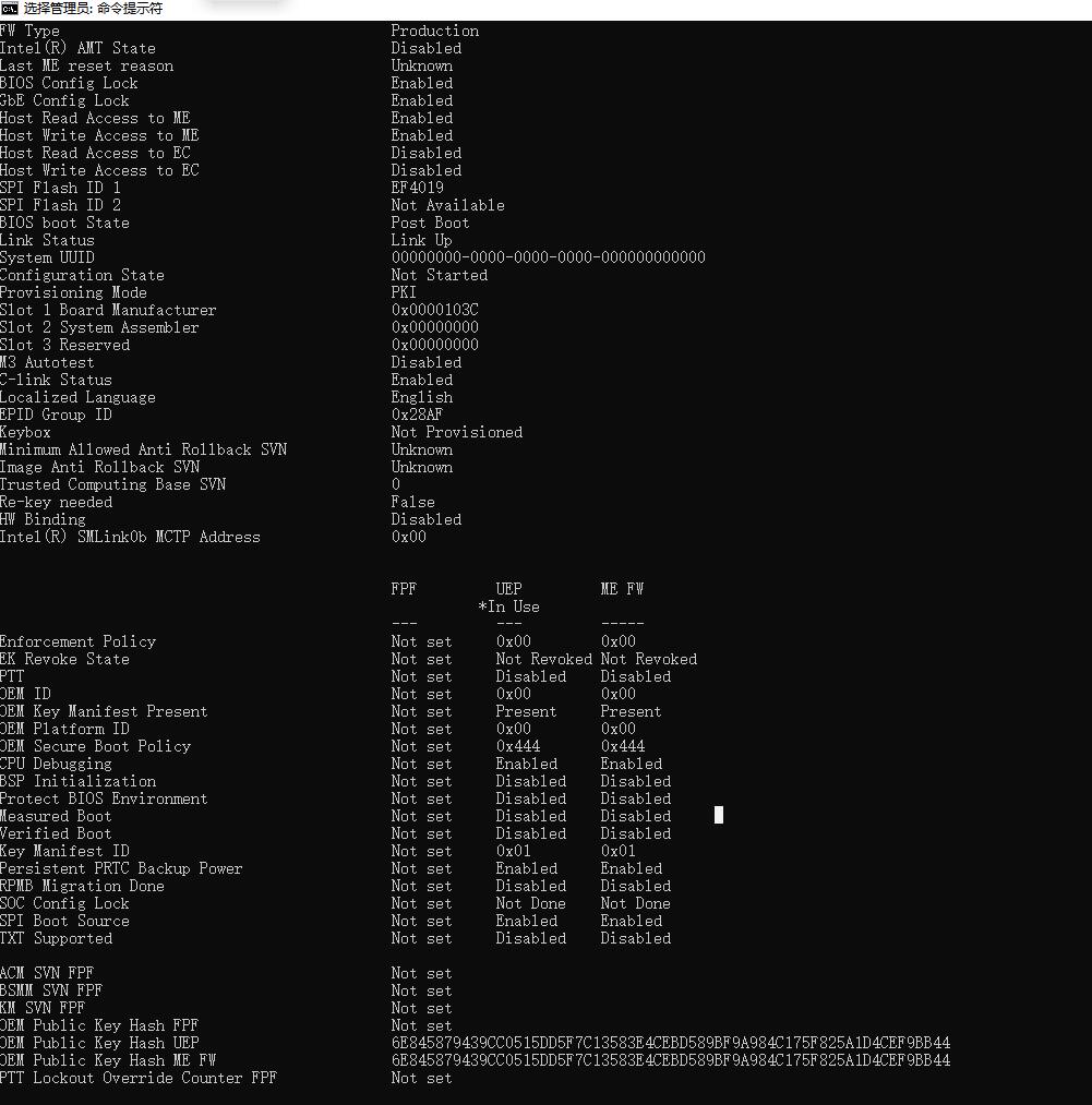

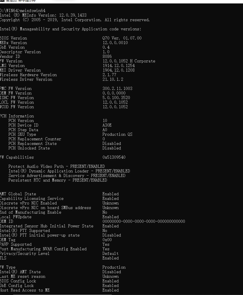

      Re: HP ZBook 15 G5 Mobile Workstation
      Originally posted by imranromi
      Or this say register then show anything
      The left side is detected by the HP official website BIOS MEA, and the right side is detected by my laptop backup BIOS. Without a suitable PRD, there is no way to adapt to the test version of the PCH ES chip, causing the ME update to fail and the sound card not working properly.

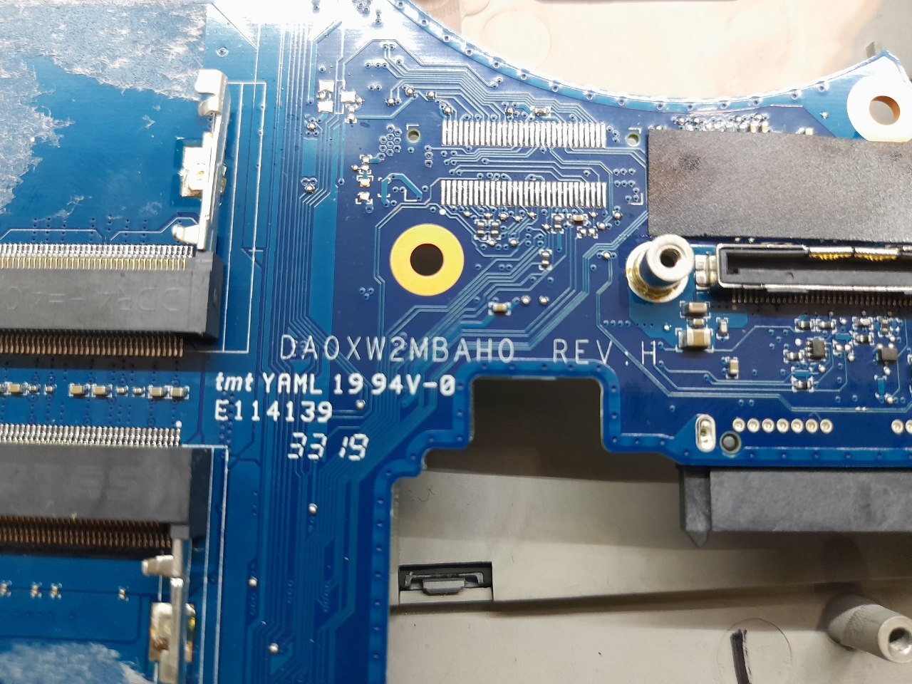

                                  #37
                                  hi i need da0xw2mbag0 rev g bios & ec
                                  please help me
                                    • 21968
                                    #38
                                    please help me
                                    Post the full laptop model number,the serial number (typed,not a photo) and both your bios backups .Read the rules https://www.badcaps.net/forum/troubl...before-posting
