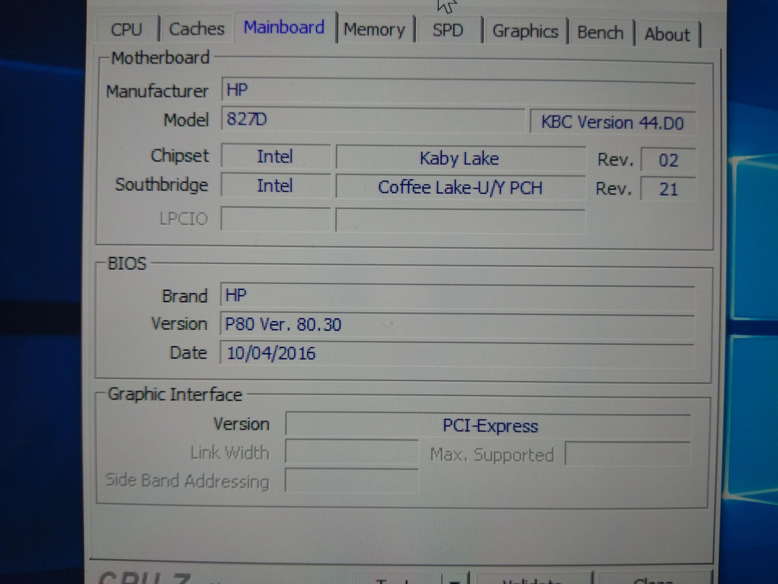

    When I start the thing I get "Bios is not for production use". Once I am in Windows 10 ("for test use only") there are alot of weird executables on the Desktop. Turns out this is a HP "test / prototype" model from 2/2016.
    I installed a fresh copy of Windows and everything works (not perfectly) except autorotation, Fingerprint but most importantly the graphicchip isnt working correctly. I7-7600u Intel HD620
    With the newest Intel drivers the display started to glitch and only stopped when I switched to 30 Hz and back to 60hz.
    Now I have older drivers but from moment to the other all the colours changed: blue became red etc--> This happened after one day of trying around and I dont know how to undo this.// the Colours are back to normal after de/installing the driver

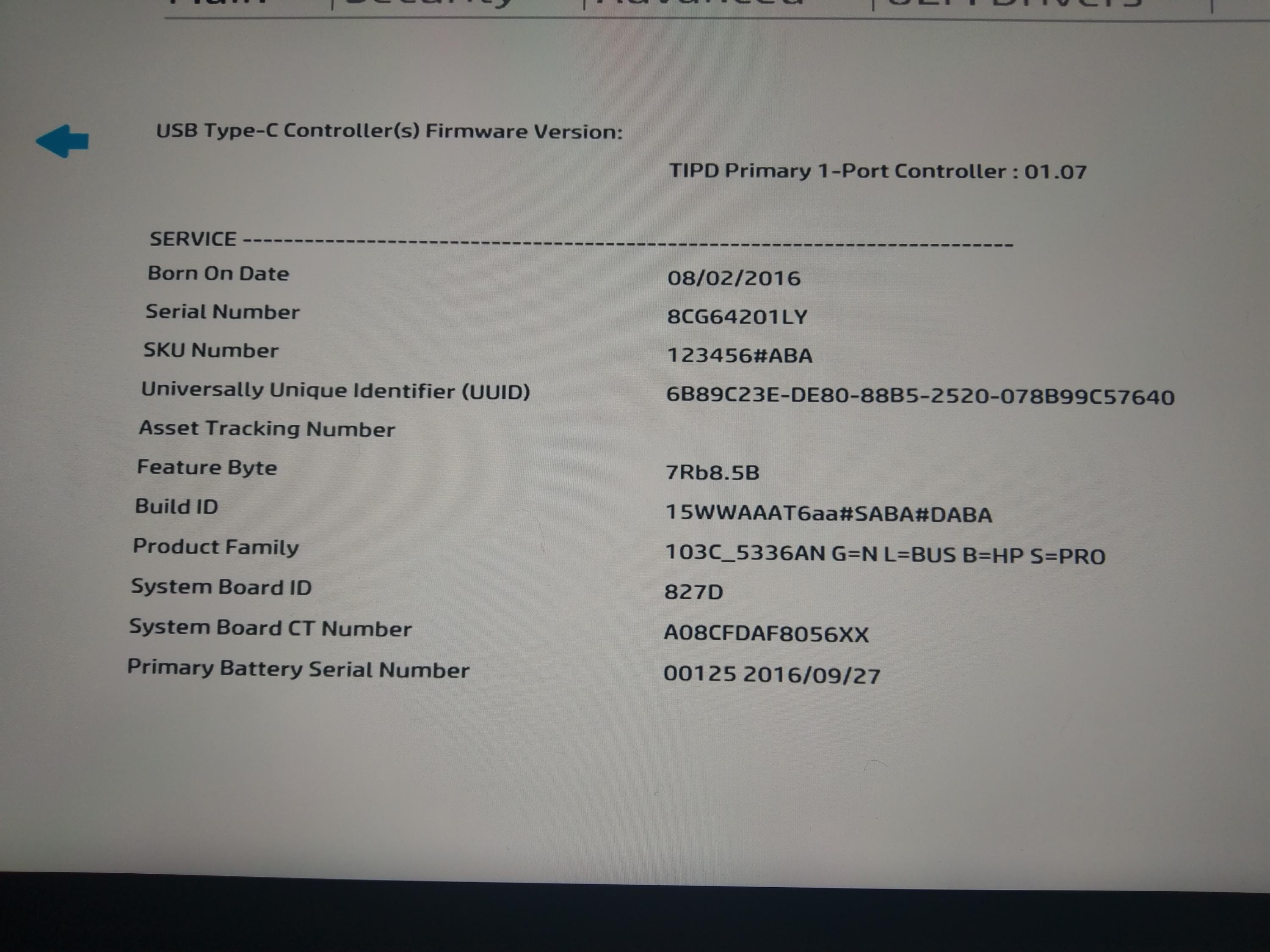

    Now to the Bios. The bios shows a serial number of completly different hp laptop and let me up the VRAM only to 512 MB. My guess is that this experimental bios is limiting the graphic chip somehow and is designed for the testing environment that was installed beforehand.
    I downloaded the official hp bios and tried installing it. The experimental Bios on this machine does not let me install it because of a signature error.
    So I thought maybe it is possible to alter the official Bios with the signature of the experimental one or add an working VBios to the current bios. I looked into and tried programms like Uefipatch, Universal Bios Updated but I donnot understand a thing.
    Maybe anyone on this forum can help me out?
    I uploaded the current bios P80_8030 and the newest official P80_0123. In addition my bios config in a txt and some pictures.

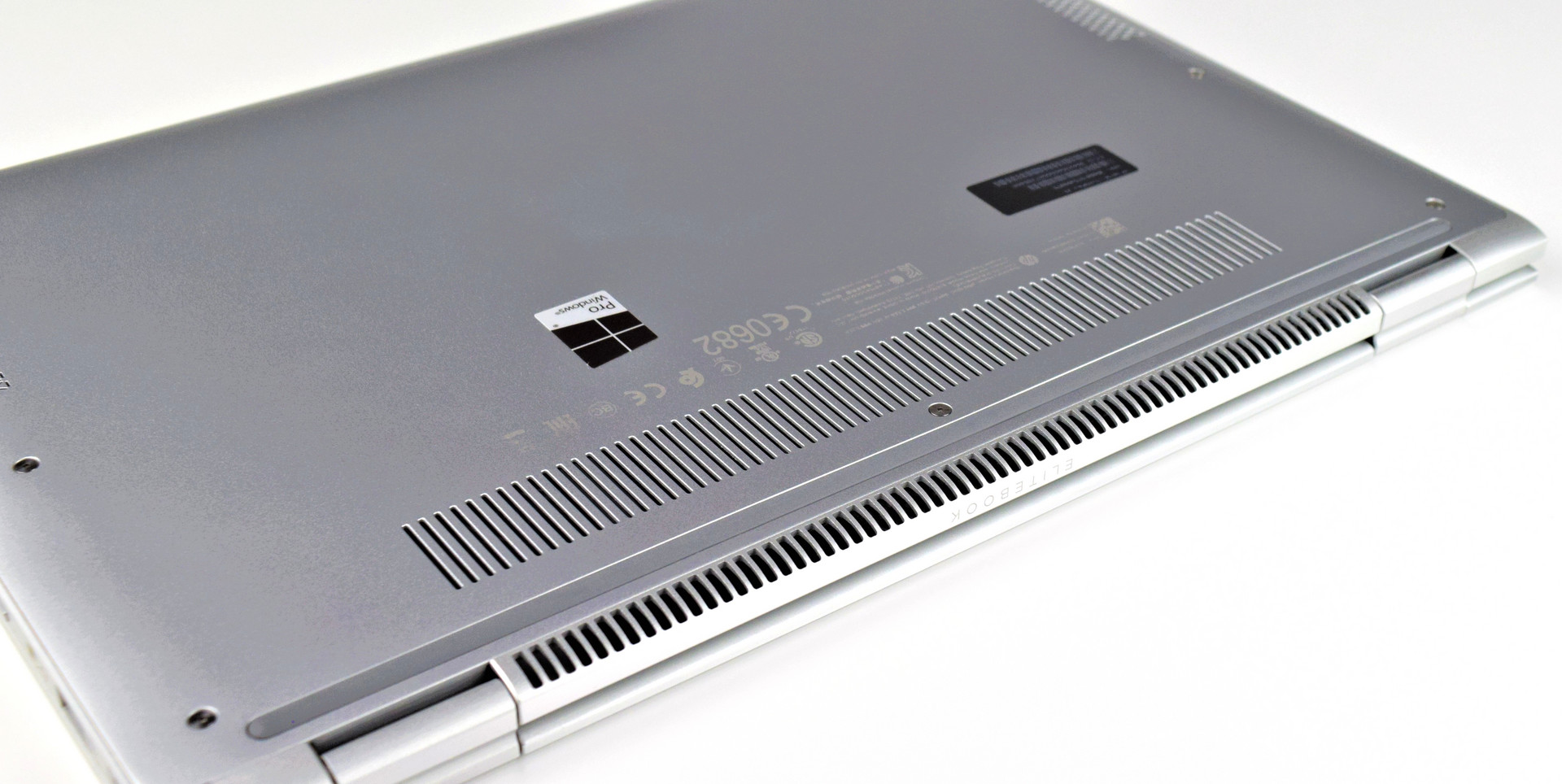

    Maybe you have the wrong hard drive installed with the OS from the x360 11-u001la .What is the serial number, it will be on a sticker in the battery compartment.

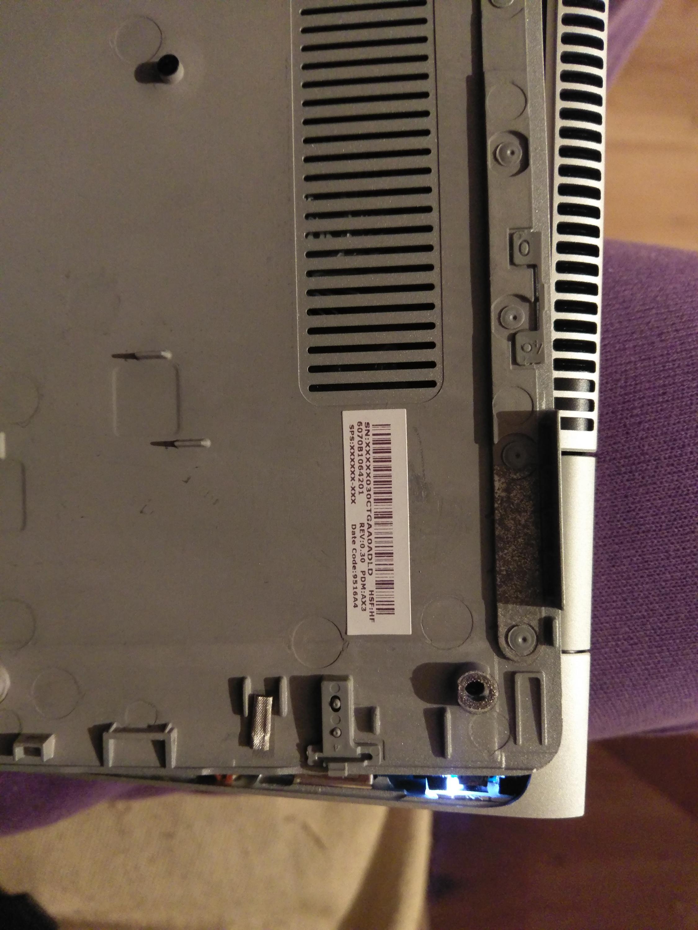

        No, the serial number of the laptop. It isn`t under the battery, its on a black sticker on the base .

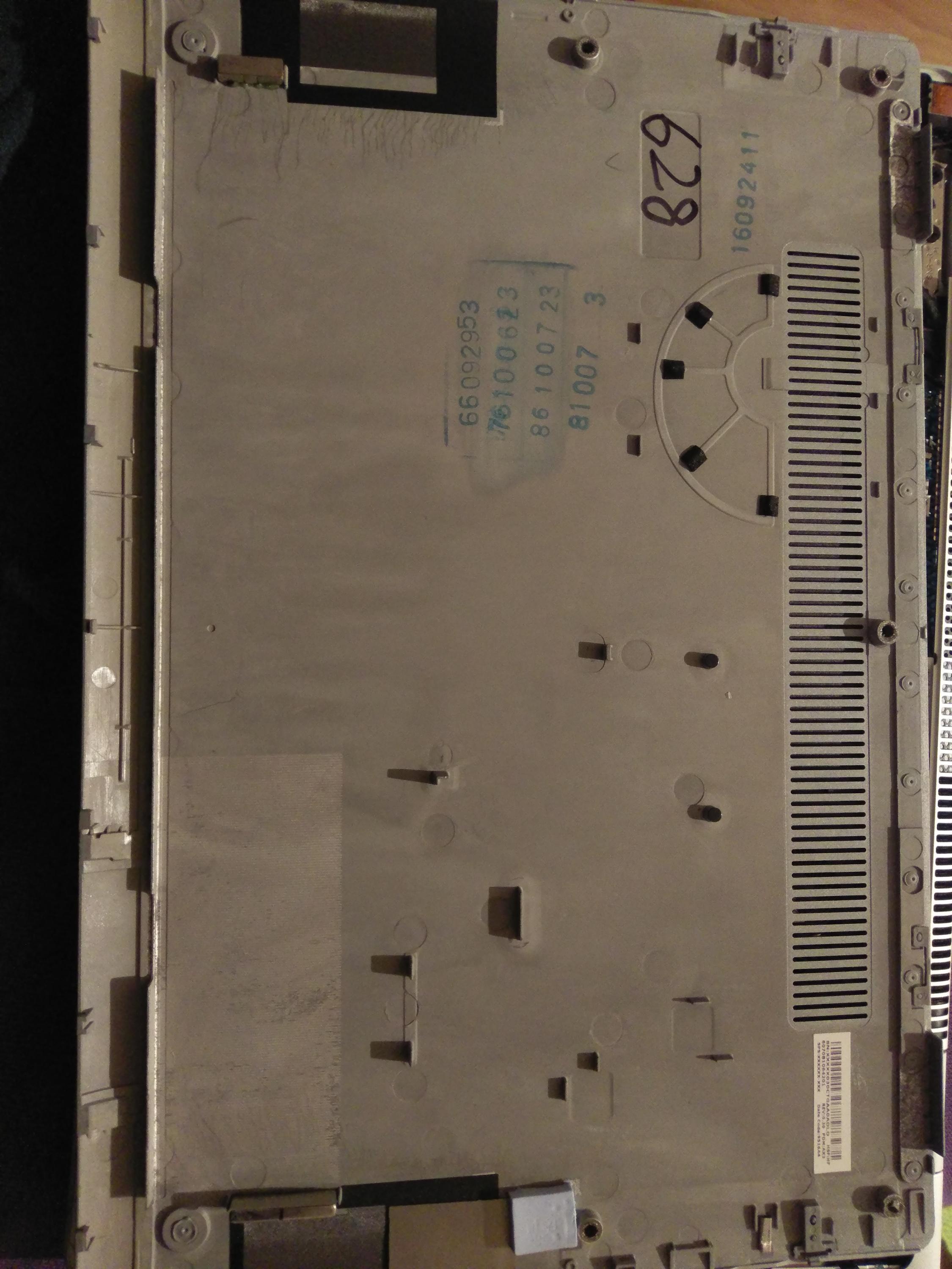

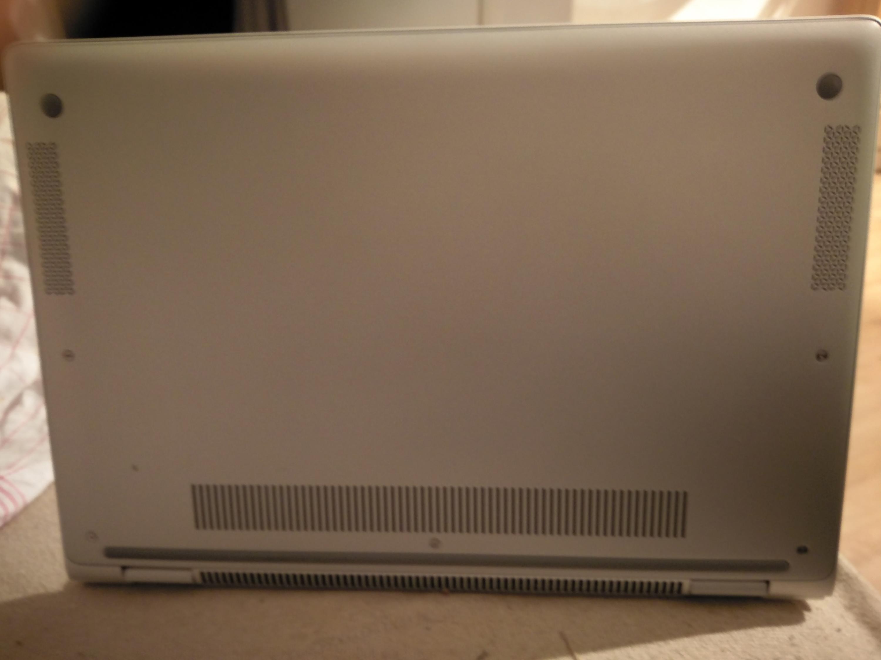

          There is nothing on the base of the Laptop. I only have this weird serial from the bios which belongs to a different Laptop model like you stated.

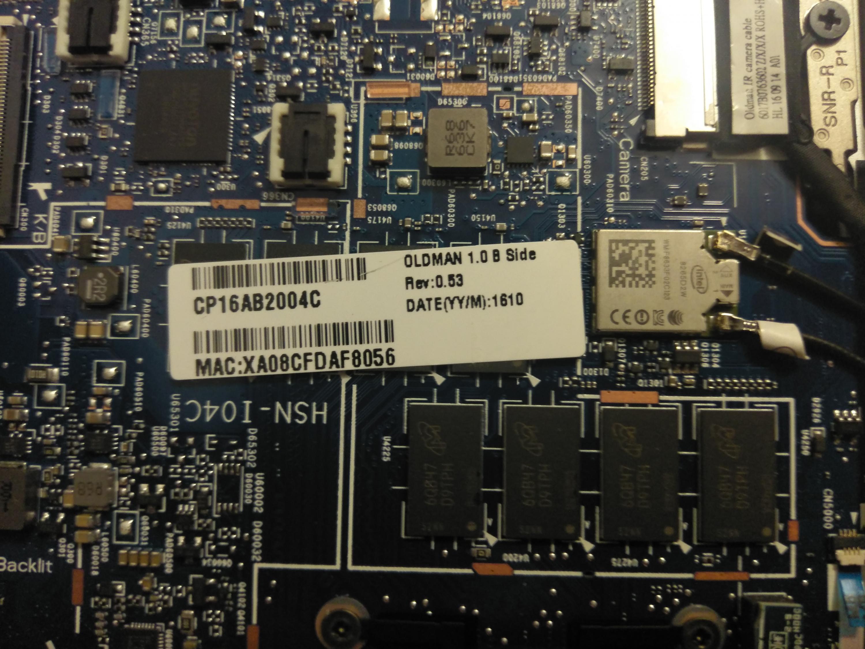

              The motherboard model is "OLDMAN-6050A2848001-MB-A01"
              Mainboard @aliexpress
              HP EliteBook x360 1030 G2 13.3" SR33Z i7-7600U 16GB GMA HD 620

                Ok ,take a note of your MAC address on the sticker.Also look under the top cover for your serial on a black sticker . https://www.ebay.com/itm/HP-Eliteboo...d/392221226468

                  I cannot find any black sticker. Is the serial relevant for my operations?

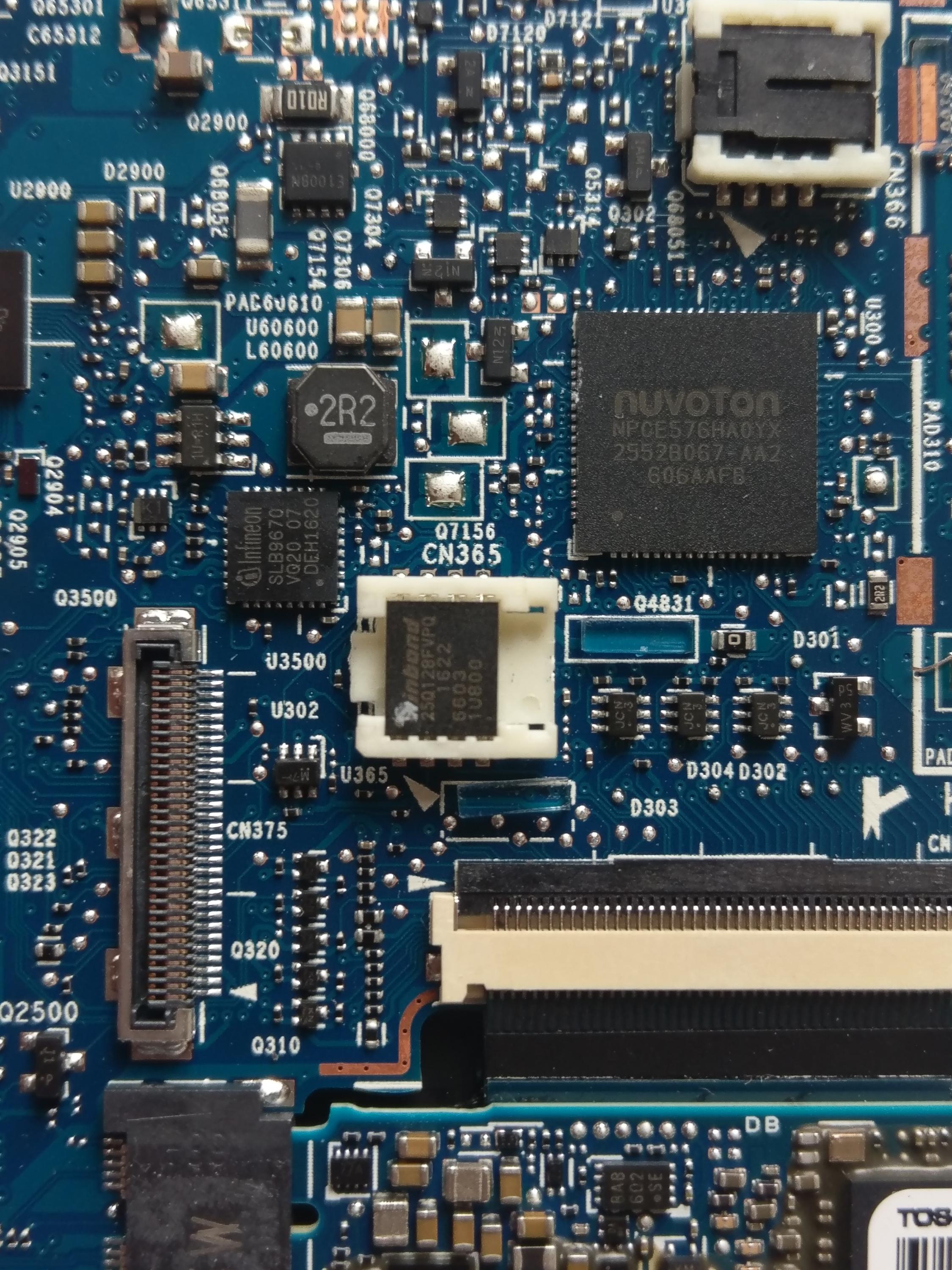

                      So I looked on the mainboard and was surprised to find this (picture). Is it the bios chip? (makes sense since it is removable )
                        • 22275
                        Re: Modded Bios for HP Elitebook 1030 G2
                        Thats unusual to see a soldered test socket ,but you did say its a test/prototype model.It should have a black cover on top.
                        https://www.ebay.com/itm/SMD-SPI-IC-...-/192621238102
                        You could buy a pre programmed bios chip from ebay and slot it in,but you would have to tell the seller you need it on a WSON8 chip .Measure the chip,there are 2 different WSON8 sizes.

                          this is the bios for the mobo with a clean me.try to to find a bios programmer, if everything works ok, remove that clip and solder the chip to the motherboard.

                            Why remove the clips and solder?

                              usually there must be a plastic tab on the top of the clip.It seems to be missing.

                                Nah. I had it removed on the picture.
