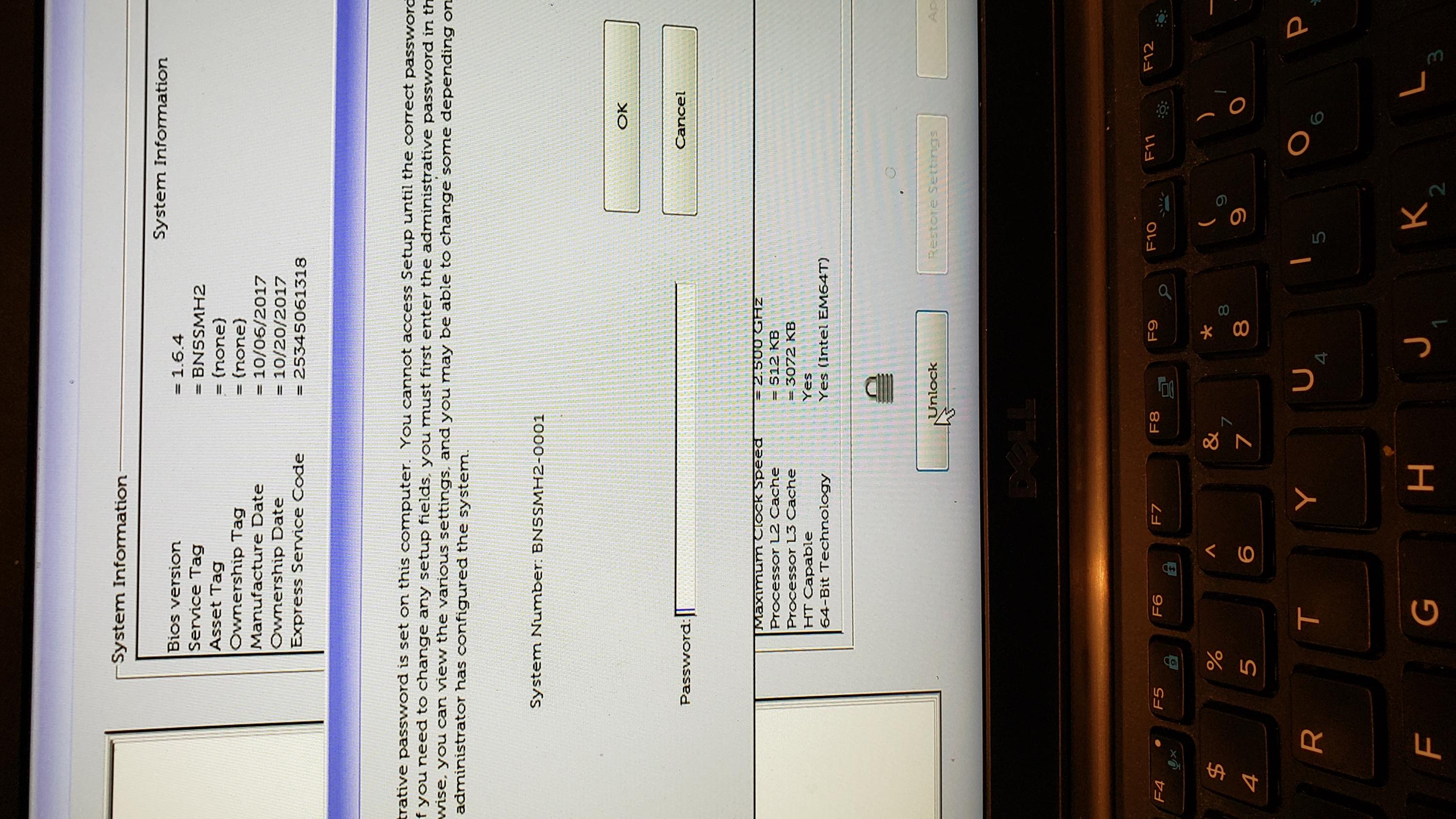

                  Looking for help to remove the bios password for:
                  Latitude 7480
                  System number: BN5SMH2-0001
                  Thank you.

                    Very strange, I don't think I've seen such a suffix, can you post a screenshot.

                      #50
                      Re: BIOS bin file for Dell latitude 7480
                      @Vesko356
                      Yes, it has been around since the release of the E7A8 suffix
                      0001 is not a suffix, it's a code...
                      The master password has been disabled by the administrator. This laptop no longer supports master password.

                        #51
                        Picture attached.

                          #52
                          Originally posted by onizzbox
                          @Vesko356
                          You mean "Master Password Lockout" is enabled in the bios settings?
                          And accordingly master password has been rejected even if it's correct, and in this scenario XXXXXX-0001 is showing on screen.

                              #54
                              @Vesko356
                              Very well put by you! Exactly!

                                #55
                                Originally posted by Traveller33
                                Do I have any options to reset the password? Thanks.
                                Yes of course, take and upload the bios dump here. One of us will remove the password, and after that you can write back the edited file to the chip.

                                  #56
                                  @Traveller33
                                  Yes, just write the BIOS with a file without a password. Just like it was done before the master password was released. @Vesko356 is a master at solving this issue.
