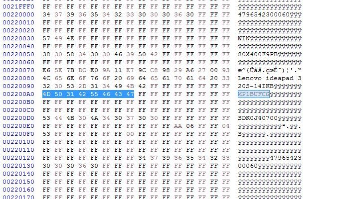

    Hi, I need a BIOS dump with correct DMI data for "bottom information". The laptop had shorted KBC, after replacing and starting the laptop the DMI information disappeared, and the keyboard didn't work either. There were no visible soldering marks on the BIOS chip (it seems that no one had modified the contents before). I am attaching a dump with the laptop working correctly, but no DMI, and the original, I would like to supplement it with correct data.
    Lenovo 320S-14IKB 80X4
    CIUYA/YB/SA/SD LA-E541P Rev 1.0
    KBC: NPCE388NB0DX
    MTM: 80X400F9PB
    SN: MP1BUFCG​
    Try this one and give feedback.

      It just work, perfectly. Great thanks. How it possible? I didn't believe it would work.

        I copied the DMI region from another bios then edited your serial number and MTM into it.

          Sound simple, but in lenovo DMI data is encrypted.

            It`s an Insyde bios, the DMI is not encrypted.
