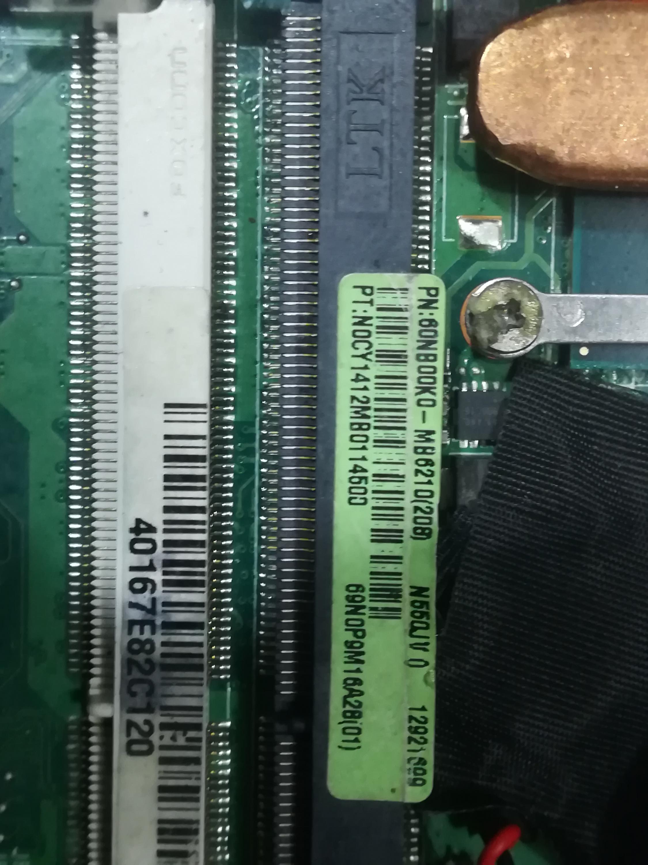

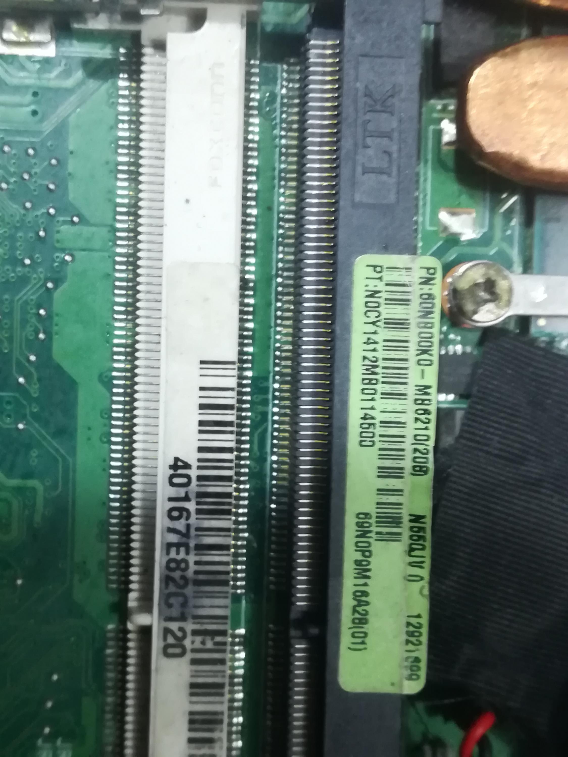

    Post a clear picture of the white/green stickers on the motherboard

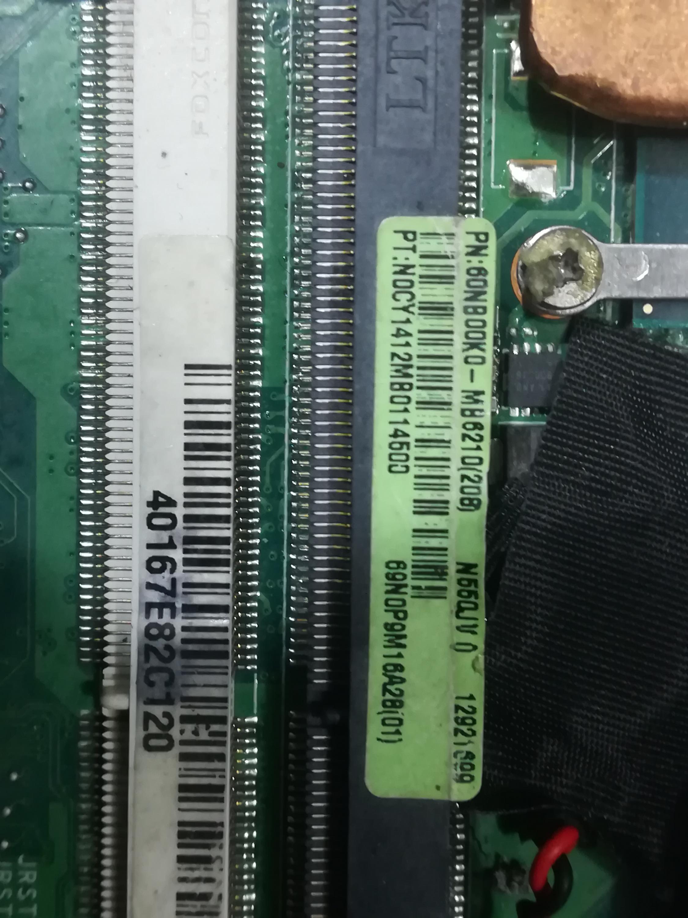

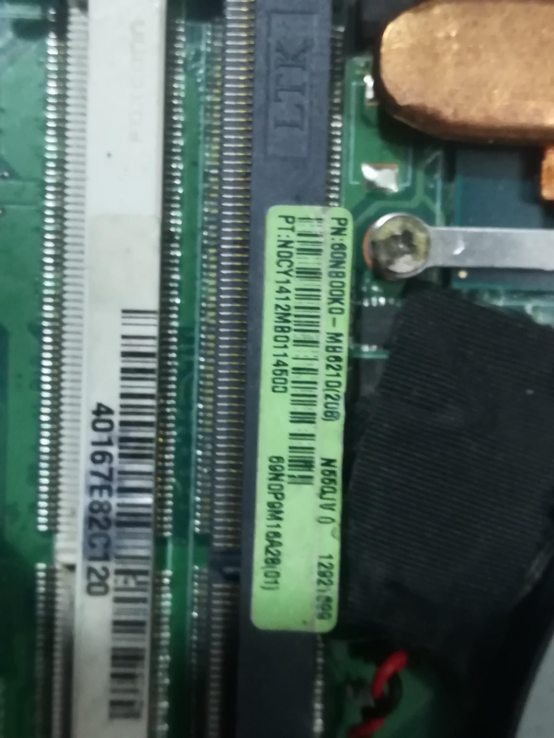

      Can you check it please
        • 21679
        Re: Please help Asus N550JV
        The green sticker on the RAM slot ,post a good clear readable picture,so that we can read what it says on it .

          is it ok ?

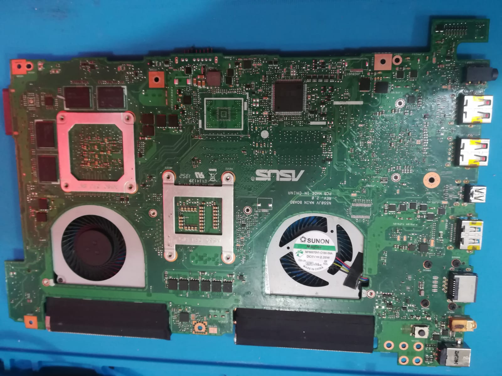

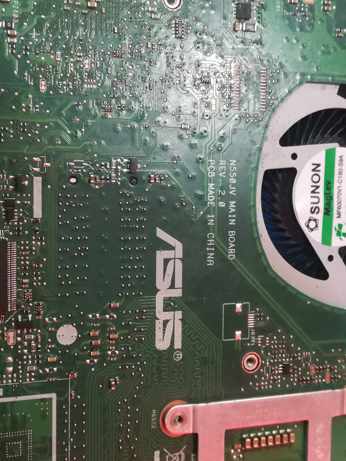

                            Rog series Board code: N550JV REV :2.1 Case Code : G550JV
                            ALL test bios no problem

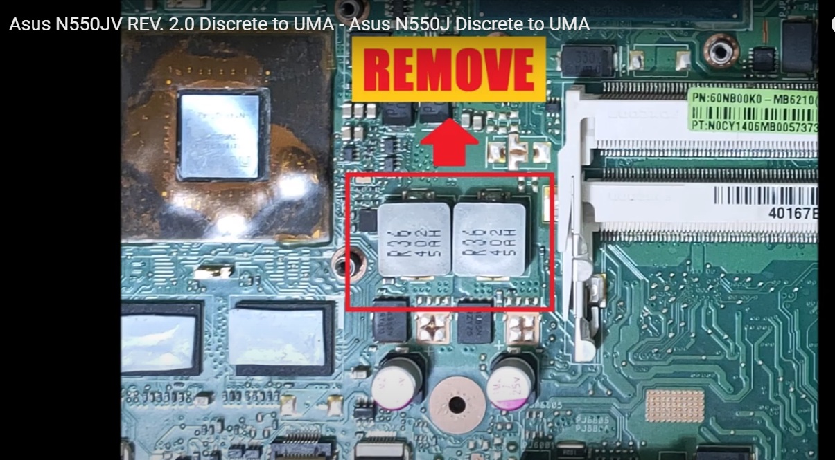

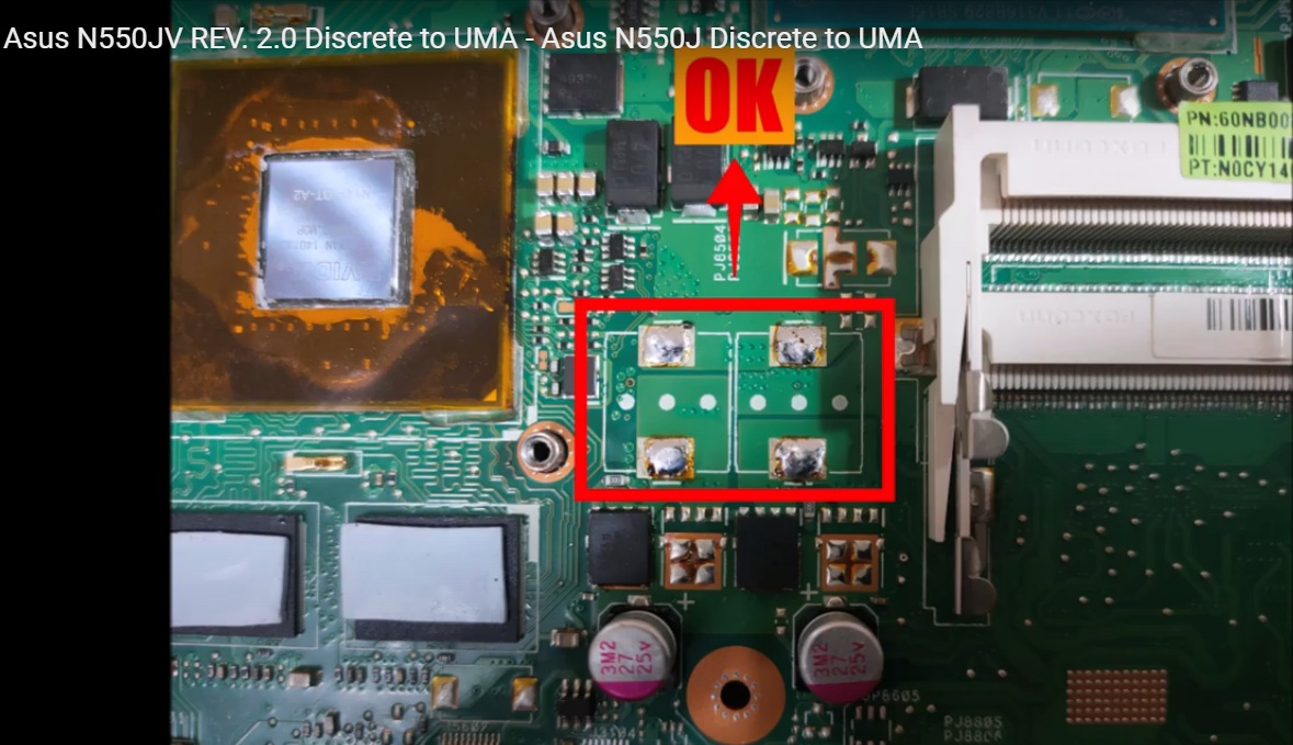

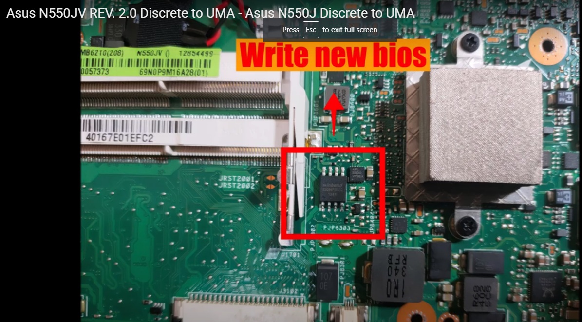

                              Asus N550JV REV. 2.0 Discrete to UMA
                              • snooker31
                                • Mar 2022
                                • 2
                                • Türkiye

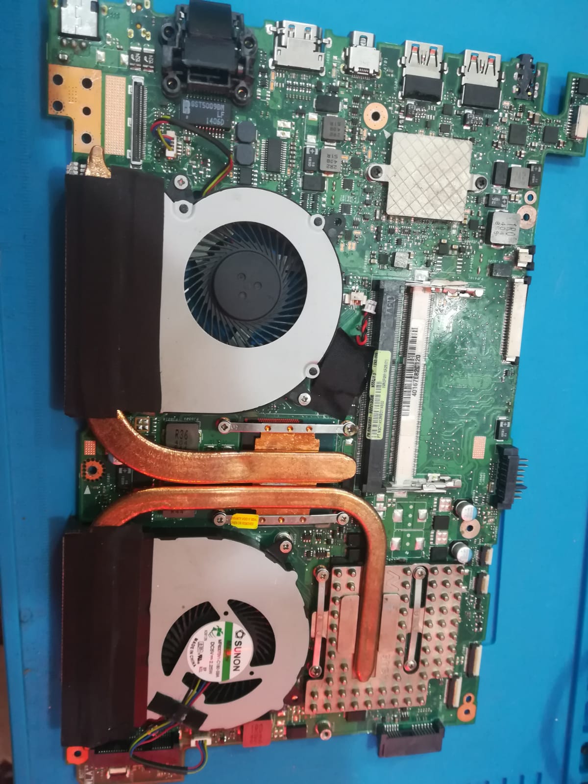

                                          MB : N550JV REV 2.1
                                          Case : G550J
                                          CPU : SR15E
                                          GPU :N15P-GT-A2
                                          I can't get an image. Can you help me edit the bios?​
