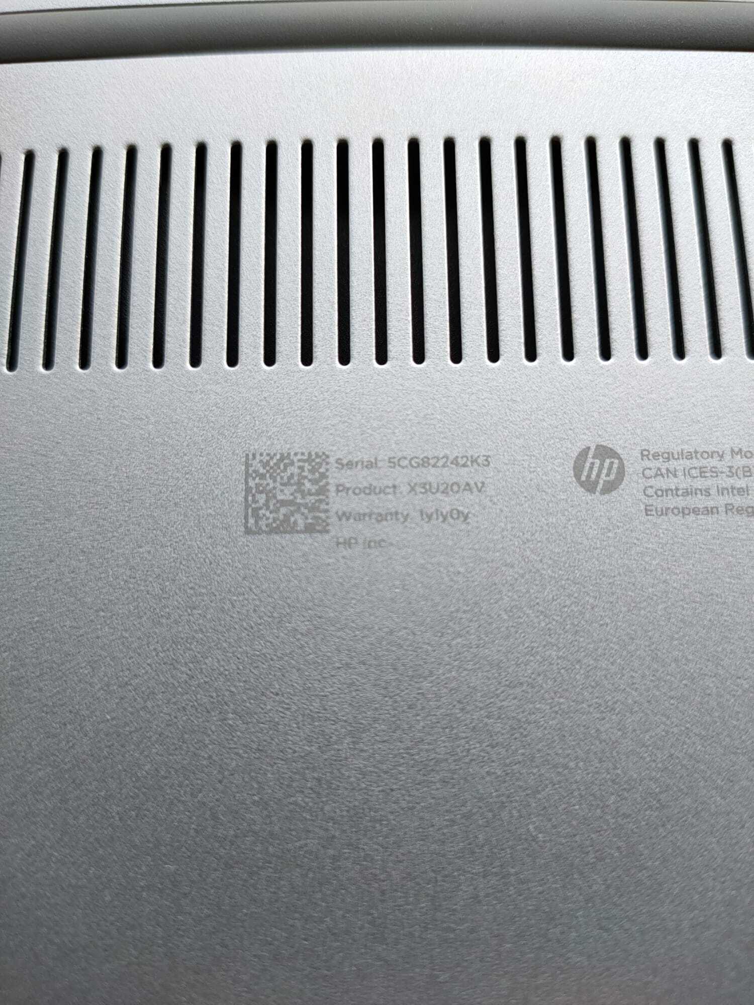

bios for HP EliteBook x360 1030 G2
  • toyoki
    replied
    HP EliteBook x360 1030 G2 bios password
    hello i have HP EliteBook x360 1030 G2 with bios password i tried some bios in the forum doesn't work some of them charging led blinking and some black screen motherboard number OLDMAN-6050A2848001-MB-A01 original dump is joined thanks for help
    Leave a comment:
  • elbtonet
    replied
    Re: bios for HP EliteBook x360 1030 G2
    Hi friends i have my x360 1030g2 dump..Full fan spin ,no display
    please can u help me
    Leave a comment:
  • Vesko356
    replied
    Re: hp elitebook x360 1030 G2 BIOS!!
    Originally posted by mainah njoroge
    where is the file
    Attachments from old posts in multi-page threads like this one are deleted to free up server space - look at the text in my signature
    Leave a comment:
  • mainah njoroge
    replied
    Re: hp elitebook x360 1030 G2 BIOS!!
    Originally posted by alilaptops
    this file have password plz clear me
    where is the file
    Leave a comment:
  • alpha pc
    replied
    Re: bios for HP EliteBook x360 1030 G2
    OLDMAN-6050A2848001-MB-A01 my ec bios is faulty the laptop wont turn on pleas can you clear my bios .
    Leave a comment:
  • hirens
    replied
    Re: bios for HP EliteBook x360 1030 G2
    hp elite book x360 1030 g2
    sn: 5cg8175tsq
    proid: x3u21av
    bios Dump needed
    this machine dose not display only beeps 5 times caps lock
    have tried so many files here but none is responding that's why am finally posting mine for help
    thanks
    Leave a comment:
  • aminealae
    replied
    Re: bios for HP EliteBook x360 1030 G2
    Hi all friends laptop turn on but black screen i need your help please and tnk you advance
    Leave a comment:
    replied
    Re: bios for HP EliteBook x360 1030 G2
    Originally posted by ismy4real
    i need to unlock this file 1030 g3
    Read through the previous posts,you can unlock it yourself , use RCUnlocker.
    Leave a comment:
  • ismy4real
    replied
    Re: bios for HP EliteBook x360 1030 G2
    i need to unlock this file 1030 g3
    Leave a comment:
  • Danitan210789
    replied
    Re: bios for HP EliteBook x360 1030 G2
    Your Backup is messy (not good), read it again.
    You can Unlock your Device using RCUnlocker Tool:
    https://www.badcaps.net/forum/showthread.php?t=98539
    Oh sorry , i have two chips winbond
    first : W250128JVPQ
    Second: W25Q64JVIQ
    i need help
    i try read again second chip .
    Leave a comment:
  • hardware1
    replied
    Re: bios for HP EliteBook x360 1030 G2
    Originally posted by Danitan210789
    Hi, i need help for remove bios password.
    i have backup read with CH341A .
    Your Backup is messy (not good), read it again.
    You can Unlock your Device using RCUnlocker Tool:
    https://www.badcaps.net/forum/showthread.php?t=98539
    Leave a comment:
  • Danitan210789
    replied
    Re: bios for HP EliteBook x360 1030 G2
    Hi, i need help for remove bios password.
    i have backup read with CH341A .
    Last edited by SMDFlea; 04-11-2023, 03:22 PM.
    Leave a comment:
  • hardware1
    replied
    Re: bios for HP EliteBook x360 1030 G2
    Originally posted by Tjaytony
    i have an hp x360 1030 g2 which turns on but no display. customer admitted he tampered with the bios settings or something like that. the backup up main bios and the ec is below. will appreciate if this can be fixed. thanks
    Here's your New BIOS, try this file with your 16MB chip and put your 8MB Chip (EC) Back.
    Serial Number: 5CG7210PH3.
    Leave a comment:
  • Tjaytony
    replied
    Re: bios for HP EliteBook x360 1030 G2
    i have an hp x360 1030 g2 which turns on but no display. customer admitted he tampered with the bios settings or something like that. the backup up main bios and the ec is below. will appreciate if this can be fixed. thanks
    Last edited by SMDFlea; 04-11-2023, 03:22 PM.
    Leave a comment:
  • hoaca388
    replied
    Re: bios for HP EliteBook x360 1030 G2
    Originally posted by dahnking
    capslock blinking 5 times
    no display
    Check harware problem.
    Leave a comment:
  • dahnking
    replied
    Re: bios for HP EliteBook x360 1030 G2
    Originally posted by hoaca388
    HP EliteBook x360 1030 G2
    capslock blinking 5 times
    no display
    Leave a comment:
  • hoaca388
    replied
    Re: bios for HP EliteBook x360 1030 G2
    Originally posted by dahnking
    HP EliteBook x360 1030 G2 OLDMAN-6050A2848001-MB-A01 7th Gen
    looking for working BIOS
    attached backup files (8MB & 16MB) has no display
    HP EliteBook x360 1030 G2
    Leave a comment:
  • dahnking
    replied
    Re: bios for HP EliteBook x360 1030 G2
    HP EliteBook x360 1030 G2 OLDMAN-6050A2848001-MB-A01 7th Gen
    looking for working BIOS
    attached backup files (8MB & 16MB) has no display
    Last edited by SMDFlea; 04-11-2023, 03:22 PM.
    Leave a comment:
  • hoaca388
    replied
    Re: bios for HP EliteBook x360 1030 G2
    Originally posted by nishnish
    I need to clear the bios password on an HP Elitebook x360 1030 G2 (OLDMAN-6050A2848001-MB-A01)
    Which of the following chips do I need to dump and edit/replace?
    WINBOND
    25Q128JVPQ (8-WSON)
    MXIC
    MX25L6473FZNI (8-WSON)
    Best regards
    Backup both, using RC Unlocker with the file from the Winbond chip first.
    Leave a comment:
  • nishnish
    replied
    Re: bios for HP EliteBook x360 1030 G2
    I need to clear the bios password on an HP Elitebook x360 1030 G2 (OLDMAN-6050A2848001-MB-A01)
    Which of the following chips do I need to dump and edit/replace?
    WINBOND
    25Q128JVPQ (8-WSON)
    MXIC
    MX25L6473FZNI (8-WSON)
    Best regards
    Leave a comment:
    HP EliteBook x360 EliteBook x360 1030 G2 Hybrid (2-in-1) Specification for Upgrade or Repair
    This specification for the HP EliteBook x360 EliteBook x360 1030 G2 Hybrid (2-in-1) can be useful for upgrading or repairing a laptop that is not working. As a community we are working through our specifications to add valuable data like the EliteBook x360 1030 G2 boardview and EliteBook x360 1030 G2 schematic. Our users have donated over 1 million documents which are being added to the site. This page will be updated soon with additional information. Alternatively you can request additional help from our users directly on the relevant badcaps forum. Please note that we offer no warranties that...
    09-06-2024, 08:27 AM
    HP EliteBook x360 EliteBook x360 1030 G2 (ENERGY STAR) Hybrid (2-in-1) Specification for Upgrade or Repair
    This specification for the HP EliteBook x360 EliteBook x360 1030 G2 (ENERGY STAR) Hybrid (2-in-1) can be useful for upgrading or repairing a laptop that is not working. As a community we are working through our specifications to add valuable data like the EliteBook x360 1030 G2 (ENERGY STAR) boardview and EliteBook x360 1030 G2 (ENERGY STAR) schematic. Our users have donated over 1 million documents which are being added to the site. This page will be updated soon with additional information. Alternatively you can request additional help from our users directly on the relevant badcaps forum. Please...
    09-06-2024, 06:40 AM
    HP EliteBook x360 EliteBook x360 1030 G2 (ENERGY STAR) Hybrid (2-in-1) Specification for Upgrade or Repair
    This specification for the HP EliteBook x360 EliteBook x360 1030 G2 (ENERGY STAR) Hybrid (2-in-1) can be useful for upgrading or repairing a laptop that is not working. As a community we are working through our specifications to add valuable data like the EliteBook x360 1030 G2 (ENERGY STAR) boardview and EliteBook x360 1030 G2 (ENERGY STAR) schematic. Our users have donated over 1 million documents which are being added to the site. This page will be updated soon with additional information. Alternatively you can request additional help from our users directly on the relevant badcaps forum. Please...
    09-06-2024, 05:33 AM
    HP EliteBook x360 EliteBook x360 1030 G2 (ENERGY STAR) Hybrid (2-in-1) Specification for Upgrade or Repair
    This specification for the HP EliteBook x360 EliteBook x360 1030 G2 (ENERGY STAR) Hybrid (2-in-1) can be useful for upgrading or repairing a laptop that is not working. As a community we are working through our specifications to add valuable data like the EliteBook x360 1030 G2 (ENERGY STAR) boardview and EliteBook x360 1030 G2 (ENERGY STAR) schematic. Our users have donated over 1 million documents which are being added to the site. This page will be updated soon with additional information. Alternatively you can request additional help from our users directly on the relevant badcaps forum. Please...
    09-06-2024, 05:33 AM
    HP EliteBook x360 EquipoEliteBook x360 1030 G4 Hybrid (2-in-1) Specification for Upgrade or Repair
    This specification for the HP EliteBook x360 EquipoEliteBook x360 1030 G4 Hybrid (2-in-1) can be useful for upgrading or repairing a laptop that is not working. As a community we are working through our specifications to add valuable data like the EquipoEliteBook x360 1030 G4 boardview and EquipoEliteBook x360 1030 G4 schematic. Our users have donated over 1 million documents which are being added to the site. This page will be updated soon with additional information. Alternatively you can request additional help from our users directly on the relevant badcaps forum. Please note that we offer...
    09-06-2024, 11:32 AM
