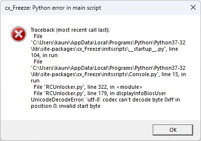

                            hi
                            any one can help to unlock this bios for HP elitebook 8560p
                            Serial: 5CB1433YQF

                            #77
                            Originally posted by SMDFlea
                            not working
                            • peste
                              • Dec 2016
                              • 13924
                              • ROMANIA
                              #78
                              Originally posted by nefaa.ben.jeddou
                              not working
                              write it like this on the chip..it's ok...

                                #79
                                sorry, the original dump and unlocked dump are the same when compared with HXD
