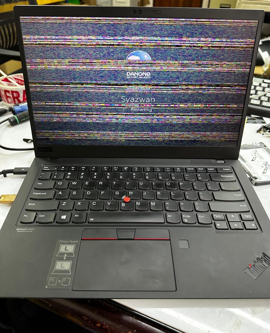

              #86
              Hi, sir this laptop comes with the problem hang in few minutes sometimes on logo. im sharing the picture. after i try with new dump now status changed to power light blink 3 times than off. please help.
              Lenovo X1 Carbon Gen 8
              GX4A0-GYG50
              NM-C881 REV 1.0
              TYPE NUMBER : 20UA-S4WN00
              SN : PF-2JP0ZX

              #87
              GX4A0-GYG50
              NM-C881 REV 1.0
              SN : PF-2JP0ZX
              have you tried on an external screen? I think it's a video problem.. write back the original bios and try on the external one, see what happens..

                #88
