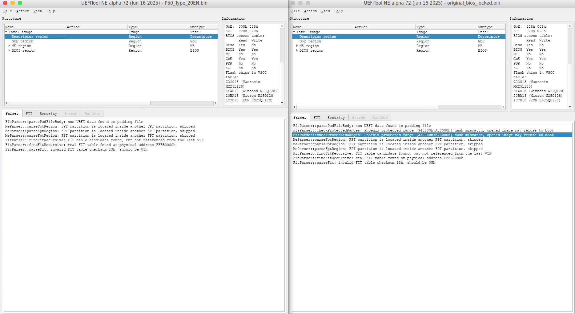

I need help removing the Supervisor Password from a Lenovo ThinkPad P50.
**Laptop information:**
- Model: Lenovo ThinkPad P50
- Motherboard: BP500 NM-A451 Rev. 1.0
- BIOS chip: Winbond W25Q128BV (16MB, SOIC8)
- BIOS dump size: 16,777,216 bytes (exactly 16 MB)
**What I did:**
1. I successfully read the original BIOS using a CH341A programmer with a SOIC8 clip.
2. I used lenovo_autopatcher 0.2 to create a patched BIOS.
3. I successfully uploaded the patched BIOS to the chip (verified using NeoProgrammer).
4. The laptop turns on, but nothing is displayed on the screen
**Current behavior:**
- Power LED is on (green)
- LEDs on the keyboard are flashing (NumLock, CapsLock, Mute, Speaker)
- Fans spin for a few seconds, stop, then spin again after 30 seconds
- Fans run for about a minute, then stop
- No display output (black screen)
- No POST beeps
**What I've tried:**
- Waited 5+ minutes for boot
- Checked all connections (RAM, LCD cable, SSD)
- All components are connected correctly
- Wi-Fi card is NOT installed (missing)
**Question:**
Can a missing Wi-Fi card prevent a patched BIOS from booting?
Or is there a problem with the autopatcher for this particular model?
I have the original BIOS dump backed up and can restore it if necessary.
Could someone please help me:
1. Create a working patched BIOS for this model, OR
2. Advise what might be causing the boot failure
**Attached files:**
- original_bios_locked.bin (16,777,216 bytes)
Thank you very much for your help!
