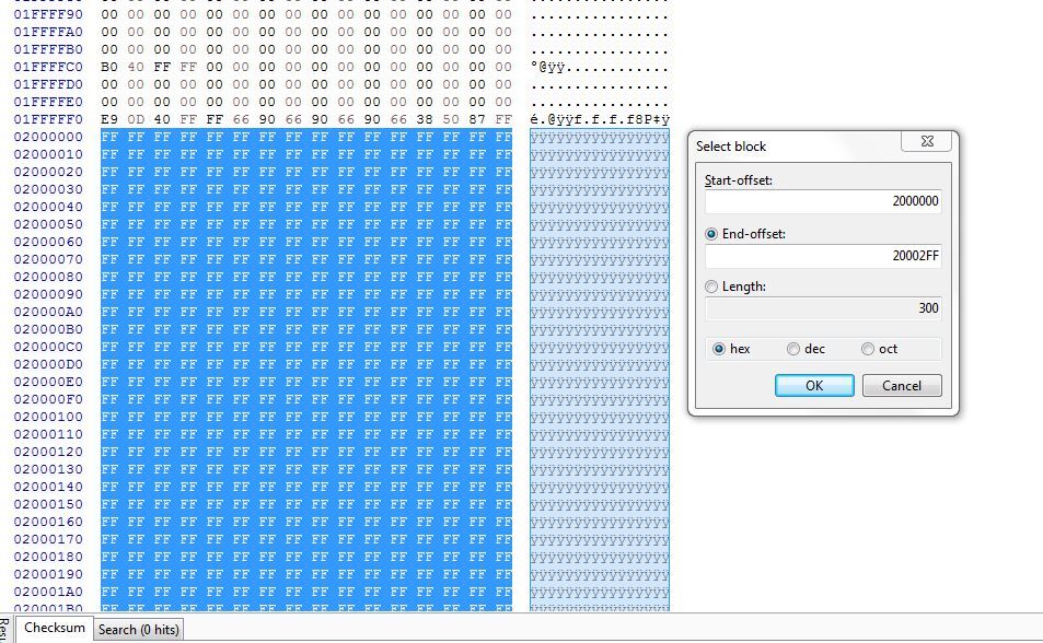

                  • 21889
                  Originally posted by kumar1144
                  Bit size changed kindly correct it
                  The file is 32,769KB it should be 32,768KB .Delete the extra bytes with a hex editor and save .
                  HxD Hex Editor - https://mh-nexus.de/en/hxd/

                  • kumar1144
                    • Mar 2020
                    • 19
                    • India
                    Click image for larger version  Name:	Capture.jpg Views:	0 Size:	160.8 KB ID:	3744063
