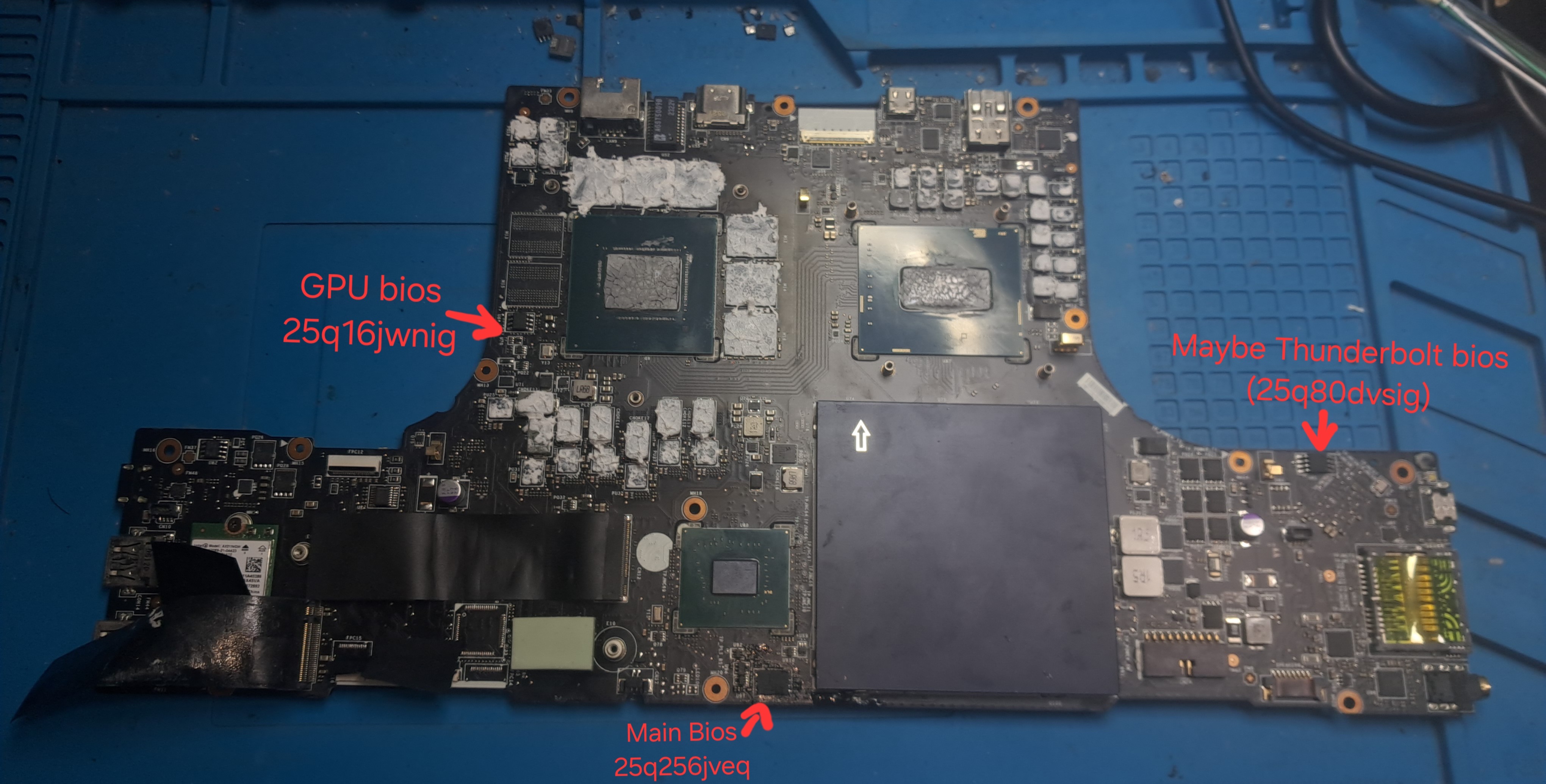

    Need bios for MSI vector gp68hx 13v.
    The main problem is it hung when press button switch.
    after finding issue it's have 2 bios and 1 of it have blank bios chip (25q80dvsig)
    so, does anyone have this (especially blanked) bios file?

    try..
    https://www.msi.com/Laptop/Vector-GP...or-GP68HX-13VH
      didn't work
      keyboard led didn't even light anymore with that bios (all standby voltage still exist)
      also bios chip 25q80dvsig didn't match size

        The 25q80dvsig chip is for Thunderbolt firmware or the EC ,not sure which. Post a picture of the area on the board where this chip is located

          the bios has 33MB...it's normal that it didn't fit on that chip...look for another bios chip...something with 256..
            i did flash main bios and yeah that chip (25q80dvsig) maybe thunderbolt bios but why it have small size than bios from home page?
              ok and which chip should you put the bios on???
                i did flash 25q256 and no luck, still blank
