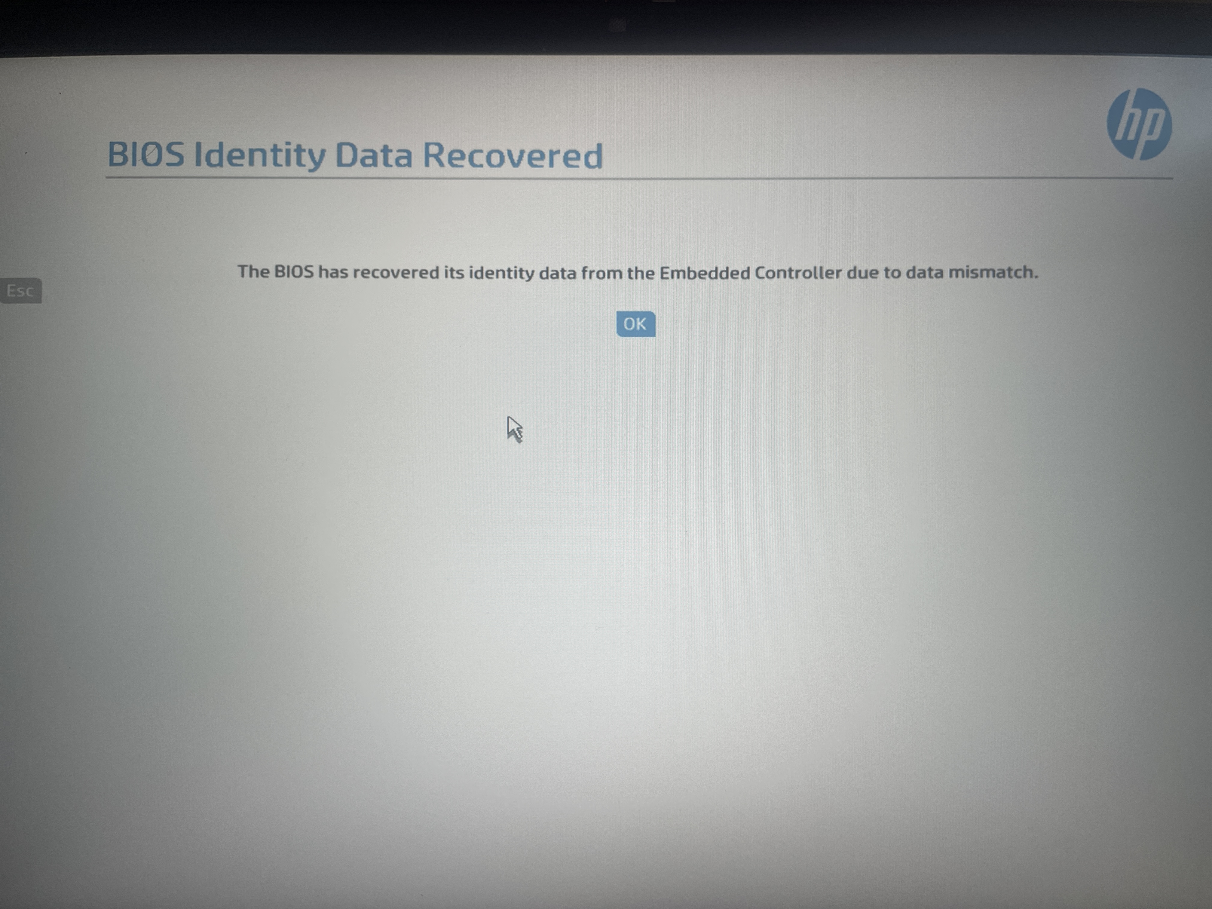

                    • trunguntilyou
                      • Aug 2022
                      • 378
                      • Vietnam
                      • work, play games
                      HP ZFly14G11
                      6050A3510401
                      sn: 2MQ502127T
                      The problem is that every time I boot into Windows, it shows an error and I can't continue using it. Reinstalling Windows and connecting to Wi-Fi works for a while, then the problem returns, similar to an MDM error. Please help me.

                      Originally posted by trunguntilyou
                      HP ZFly14G11
                      6050A3510401
                      sn: 2MQ502127T
                      I still need help... please.
                        • 23881
                        What does the error message say
                          Sorry for the delay, this is an error message, still need help.
                            HI try flash bios then new os flash
                            I reinstalled Windows, it ran fine for a while, but after restarting, the error reappeared. I still need help.
                                Use BCU under cmd as Admin to read bios settings and there is a setting "Permanently disable Absolute Persistance-set once" - move * from Enable to Disable and write back bios settings.
                                Use cmd lines: "biosconfigutility /get:1.txt" and after making modification "biosconfigutility /set:1.txt"
                                of course, reinstall win and don't connect to internet before doing that.
                                  Oh, this error can be fixed using the BCU tool? Thanks, I'll try it next time. I've flashed the LBTT1121 file and it's working fine. Thanks for your help!
