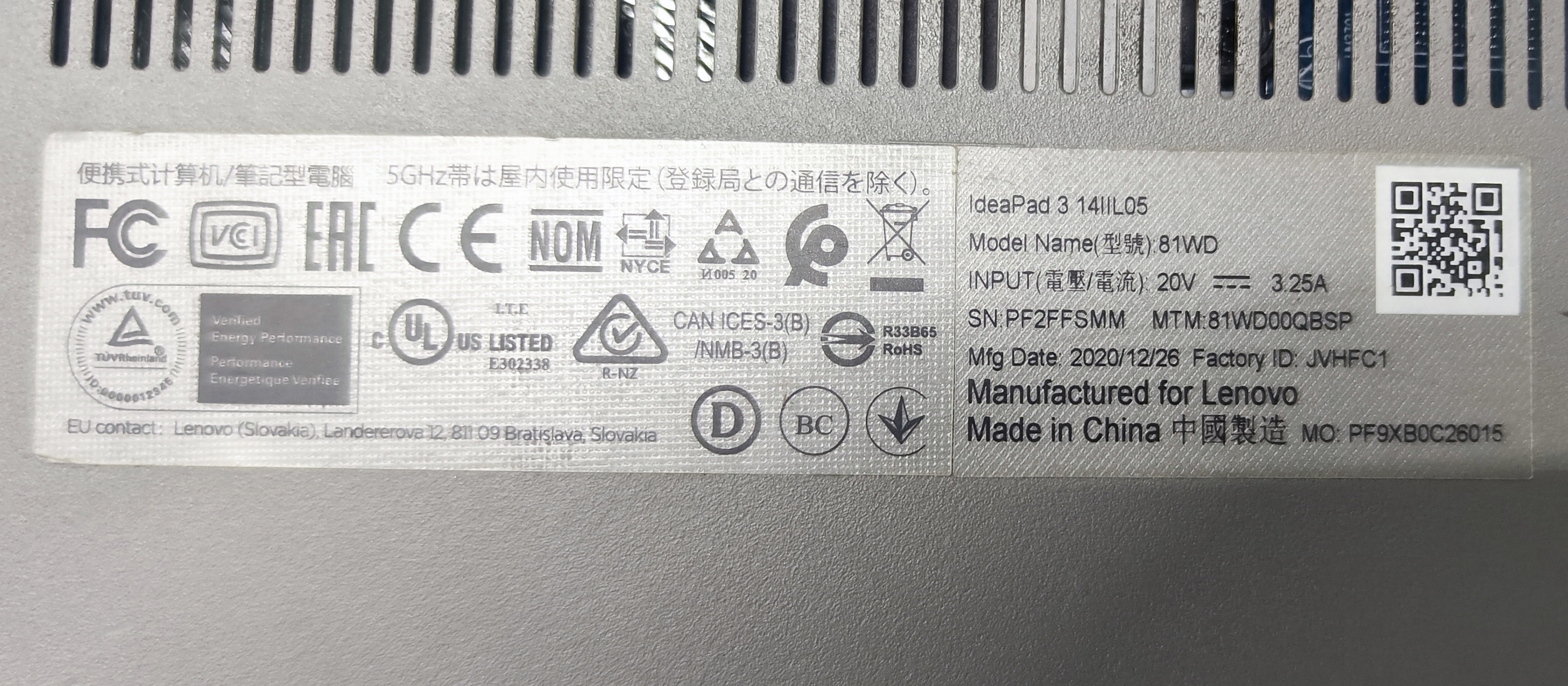

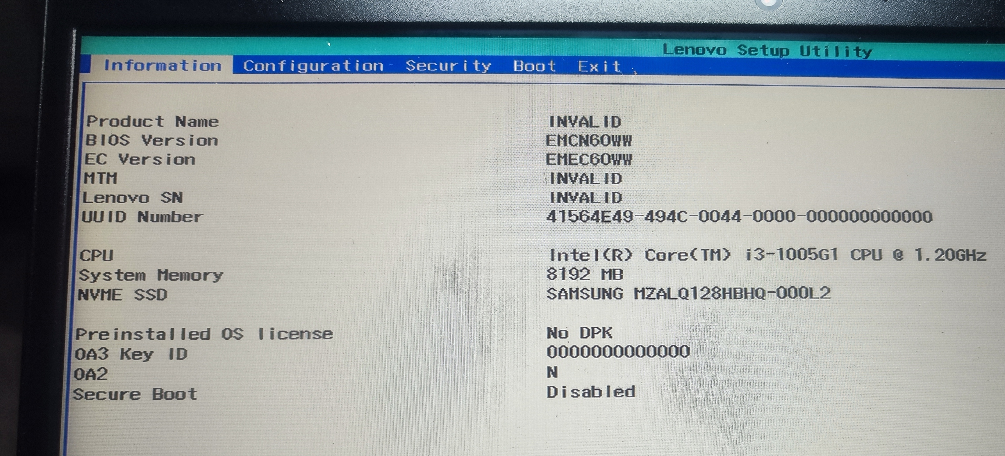

    Hello everyone i have lenovo ideapad 3 14IIL05 BIOS showing invalid product name and MTM and SN.
    can someone help me with clean bios right informations.
    Product name : ideapad 3 14IIL05
    Model name : 81WD
    SN : PF2FFSMM
    MTM : 8IWD00QBSP
    MFG DATE : 2020/12/26
    FACTORY ID : JVHFC1
    Thank you in advance

    Yacine007 attach bios backup.
    • Yacine007
      • May 2024
      • 80
      • Maroc
      Here is the backup. Thank you LEO037_2029_

        ideapad 3-14IIL05 Laptop - Type 81WD
        • Yacine007
          • May 2024
          • 80
          • Maroc
          Thank you for your cooperation but problem not resolved.
          • hoaca388
            Badcaps
            • Jan 2022
            • 12020
            This is a file without DMI, you must add DMI manually.
            • Yacine007
              • May 2024
              • 80
              • Maroc
              Sorry to have bothered you but my knowledge and skills have not reached this stage. I searched and tried but I did not find the right tool and the right tutorial. Anyway thank you my Friend ,🙏
