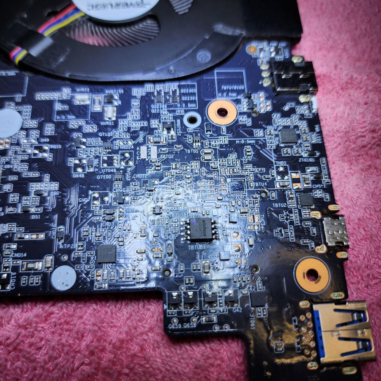

    need bios bin for Gigabyte AERO 15 OLED YD BIOS Bin. My model RP75 , S/N: SN21180J001736 , motherboard: GA-RP75YD REV:1.0 ( I9 with RTX3080 ). MY last working bios version F03. Try to Upgrade to F08. Now fan spin but no display. Thank for advance.

      TBTUB1 & TBTUB2

        TBTUB1 & TBTUB2
        Wrong bios chip.

          Dual bios , not sure
            Your bios is 32MB in size, so look for chips with the number 256 , Ex : W25Q256DV

              Already check another model same bios size 8Mbit. WINBOND W25Q80DV.

                TBTUB1 , TBTUB2 is Thunderbolt firmware .

                  Sorry guy , Now I am recognize main bios chip W25R256JV. But the problem , my TL866 plus programmer can't recognize this Winbond chip. Do you know how to flash this chip. Thank for advance.
                    SMDFlea commented
                    Editing a comment
                    Try W25Q256 .Untick check-ID .Untick verify.

                    Right now , I can upload bios file to chip. but result fan spin and motherboard get hot, but no display show up.
