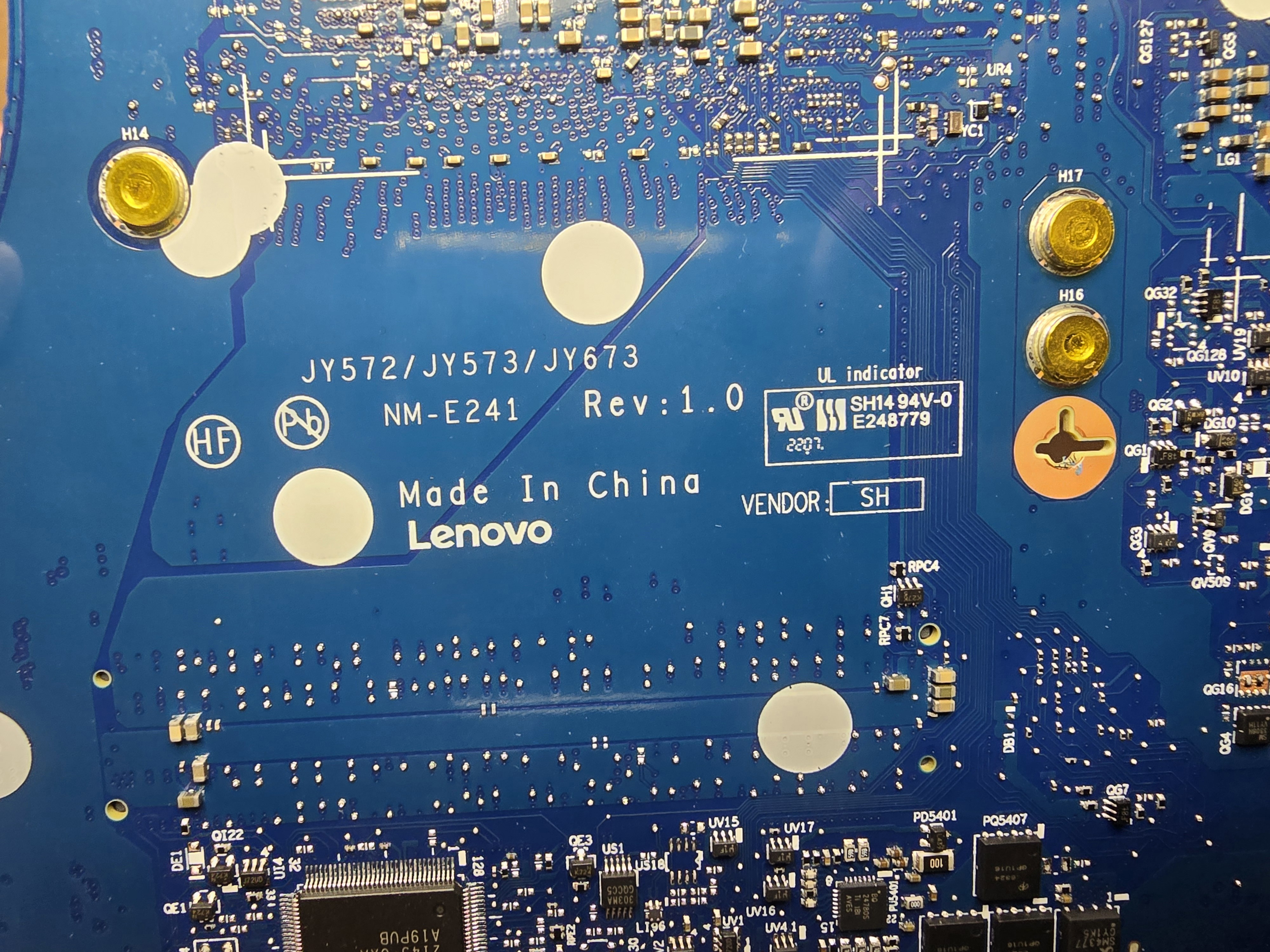

    My Legion 5 15IAH7 won't post. won't boot. No fans, no keyboard backlight.
    Online power led and charging led lights up.
    My guess is that there is some issue with the BIOS.
    It's the NM-E241 Rev 1.0 motherboard.
    As I found out there are two BIOS dumps needed for this board.
    One 16MB and one 8MB.
    I've got both uploaded. Can you maybe check and fix this BIOS files?
    Thanks a lot in advantage

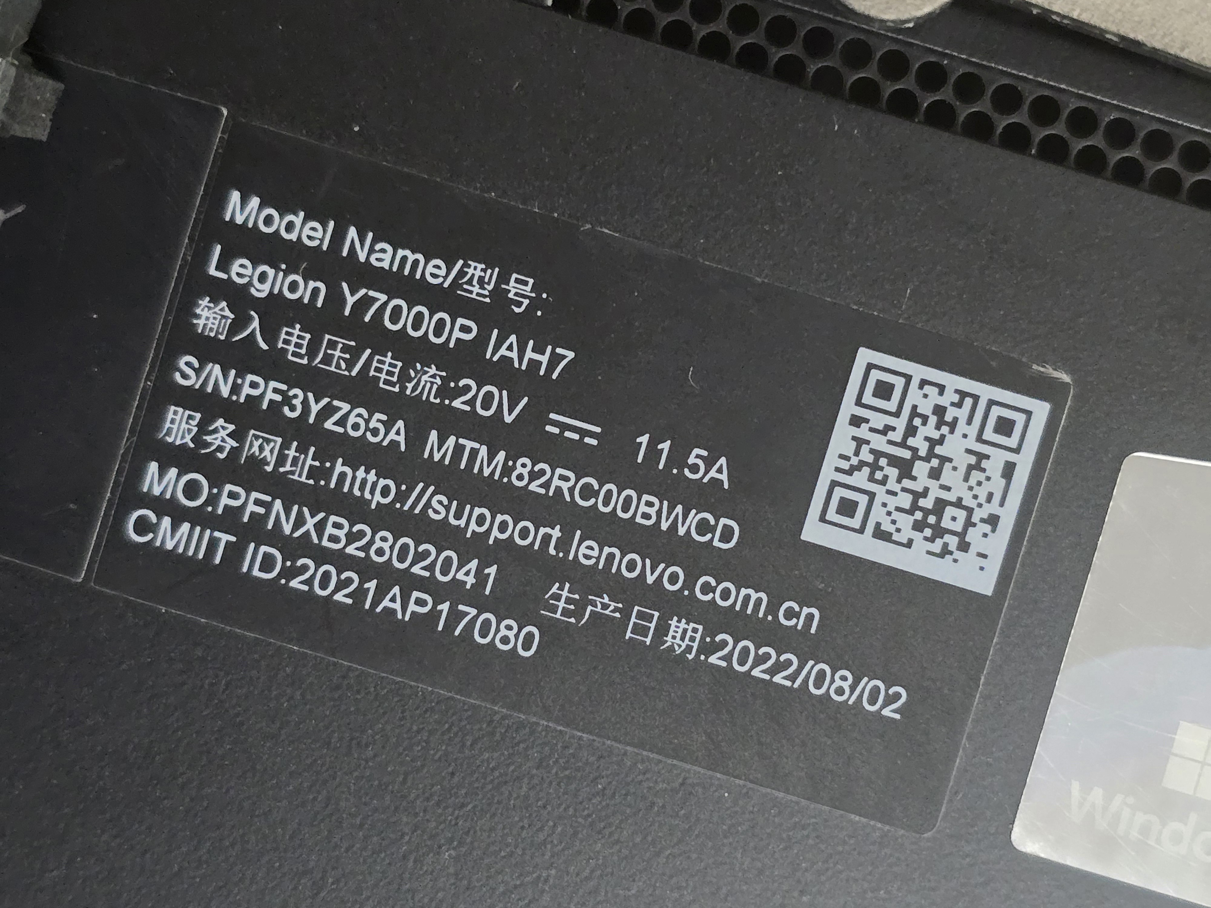

      Oh, I think I forgot the serial number. Sorry!
      S/N: PF3YZ65A
      Full board name: jy572 jy573 jy673 NM-E241 Rev:1.0

        Mirenia attach full pics model number, serial number
        • Mirenia
          • Jan 2024
          • 53
          Here are the pictures

            Mirenia hi try this bioss and tell me if work ,,,
            • Mirenia
              • Jan 2024
              • 53
              Thanks a lot!
              But unfortunately the error persists... only charging led and power led lights up.
              No fans, nothing. Testet with and without main battery and with and without cmos battery.
              But I feel that the heatsinks and the area where the battery is plugged in on the board are getting warm

                Originally posted by Mirenia
                Thanks a lot!
                Bios extracted from Lenovo site update for Legion 5 Pro 16IAH7, Legion 5 Pro 16IAH7H, Legion 5 15IAH7, Legion 5 15IAH7H
                DMI 31E000 - 31FFFF
                • Mirenia
                  • Jan 2024
                  • 53
                  Thanks a lot!!!!
                  I just wanted to try this version, but unfortunately while desoldering one leg is broken off of one chip...
                  Now I have to order a replacement (as a private person this seems really difficult... I don't want to order 2000 pieces at once )
                  As soon as I got the new chip, I'll try it again
