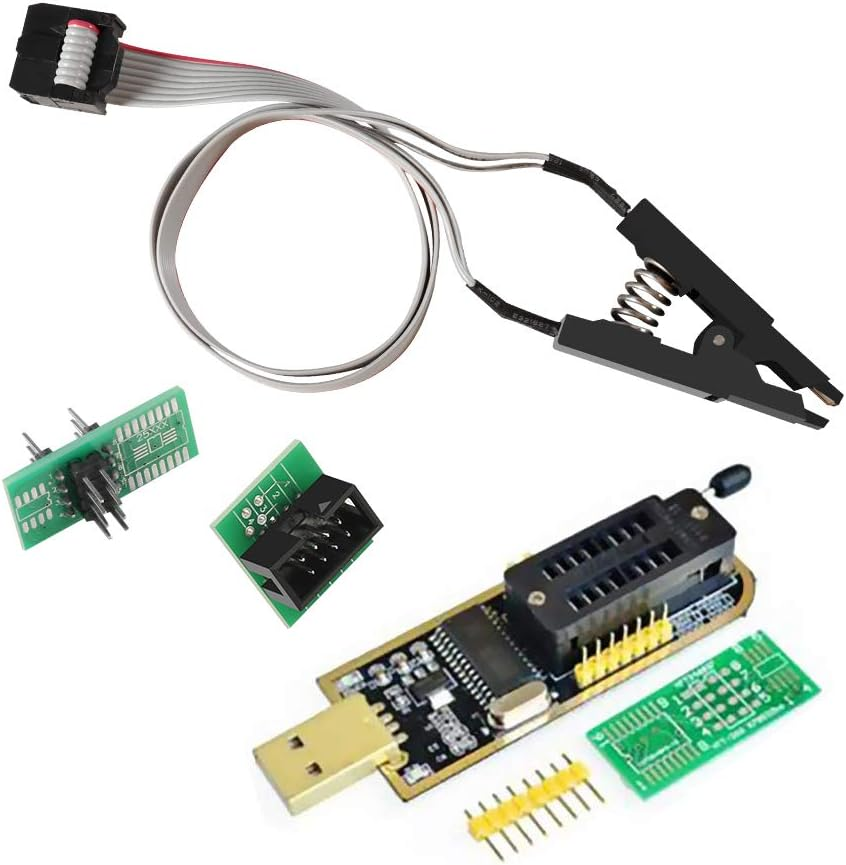

          In case anyone is following from home, I just ordered this clip-on programmer: https://www.amazon.com/dp/B07R5LPTYM
