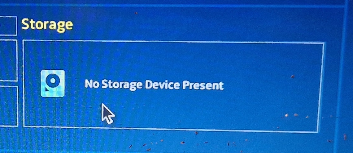

ASUS F515Ea No Image
  • botswanabub8
    • Oct 2024
    • 8
    • couty
    not sure if your kidding or am I writing such wrong?

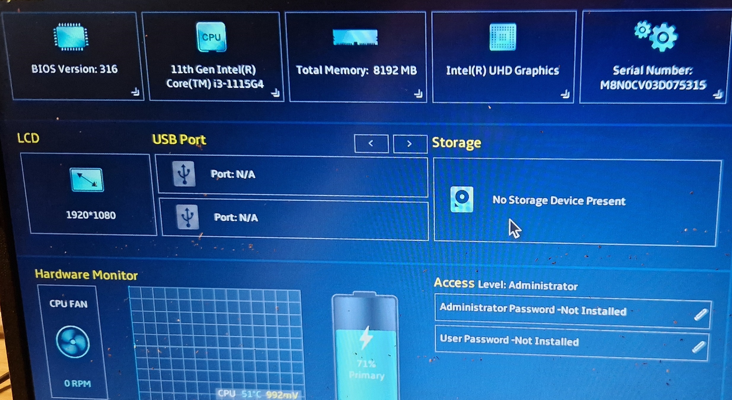

    I rewrote the IC and the laptop is starting but the HDD is not detected if it's connected by the pci-e/m.2 conector.
    Another HDD connected by the extra Port via SATA is detected. The m.2 is working as I asked me it could be a software problem?

      post bios dumb

      • botswanabub8
        • Oct 2024
        • 8
        • couty
        hi shiyab
        didnt find time to look at my dump?
        or can't help me?
        thanks for a response.

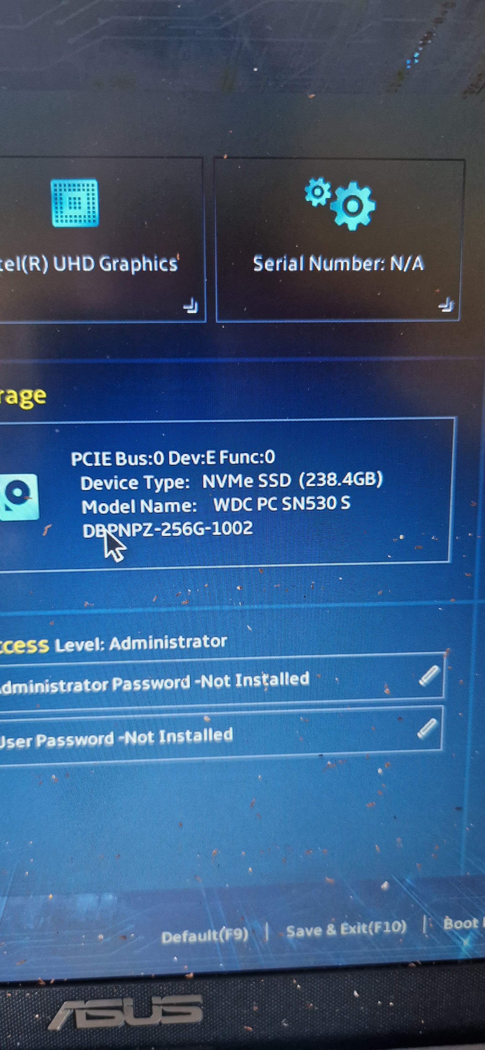

          sorry
          ok wait

            hi try this file
            • botswanabub8
              • Oct 2024
              • 8
              • couty
              works ... wow. whats the difference?
              no I serial now, thats normal?

                NVME OK

                  #29
                  seems working ... windows is starting fine

                    Your bios + DMI (serial number etc)
