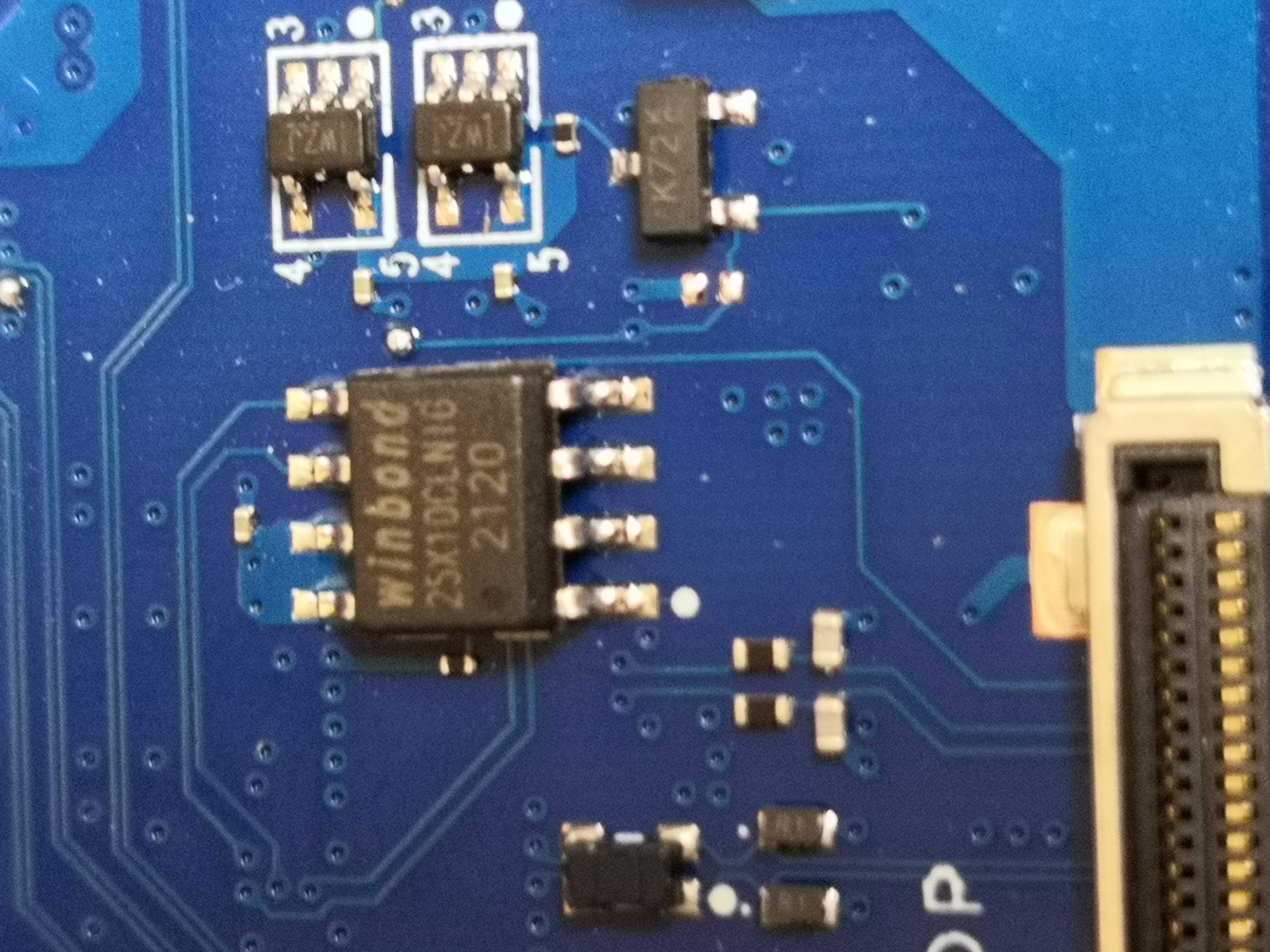

      now I'm trying to use the CH341A programmer. I've tried using TianoCompress.exe , to get the bin file, but I think this is not correct. When reading through the programmer, FF is everywhere.
      Chip: Winbond 25x10clnig
      when I try to turn on the laptop, it turns on and off several times.
      The screen does not light up
      model: celsius h5511
      sn: R1Y00005
      pn: cp818608-01-ds

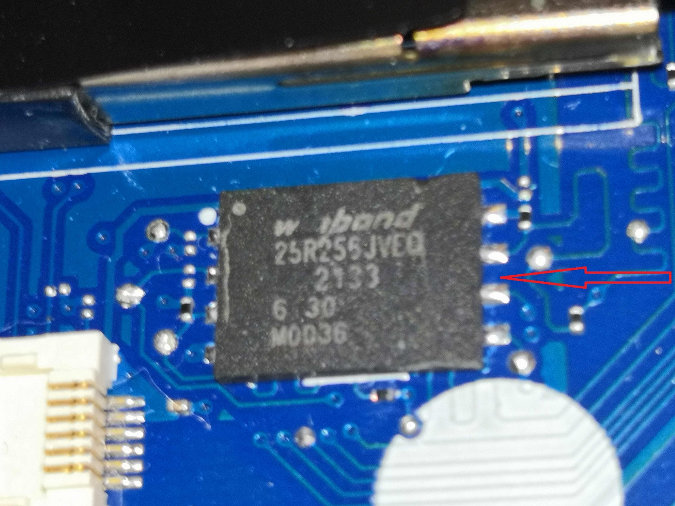

              I can't do this. there is no bios backup. when I read from the chip, everything is "ff ff" like a dummy. I tried to find the dump bios but all without success
              Click image for larger version  Name:	IMG_20240222_225624.jpg Views:	0 Size:	896.4 KB ID:	3222504Click image for larger version  Name:	IMG_20240222_224541.jpg Views:	0 Size:	799.6 KB ID:	3222505
              i read mxic but i think its not bios.
              windbond really look like dummy. soft for reading programmer ch341a-v1.34
                SMDFlea commented
                Editing a comment
                Use NeoProgrammer software

                Its not bios, your bios must be 32 MB

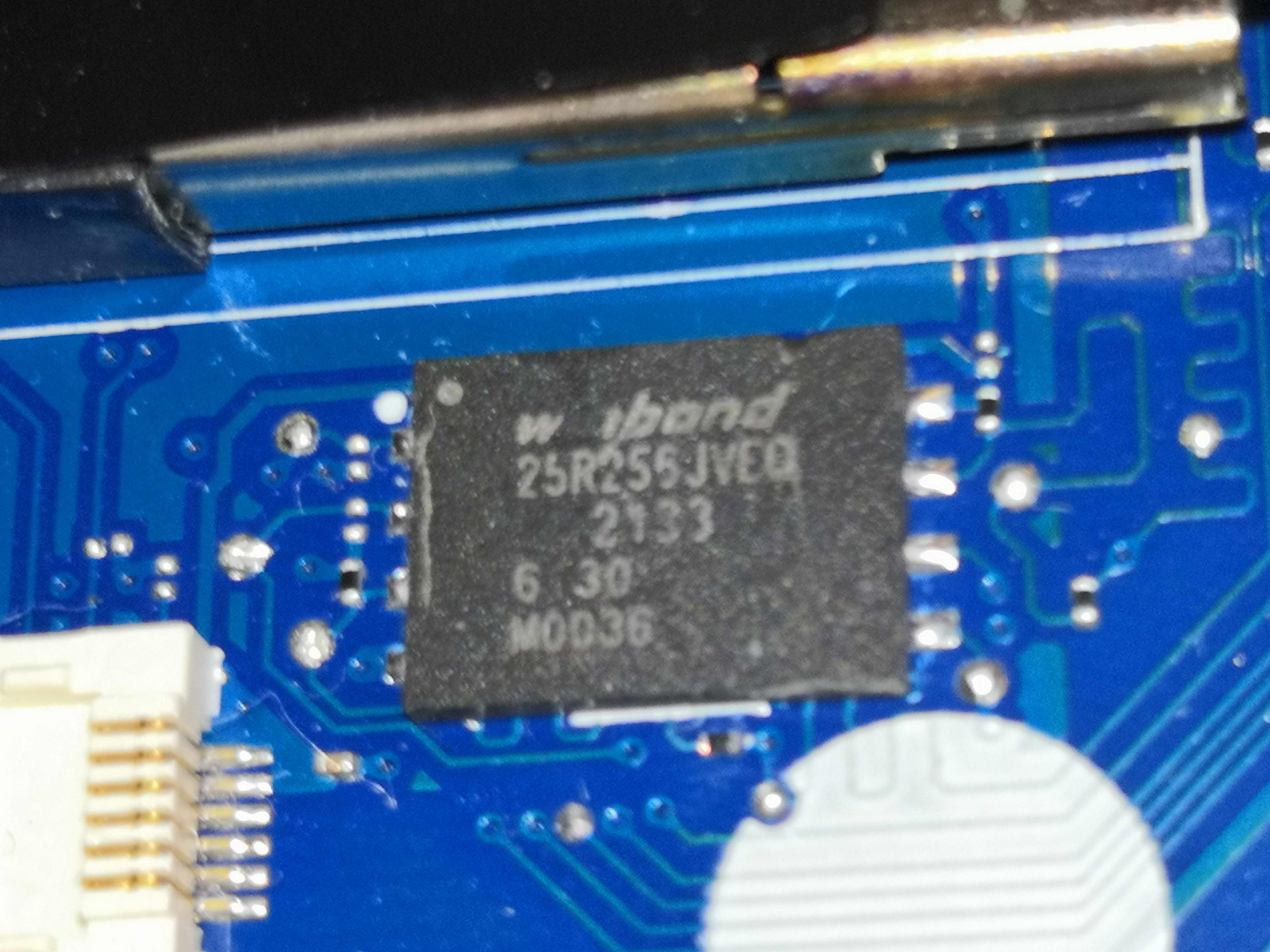

                  Click image for larger version  Name:	IMG_20240225_105532.jpg Views:	0 Size:	744.2 KB ID:	3223081or Click image for larger version

                    Originally posted by Johnny Jk

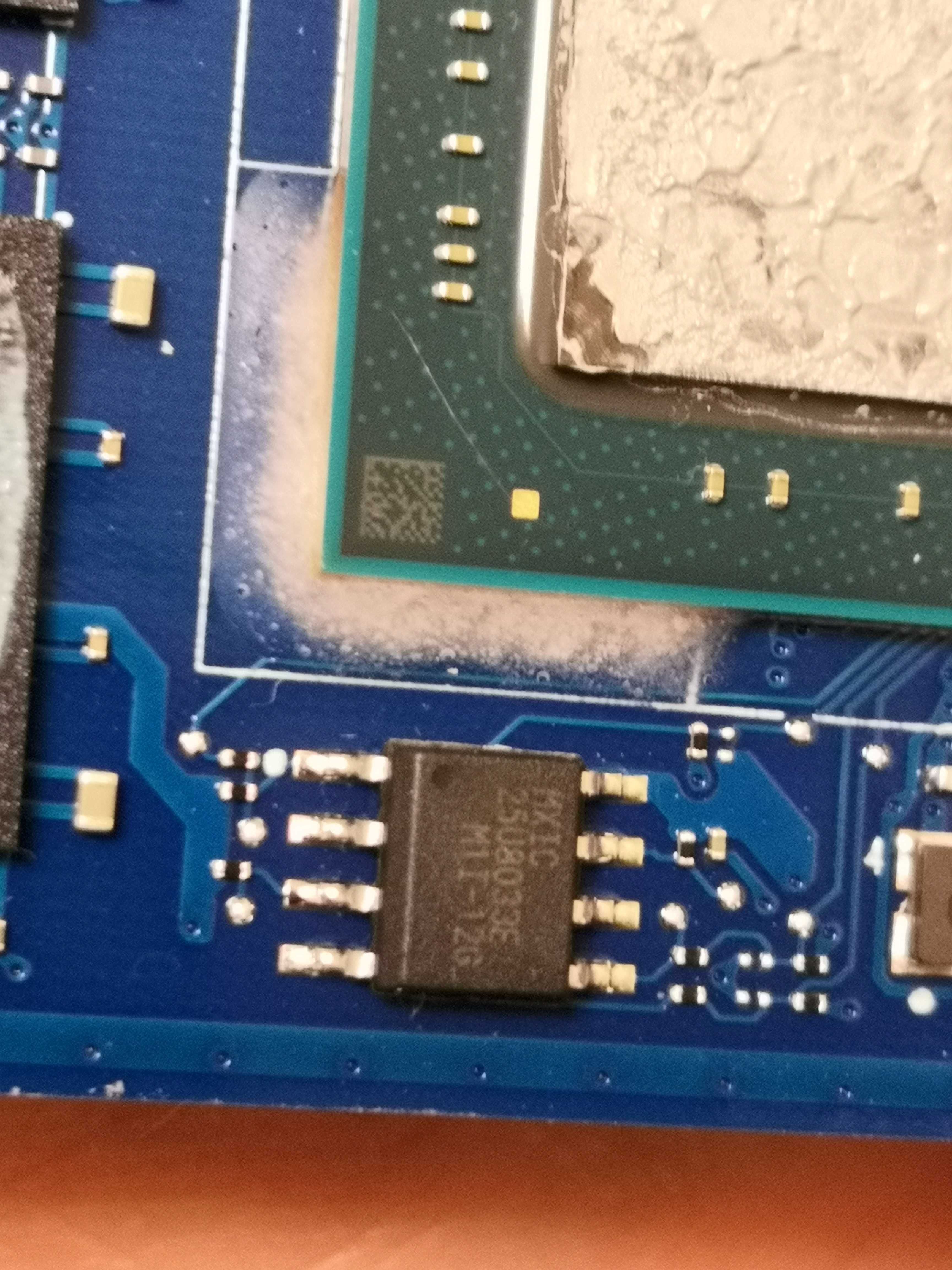

                          Are you sure it's not a bios?
                          • Vesko356
                            Vesko356 commented
                            Editing a comment
                            Am I sure? Are you kidding?
                            Yes I'm sure. MX25U8033E is 8Mb/1MB flash memory chip. Google it.

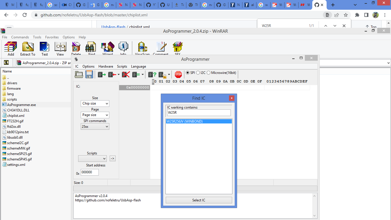

                          It is Bios chip , try with AsProgrammer 2.0.4 ( https://github.com/nofeletru/UsbAsp-...ses/tag/v2.0.4 ) , If you can't read the chip, you will can't to write it well !!
                          • Johnny Jk
                            • 13
                            • Punta Cana
                            succes dump, but again all 'FF FF'
                            Click image for larger version  Name:	image.png Views:	0 Size:	24.3 KB ID:	3223896
                            but now I can try to record the bios. there is enough space for a bios. the bios version weighs 29 MB
                            can I clear this bios to try to record the downloaded one?

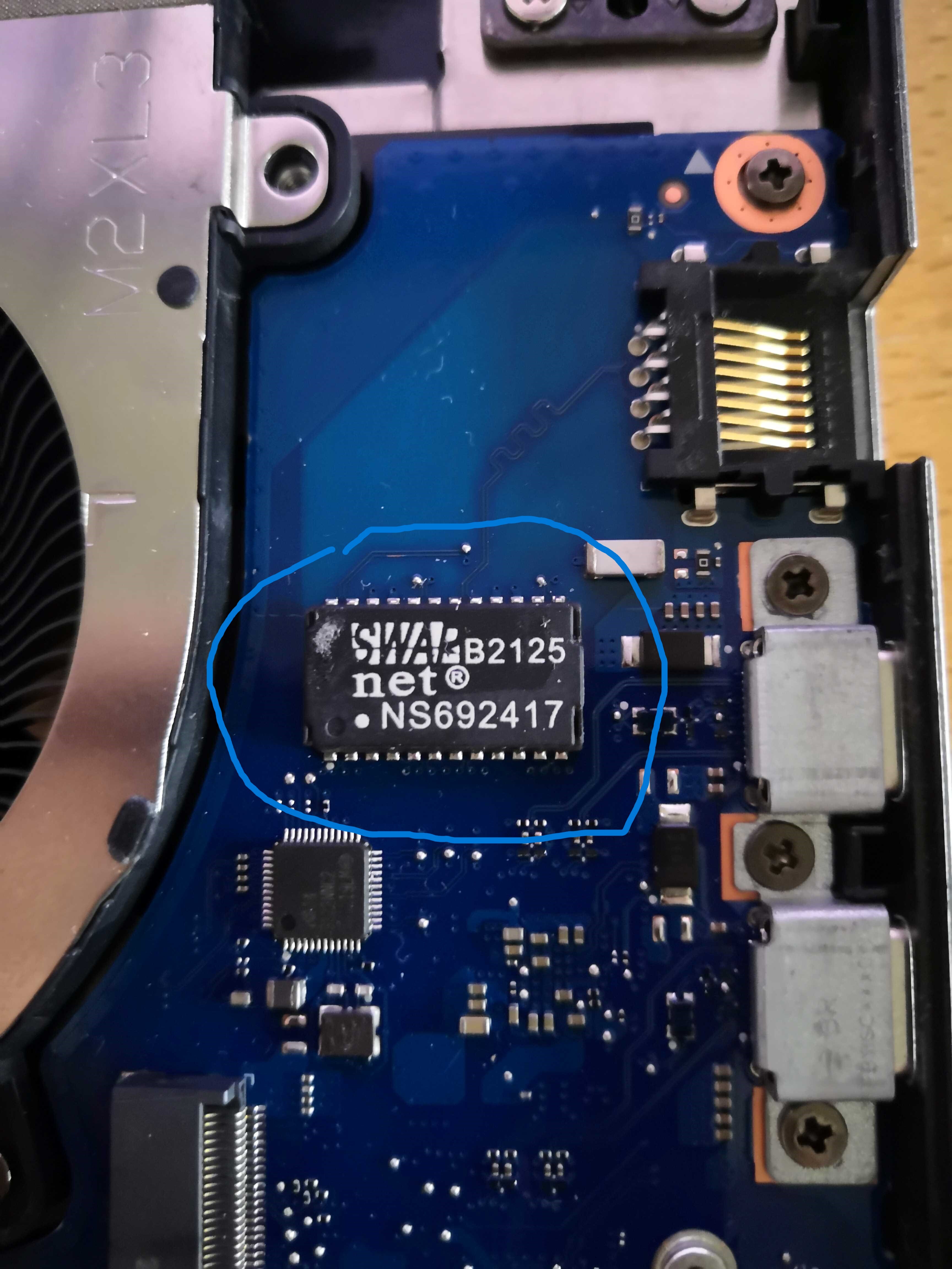

                              you are right. there are just a lot of chips on the board and all show "ff ff" and only one chip showed something similar to the data

                                how do I remove the protection from the chip?
                                I press the unprotect button, but nothing happens. The program switches to the removal mode, the green RUN light on the programmer lights up. So it hangs for an hour, but the progress bar is zero
