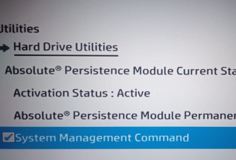

            help to remove computrace X360 G10 2IN 1
            sn 5CG3256J7N
            ID 85U53EC♯​ABE

                • jackx
                  • May 2020
                  • 222
                  • casa1
                  Originally posted by skazide
                  1-) Flash Patched File
                  2-) in First BOOT got to SETUP
                  3-) in MAIN Tab RESTORE Factory DEFAULTS
                  4-) SAVE and EXIT
                  5-) FLASH BACK Original Bios BIN File
                  when i return origine bios security actived
                  absolute module active

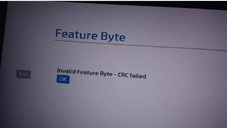

                            • jackx
                              • May 2020
                              • 222
                              • casa1
                              hello
                              i can entre
                              Feature Byte: 476J6S6b7B7H7M7R7W7m7saBaEapaqauawbVcAeMfPfXguhKhkj4jhk8mEmVn7nVngpDpVpWpnpqprqMqkqxqzr4.e3
                              same error
                              • minhdigital
                                • Nov 2022
                                • 765
                                • Vietnam
                                Originally posted by jackx
                                hello
                                i can entre
                                same error
                                Do you have a picture of error ??​
                                • jackx
                                  • May 2020
                                  • 222
                                  • casa1
                                  yes see photo
                                  • skazide
                                    • Jul 2015
                                    • 143
                                    • morocco
                                    yes see photo
                                    inject dmi to the one rex98 patched & to the one i patched first ..try
                                    • jackx
                                      • May 2020
                                      • 222
                                      • casa1
                                      J AI TESTER LES DUEX
                                      absotute persistance actived
                                      • skazide
                                        • Jul 2015
                                        • 143
                                        • morocco
                                        bro i dont understand you enter to setup thats mean the password not exist and if no error msg, its normal you can active or deactivate system managment
