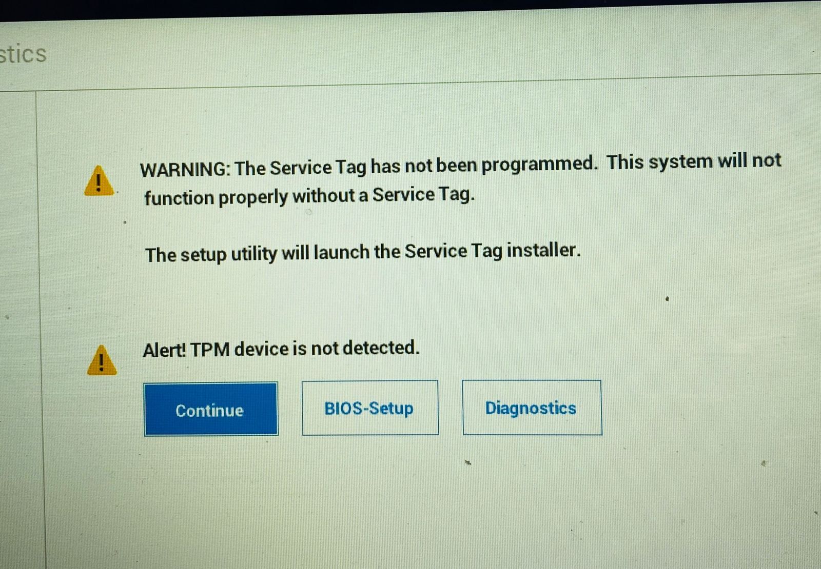

            TPM Error

                Same issue .
                TPM Device Not Detect .

                    STILL TPM

                      STILL TPM
                      Its a hardware issue, replace TPM chip
                        ok thanks for advance. Look like not bios issue

                              antman 14n adl uma mb 213102-1 No power ON ST: BP28LL3
                              Tried bios in post #8 and laptop turns ON but gived TPM not detected error. Attached original bios

                                  Thank you but still same error "TPM device is not detected".
