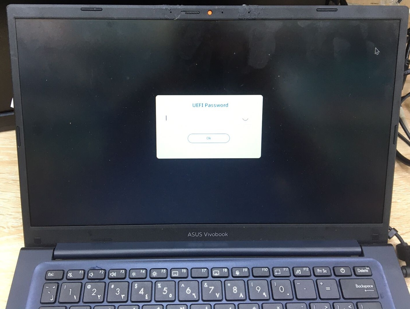

ASUS Vivobook 14 (X1404 X1404ZA) Bios Password locked
oh, sorry
ASUS Vivobook X1704ZA
S/N: R6N0CV09S38124E, main X1404ZA R2.2
Hello, help me remove the password from the BIOS and clean the ME region, thank you in advanceAttached FilesLeave a comment:
Leave a comment:
tryAttached FilesLeave a comment:
Hello. Please help me remove the password.. s/n R5N0LP039019216Attached FilesLeave a comment:
Attached FilesLeave a comment:
Hello I need help with unlocking the bios password for Asus X1404VA Main board x1404za R2.0 SN: R4N0LP008090148Attached FilesLeave a comment:
Hello i need unlock bios password for ASUS Vivobook 14 (X1404) Main board x1404za R2.2 SN: R9N0LP023563376Attached FilesLeave a comment:
Hello i need unlock bios password for ASUS Vivobook 14 (X1404) Main board x1404za R2.2 SN: R9N0LP023563376Leave a comment:
Hi friends, can you help me delete the password in the attached file?Attached FilesLeave a comment:
Hello i need unlock bios password for ASUS Vivobook 14 (X1404) Main board x1404za R2.2 SN: R7N0CV11M374295
Attached FilesLeave a comment:
ASUS Vivobook 14 (X1404 X1404ZA) Bios Password locked
Hello i need unlock bios password for ASUS Vivobook 14 (X1404) Main board x1404za R2.2 SN: R7N0CV11M374295
Attached FilesTags: None
This specification for the ASUS VivoBook X1404ZA-EB274W Notebook can be useful for upgrading or repairing a laptop that is not working. As a community we are working through our specifications to add valuable data like the X1404ZA-EB274W boardview and X1404ZA-EB274W schematic. Our users have donated over 1 million documents which are being added to the site. This page will be updated soon with additional information. Alternatively you can request additional help from our users directly on the relevant badcaps forum. Please note that we offer no warranties that any specification, datasheet, or...09-07-2024, 07:19 AM
This specification for the ASUS VivoBook X1404ZA-NK221X Notebook can be useful for upgrading or repairing a laptop that is not working. As a community we are working through our specifications to add valuable data like the X1404ZA-NK221X boardview and X1404ZA-NK221X schematic. Our users have donated over 1 million documents which are being added to the site. This page will be updated soon with additional information. Alternatively you can request additional help from our users directly on the relevant badcaps forum. Please note that we offer no warranties that any specification, datasheet, or...09-07-2024, 06:38 AM
This specification for the ASUS VivoBook ASUS VivoBook 15 S513 FHD i5 16GB/512GB G3 SSD Notebook can be useful for upgrading or repairing a laptop that is not working. As a community we are working through our specifications to add valuable data like the ASUS VivoBook 15 S513 FHD i5 16GB/512GB G3 SSD boardview and ASUS VivoBook 15 S513 FHD i5 16GB/512GB G3 SSD schematic. Our users have donated over 1 million documents which are being added to the site. This page will be updated soon with additional information. Alternatively you can request additional help from our users directly on the relevant...09-07-2024, 02:50 AM
This specification for the ASUS VivoBook Vivobook Pro 15 OLED D3500QC-L1351W Notebook can be useful for upgrading or repairing a laptop that is not working. As a community we are working through our specifications to add valuable data like the Vivobook Pro 15 OLED D3500QC-L1351W boardview and Vivobook Pro 15 OLED D3500QC-L1351W schematic. Our users have donated over 1 million documents which are being added to the site. This page will be updated soon with additional information. Alternatively you can request additional help from our users directly on the relevant badcaps forum. Please note that...09-07-2024, 04:30 AM
This specification for the ASUS VivoBook VivoBook 14 Notebook can be useful for upgrading or repairing a laptop that is not working. As a community we are working through our specifications to add valuable data like the VivoBook 14 boardview and VivoBook 14 schematic. Our users have donated over 1 million documents which are being added to the site. This page will be updated soon with additional information. Alternatively you can request additional help from our users directly on the relevant badcaps forum. Please note that we offer no warranties that any specification, datasheet, or download...09-07-2024, 04:10 AM
- Loading...
- No more items.
Leave a comment:
