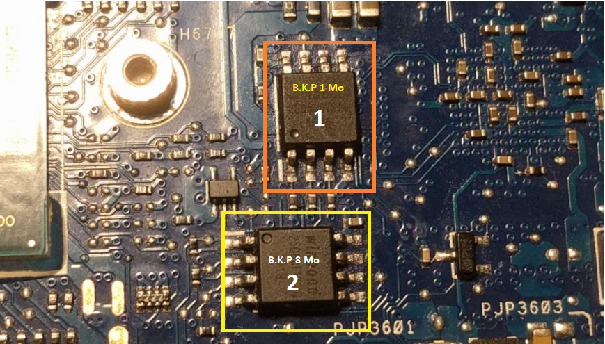

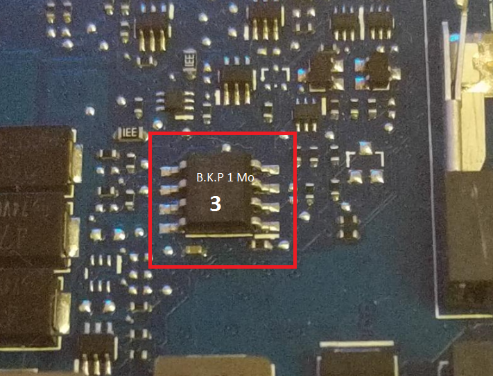

    Hi everyone
    clear password Asus Rog gl702vm rev 2.0
    i did reprogramme BKP 1 & BKP 2 severel times without result password on
    i think it's on BKP 3 pls someone help me

    Re: clear password Asus Rog gl702vm rev 2.0
    Originally posted by karim011
    Hi everyone
    is on BKP 2
    password 3214
        Think u so muchhhhhhhhhhhhhhhhh PRO.
        it's working
