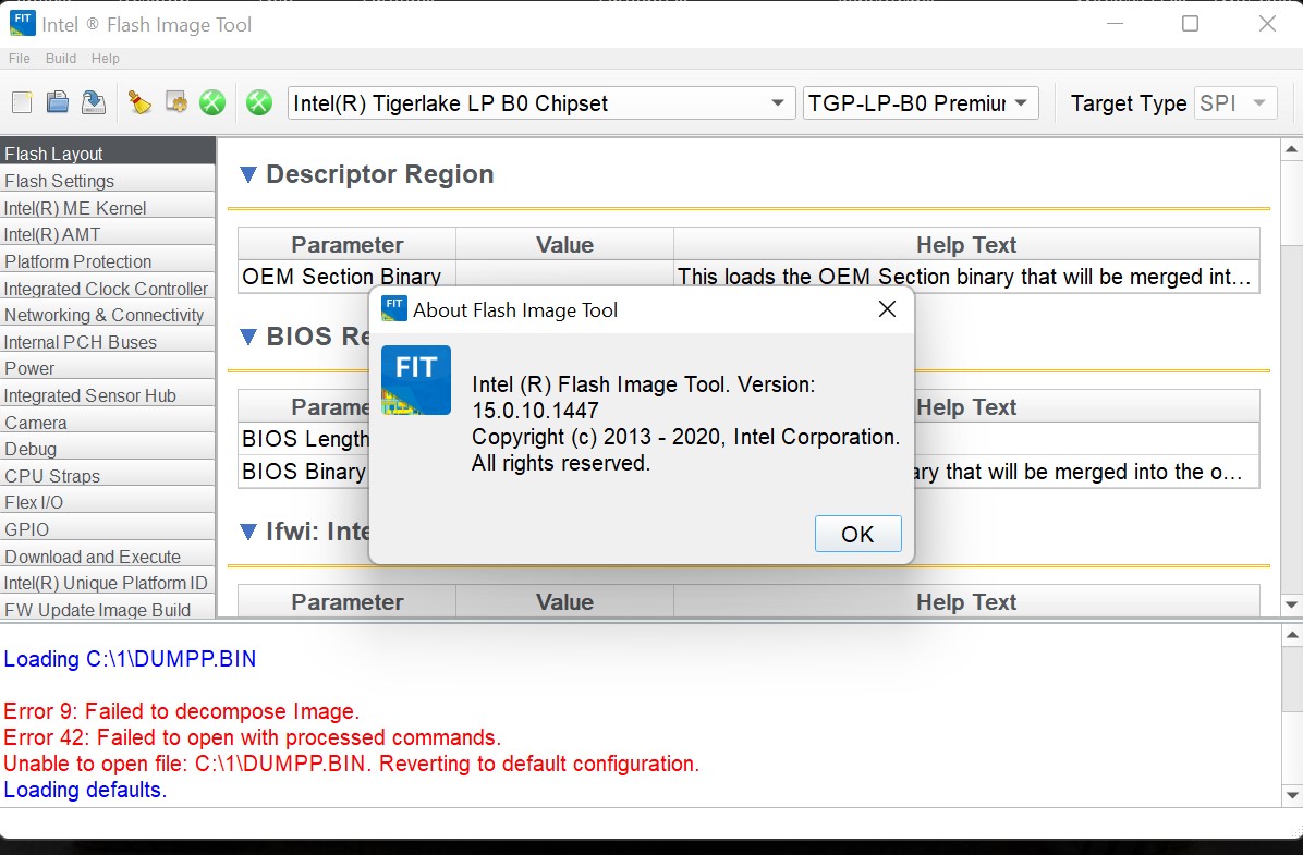

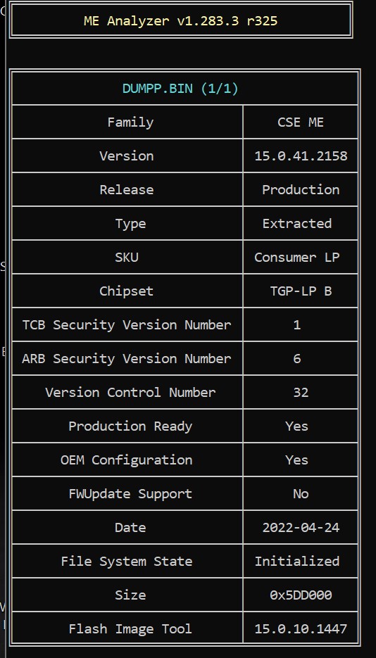

                              Hello . I am also having the same problem. did you solve it?. Can you send me the bios file that runs normally but reports the service tag?
                              • Bios White
                                Learn
                                • Dec 2024
                                • 88
                                • East Laos
                                Motherboard is: MKB-V TGL 8L MB 19862-1
                                Service TAG : 2F6Z2B3
                                I don't have a dump, I downloaded the Bios from many forums but all of them cannot save the service tag. Hope someone can help me fix it. The attached file I downloaded from #6 of minhdigital

                                    Originally posted by qayyum786
                                    Again
                                    Service Tag ok, choose Model ok BUT not install SSD , please build BIOS qayyum786, minhdigital hoaca388
