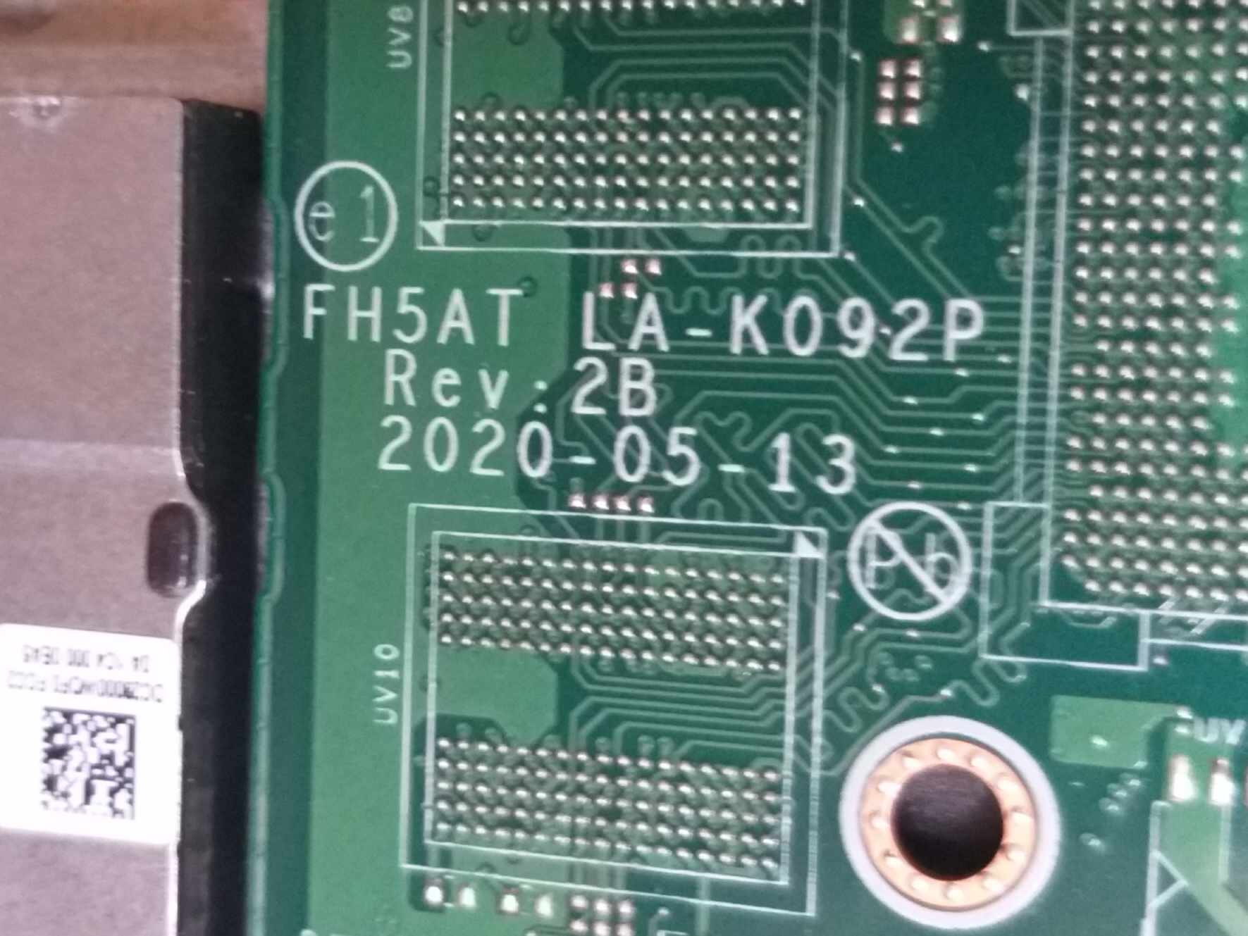

    Hi sir after i flash my laptop black screen issue was fix, but stock on Acer logo sometimes "blue screen of death" appear..
    i already test the ssd and no problem found..
    plz help me to clean my old bin file or if you have same bin model can you send to me..
    thanks in advance sir...

    Acer Aspire AV15-51, Part Number NX.AYCSP.003
    Virgin bios version 1.03 (same as in your dump to avoid any incompatibility issues), DMI and Windows key transferred:

      thanks sir.. i already flash bin file. but same issue didnt fix still in acer logo.

        Means your problem is not bios related, most probably SIO issues or some other hardware failure.

          master I need ene kb9052qd bin file. for this same model more thanks 🙏
            • 21948
            Copy it from your bios backup or the bios posted above with a hex editor , offsets 548000 - 567FFF
