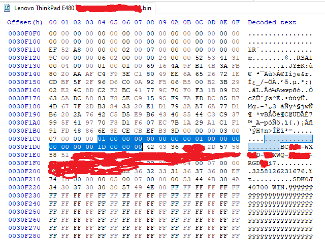

    does clearing password affect windows product key activation?
    if so can how can i correct it?
    im unable to activate windows10pro, it says the product key can no longer be used

          thinkpad e480 - i backedup image from chip, patched it from the thread :lenovo-thinkpad autopatcherclear sp- and wrote it back
          now in the bios menu under restore factory keys it states windows 8, when it used to say windows 10
          now i have problem activating thru control panel and calling on phone, it says key can no longer be used

            If you don't want to upload your BIOS to keep your Windows Key save, you can open both files (before and after the patching) and search for this Hex Value and see if your Windows Key is there or not.
            010000000000000001000000000000001d000000

                    i searched the images for the value, but it did not find a match, where does that lead me?
                    • hardware1
                      • Sep 2021
                      • 2946
                      • N/A
                      Re: thinkpad eseries question
                      If you can't find it as the image, so there's no OEM Windows Key in your BIOS.

                        Here E480 bios with clean me
                        you can add your own winkey
                        hex 010000000000000001000000000000001D000000
                        winkey 003F1D0-003F1F0

                          hey guys after all i was using the search wrong, im new to this
                          i found my product key in both the original and the patched, its the same product key that came with me windows edition, but its not activating, it gives me 0xC004C060, then it says key can no longer be used, then it says to contact third party seller or manufacturer

                            I think if you reinstall the OS and after connecting the device to the Internet the Windows will activate itself.
