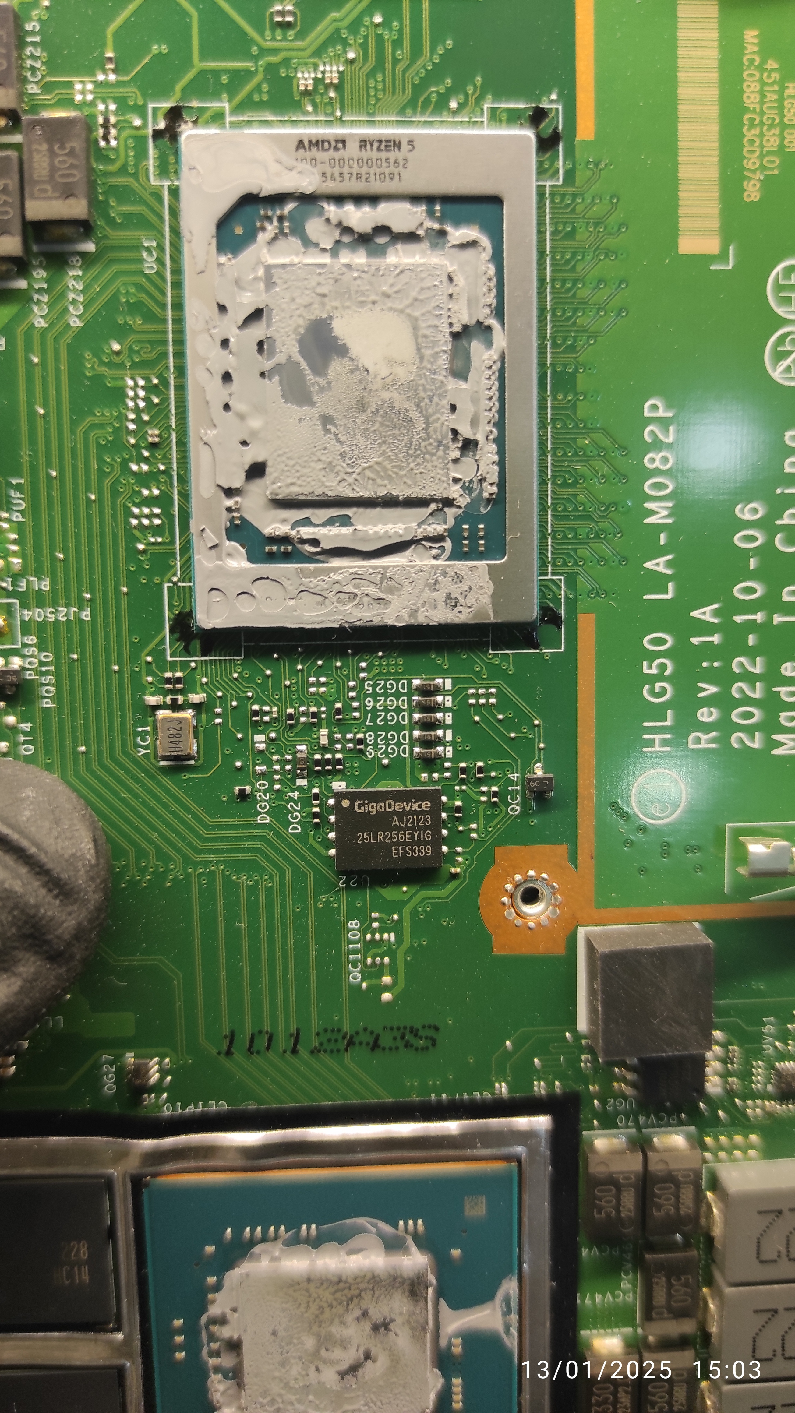

    Hello, friends ! I have laptop
    Lenovo IdeaPad Gaming 3 16ARH7
    HLG50 LA-M082P Rev: 1A (2022-10-06)
    AMD Ryzen 5 6600H with Radeon Graphics
    S/N: MP2DDY18
    Is this chip main BIOS chip: GigaDevice 25LR256EYIG ?
    Picture attached. Many thanks in advance for answers!​
    • osman68i
      • May 2015
      • 339
      • The Netherlands
      yes 25LR256EYIG is 32mb 1.8v
