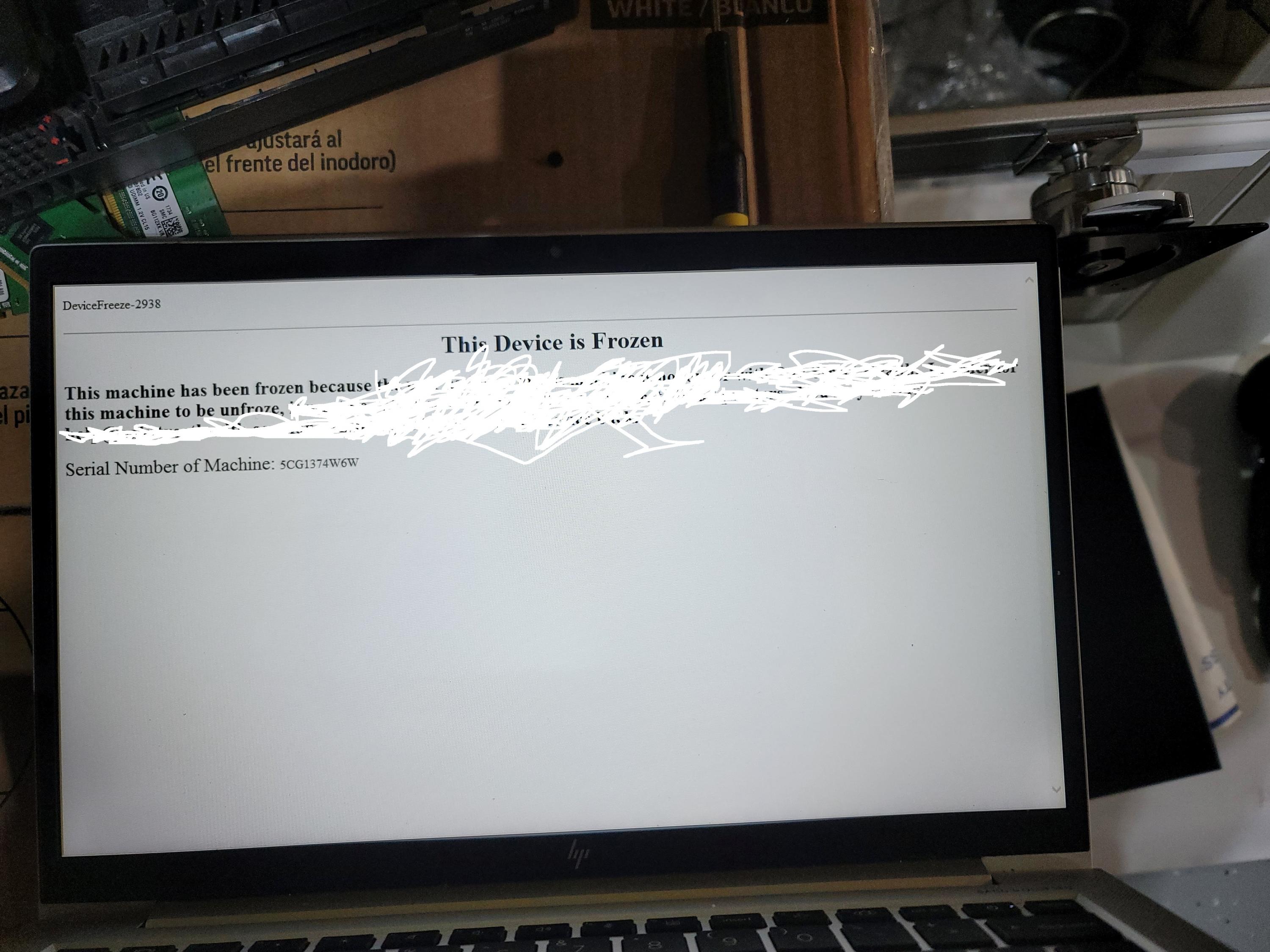

    I got this strange laptop that I am trying to fix. It has some kind of OS lock by some one. When I install windows on it, it does install windows but after few minutes it gets locked by a message. You can not do anything. Bios is very clear and no password.
    Does anyone know I can fix this either by flashing the bios or changing something in the bios.
    Please help.

              Post the full laptop model number and a picture of the lock message
                Re: HEWLETT PACKARD AX201NGW bios issue
                picture attached for all the details.

                  According to your Serial Number (5CG1374W6W), your device Model is (HP EliteBook 830 G8). I can't see what is written after "frozen because the ..", but anyway we will need your BIOS Backup to help you.
                  Your device should contains 2 BIOS Chips (Main & EC), the 2 Chips could be 32M or (32MB & 16MB) WSON/SOIC Package.
                  Read that post to know how to do that:
                  https://www.badcaps.net/forum/showpo...40&postcount=2
