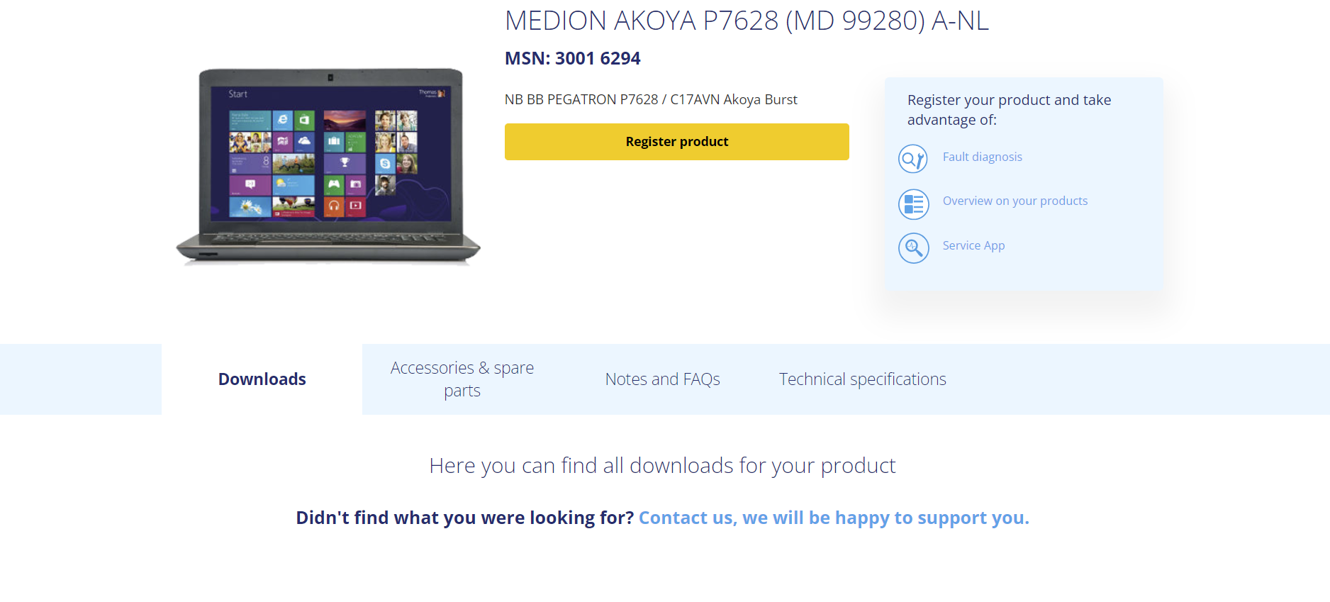

      Re: Wanting latest BIOS for Medion Akoya P7628 / MD99280
      That is not quite true.
      I mailed to Medion support about "missing" BIOS downloads and they replied that it is company policy to NOT make BIOSes downloadable straight away, but only if the requester can supply:
      - the receipt of the original buyer of the laptop
      - the serial#
      Since I receive older laptops from quite a few people, I don't know from which person I even got this laptop, so, no receipt, and thus no BIOS
      Never ever I encountered such a weird policy around BIOS downloads.
