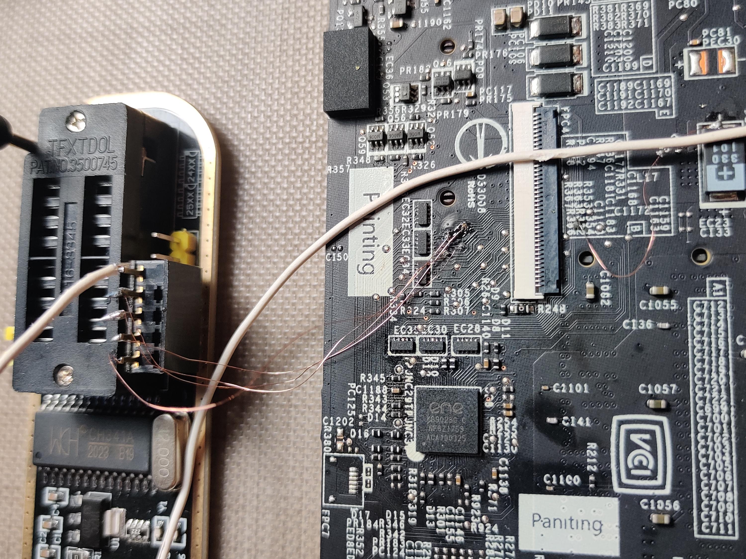

    Hi, Thanks for sharing this. I have a GE66 10sf that had a blown EC controller. I've replaced the controller and connected a CH341 programmer to the pins as listed in your message. Unfortunately the programmer can't detect the EC controller as an EPROM. Was there a particular order in which you powered things up? When you had to retry the programming what error was it giving for you?

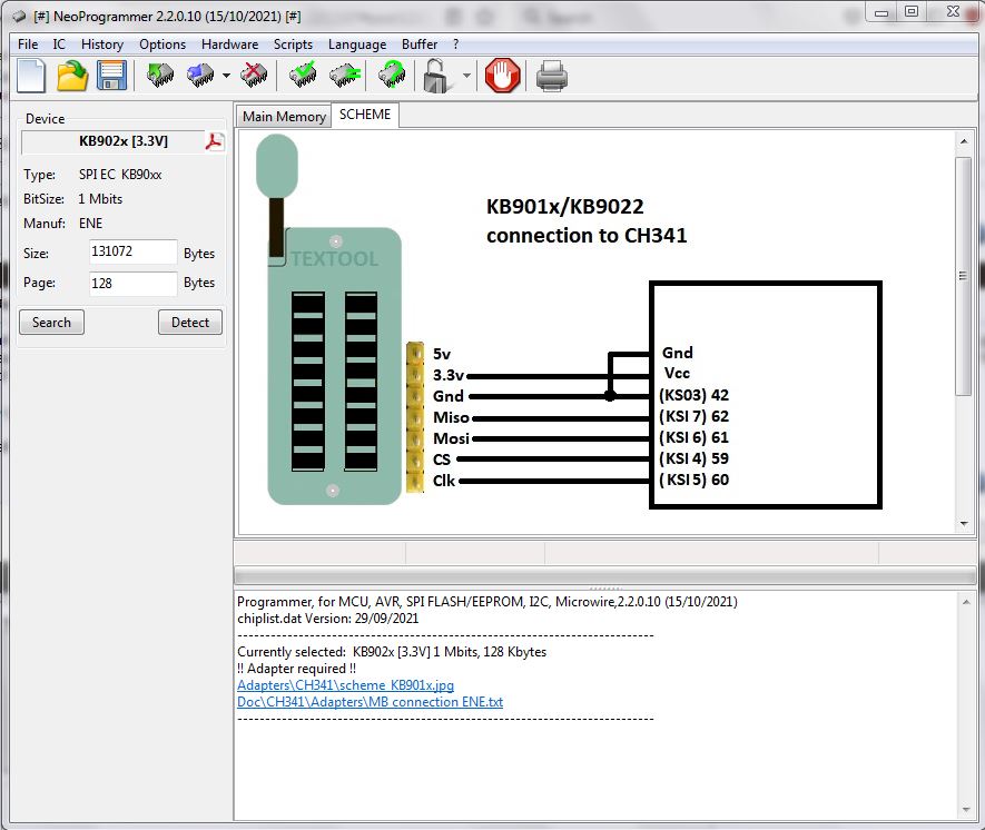

      Where did you attach the pins to the programmer. NeoProgrammer,an alternative software version for the CH341A supports a few KB9xxx chips

        Please see the photo. It's not very clear but the pins are connected as you listed them in the first post.
        I'm wondering about the 3.3v.. With out KSO3 connected to ground, when powering up the motherboard a red light flashes and the 3.3v and 5v rails come up for a few milliseconds and then reset. They do that in time with the red light flashing. WITH KSO3 connected to ground both 3.3v and 5v are low. So where does the EC chip get it's supply voltage from in programming mode?

                Okay. So I removed the KB9028g chip and traced the pins. They are different to the pins given in the first post. Maybe a different version of the motherboard. The one I'm working on is version 001 I think. Part of the number is covered by the CPU support bracket so I can't see it clearly. Anyway, these are the absolute pin numbers for programming the KB9028g on this board:
                KS03 - 37 - Connect to gound on MB, which also needs connecting to GND on the programmer.
                KSI4 - 28 - CS
                KSI5 - 27 - CLK
                KSI6 - 26 - MOSI/DI
                KSI7 - 25 - MISO/DO
                Pin 1 is nearest the KB IC on FPC4
                There are a couple of test point near the KB IC that are easier to solder onto, although not for the CS pin.
                A few things to note if you're using a CH341a based programmer and NeoProgrammer.
                - In NeoProgrammer check the auto detect of the ENE chips is enable. It was disabled by default on my install, so the IC wasn't detected.
                - The CH341a Black programmer I used has the 3.3v fix applied(Google it). Possibly not an issue.
                - Seems best to power the board first then connect the programmer to the host computer. So the IO lines aren't higher than Vcc. The KB IC gets 3.3v from PU1's 3.3v LDO no external power is needed.
                Unfortunately after successfully reprogramming the chip the laptop only powers on to a black screen. It charges, and the keyboard and front light work. The CPU and GPU warm up, only the CPU fan spins. Possibly damaged the KB chip while reballing it..

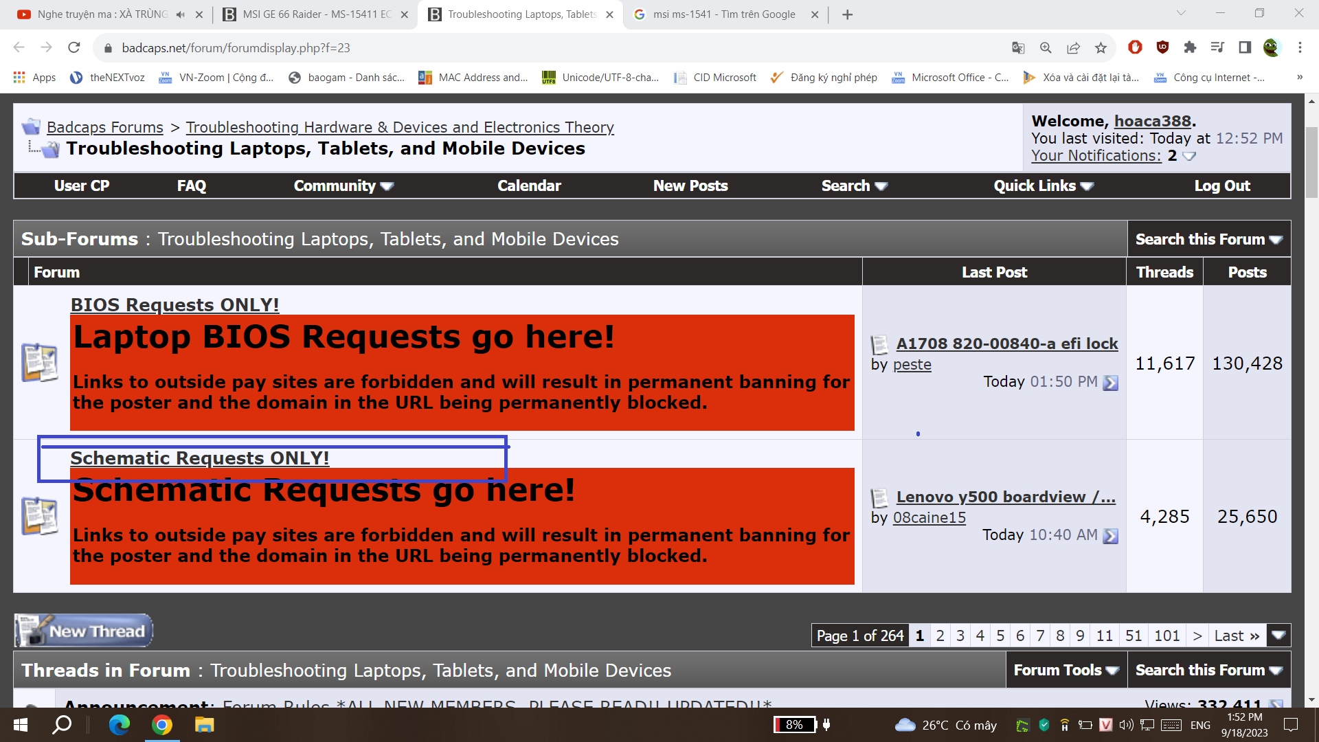

                  hi, i´m new to this site, i´m looking for the msi ms-1541 boardview, but anywhere i look, seems that every boardview is a scam, do you have any safe place where i can find it?
                  • hoaca388
                    Badcaps
                    • Jan 2022
                    • 12268
                    Re: MSI GE 66 Raider - MS-15411 EC ROM
                    https://www.badcaps.net/forum/forumdisplay.php?f=41

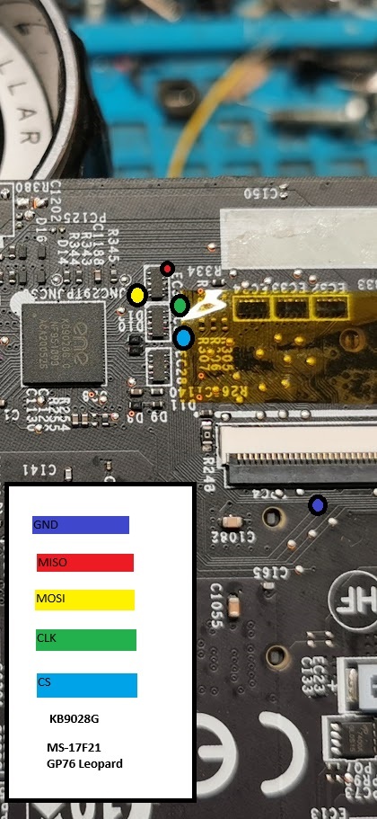

                      I had the same issue, MS-17F21, I thin is the same board.
                      Neo programmer is the easy way. RT809 had it in list but not recognized.
                      EC firmware for every MSI is on the support.
                      I attach below working and easy pinout.
