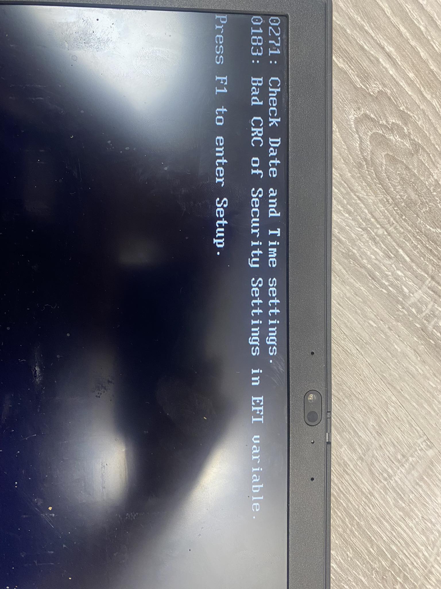

                        • piszpunta
                          • Jan 2019
                          • 253
                          • poland
                          Re: LENOVO Thinkpad L14 Gen 2 HL4A0 HL5A0 NM-D271 REV 1.0
                          Please repair bios becouse no power

                              • piszpunta
                                • Jan 2019
                                • 253
                                • poland
                                I was able to read
                                sn: PF2NK8TE
                                  Here's your New BIOS, try it and let me know.

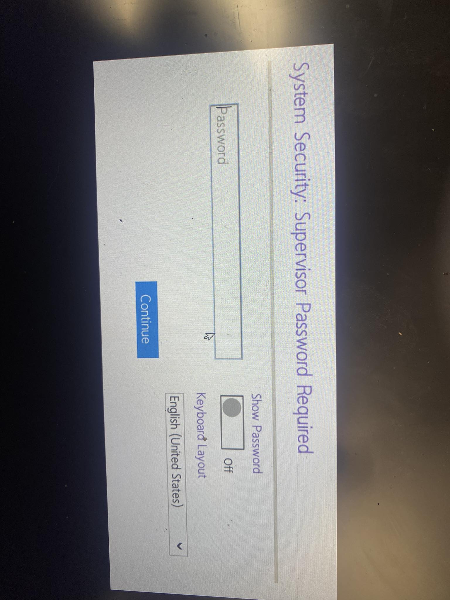

                                    Laptop is alive but..........
                                    • hardware1
                                      • Sep 2021
                                      • 2946
                                      • N/A
                                      Supervisor Password is stored inside the SIO chip not in BIOS chip. Ask the Owner for the Password or you will need to re-flash the EC chip (SIO) using a proper Programmer (if the chip is Programmable).
